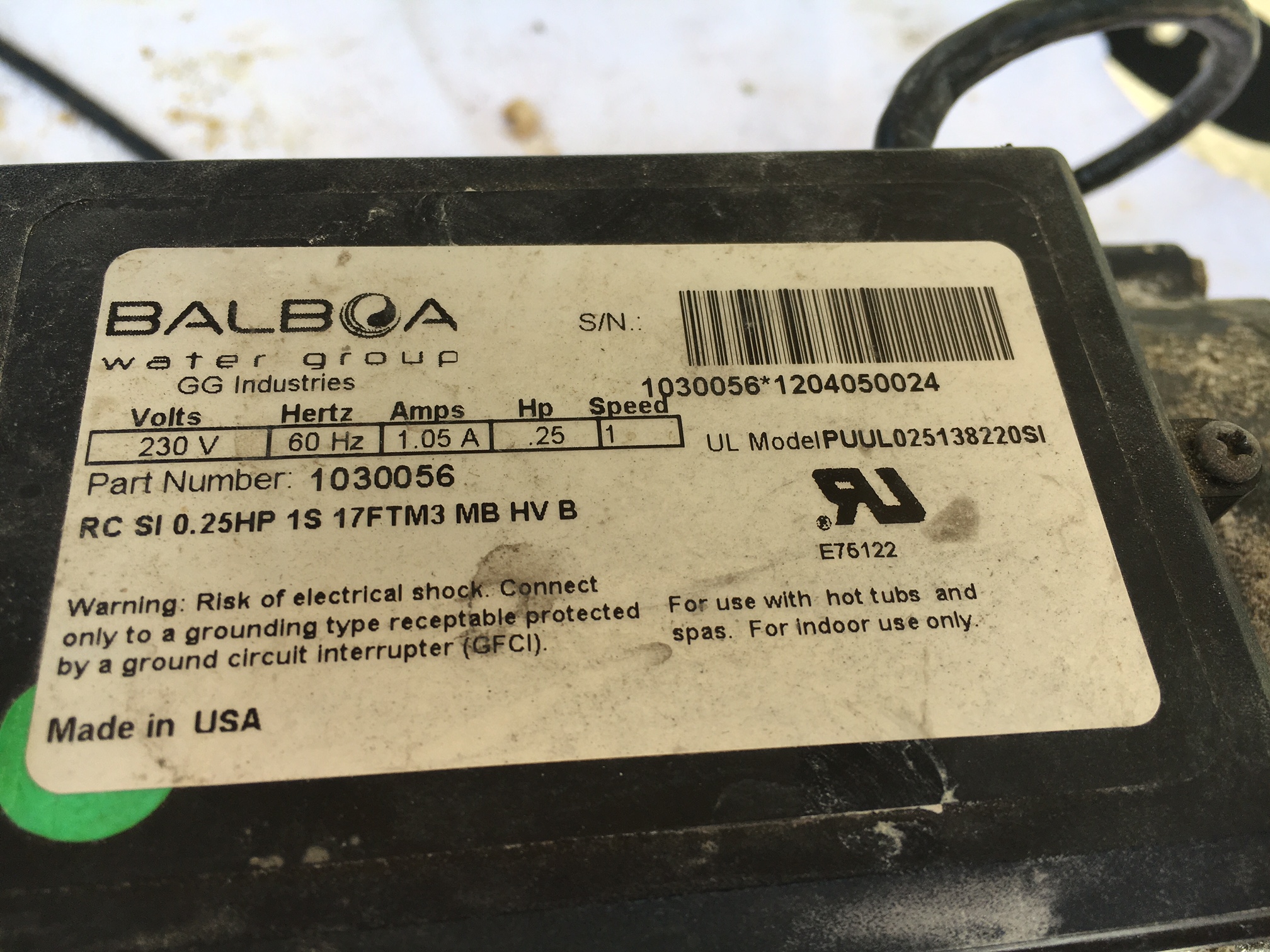

Thanks Minder. It's actually a 230vac pump. Digikey seems to be a very comprehensive website! I must be horrible at this because I can't figure out how to filter my search correctly to pull up the correct part. I am looking for a film capacitor correct?
EDIT: I found this one: https://www.digikey.com/product-detail/en/kemet/C276CC34800AA0J/399-13855-ND/6558683
Does it look correct?
Below is a pic from the box on top of the pump.
-cheers
Scott

Minder
Apr 24, 2015
3,560
Apr 24, 2015
3,560
6 or 6.3 is close enough not to make that much difference.
We are not dealing with precise equipment here.
M.
