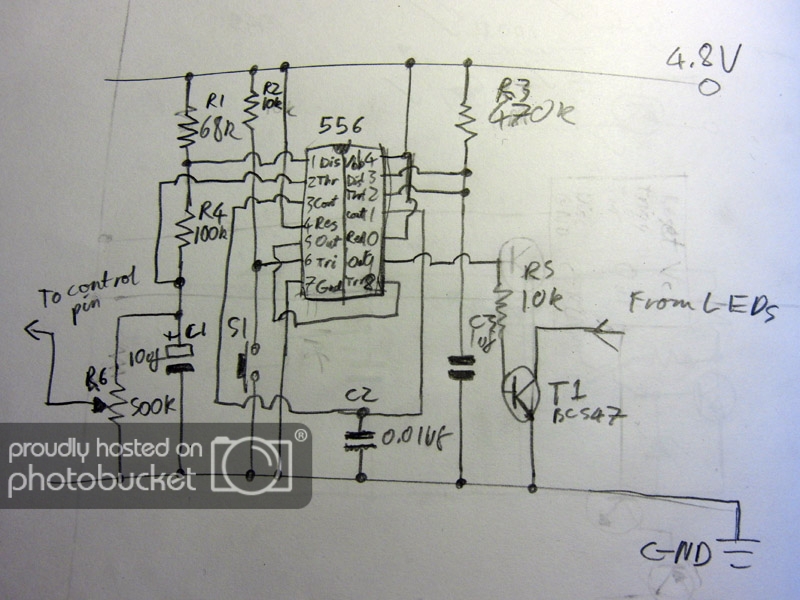

What isn't working fine is my attempts to utilise the control voltage pin.
This is what I cooked up for that. (Sorry, it's an even messier drawing than last time)
The right hand side is a fairly conventionally configured monostable, driving a NPN transistor that will be connected to a number of small LED clusters.
It's meant to be triggered by the falling clock pulse from the left hand side of the 556 and flash the LEDs for about 0.5 sec.
The left hand side is also monostable, although I used a RC layout closer to that of an astable configuration with R4, a 100k resistor, between the Discharge and Threshold pins because I wanted the capacitor to discharge more gradually.
This is because I'm trying to use the voltage in C1 to drive the control voltage pin of the astable 556 that's running the 4017s, via the 500k adjustable resistor R6. R6 is supposed to serve two roles - a voltage divider to allow control of the maximum voltage at the control pin, and also to reduce the rate at which C1 charges as it approaches the threshold voltage, thus resulting in more of the charge cycle being in the high end of the voltage range (making for a more pronounced effect on the LED chase speed).
This seemed simple enough - as the voltage in C1 will max out at the threshold voltage of the 556 I was trying to control (both 556s being controlled from the same battery pack), the control voltage it supplies should be proportionally correct even as the batteries discharge.
... nope. Even though Pin 1 (discharge) is at 0V to ground (when the monostable isn't triggered) and should be earthing C1 and Pin 2 (threshold), they're constantly hovering at 2.4V, briefly jumping to 3.2V when the monostable is triggered.
Pin 9 (Right output) is also constantly high, rather than only being briefly triggered by the falling clock pulse from Pin 5. It will turn off in the instant that Pin 5 (left output) goes high when it's triggered... but that's the only time it's off.
It is marginally possible that I've managed to cook the 556 (my first attempt at assembling the circuit failed to connect C1 and C3 to ground - D'oh!). I have a spare, but I'm not planning on plugging it in just to find out I've cooked that as well.
Should this circuit work for providing the control voltage, or have I screwed up mega style?

Internally the 555 has a voltage divider made of three 5k resistors.
The top is connected to Vcc, the bottom to ground, and the two taps used for the threshold voltages for the comparators. The control pin is connected to the uppermost tap on the voltage divider.
Because the impedance at this point is effectively around 3k3, your attempt to alter this voltage from a very high impedance source (the 500k pot) is doomed.
The voltage going to the control pin needs to come from a much lower impedance source.
RagnarokEOTW
Mar 23, 2015
6
Mar 23, 2015
6
Ah! Yes, I kept looking at the internal circuit diagram and thinking that the way the control voltage was delivered to the comparator didn't actually look like it could override the internal divider's voltage, but that just didn't twig.
Right, that explains a lot, I shall go away and rethink...
