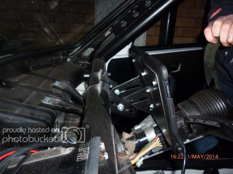

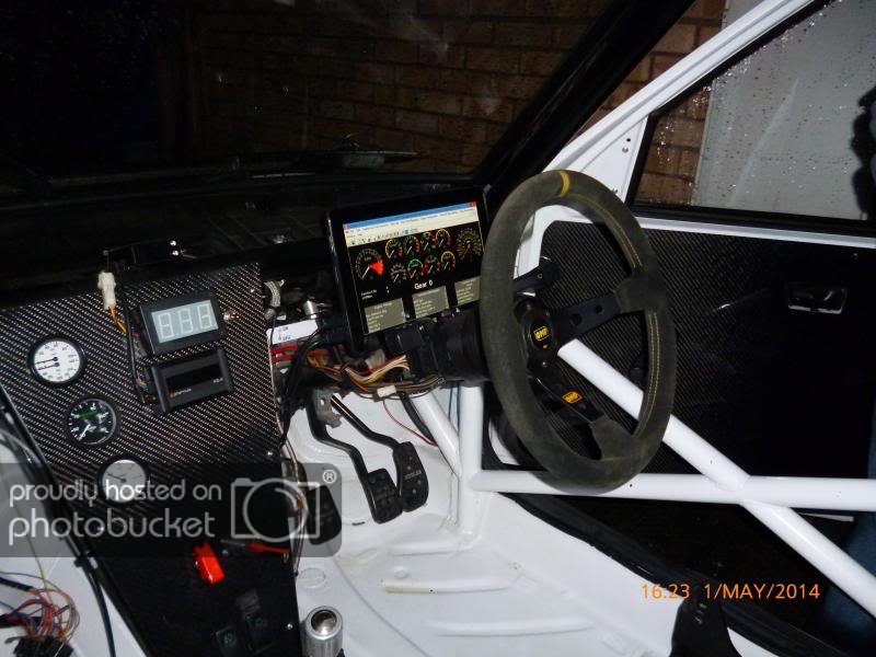

Those displays are nice but cost an arm and a leg, £1200 for the car dash, for that reason I bought a windows tablet (the very one I'm typing this on now) and mounted it in the car by making a holder with a protective case.
This allows me to display real time info and allows any real time alterations of the fuel, ignition, turbo boost, traction etc on the fly which is a real bonus as before it was a laptop on the passenger seat job.
The screen is surprisingly bright but l couldn't help thinking that an led shift light would finish the job off nicely (like on the £1200 dash), I could use the engine sound to change but as you can see l like toys.
