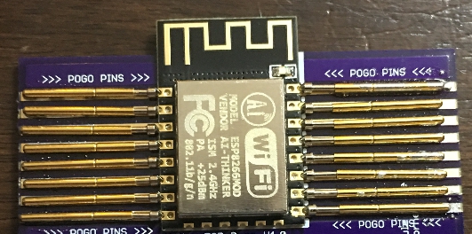

What I am looking to accomplish is taking this layout:
and connecting those pogo pins to the multiplex/demultiplexer/crossbar switch/cross point switch in order to allow for different pcb models that have different pin layouts in order to flash firmware to them using the FTDI.
Hopefully knowing that allows you to understand the overall design of what I am trying to do.

Still a little hazy on what you are doing: in the picture of the pogo-pin fixture I see a setup that only has ONE possible connection scheme.
Are you pre-programming ESP8266's and then placing them on various PCBs?
StealthRT
Sep 4, 2010
147
Sep 4, 2010
147
Yes sir.
