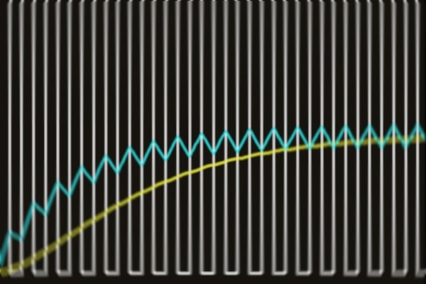

A simple method is to use a low pass filter on PWM output producing a V proportional
to PWM duty cycle, and feed that to a V to I converter. There is a latency associated
with this approach, how much time from a step change from 0 to 10 mA can you live
with ?
Output of filter then goes to V to I converter :
Note the above circuit needs a well regulated accurate Vcc so only variation in current is due to
sense R and Vref (Vinoput). Use a better opamp than a 741, a rail to rail type would work fine.\
There are other architectures, sinks, transistor-less versions (Howland).....search the web.
Regards, Dana.

What is the OpAmp supply V value ? Desired range of input V to OpAmp ?
Keep in mind Iload = Vinopamp / RS, so 10 mA thru .25 Ohms says Vin to
opamp has to be 2.5 mV which the OpAmp has 2 mV typical of offset.
If you want 0 - 5V in = 0 - 10 mA load then RS must be ~500 ohms.
The above sims (Vin 5V ) 10 mA for R1 1 to 500 ohms. Note supply has to be >= 12 V
to insure Q1 does not go into saturation and out of current regulation.
Regards, Dana.
danadak
Feb 19, 2021
1,104
Feb 19, 2021
1,104
Here is the load R swept from 1 ohm to 500, with Vin @ 5V :
Current only changed by 35 uA.
Regards, Dana.
