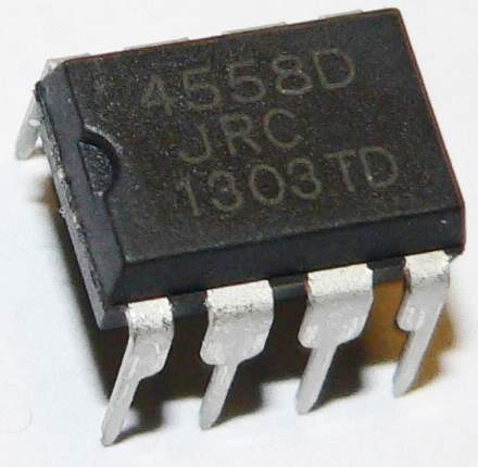

Thanks Audioguru. I have a ton of 4558Ds and was lookign for a use for them. i also read this on this web page.https://www.neatcircuits.com/doctor_pedal.htmhttps://www.neatcircuits.com/op_amp.htm
The 4558 opamp is probably the most popular audio opamp in most pedals. Particularly the JRC4558 device. All 4558 devices are the same from manufacturer to manufacturer but some claim the JRC4558 has a more "desired" sound. I have not witnessed that but will go along with this tale for the time being. The 4558 consists of two independent operational amplifiers with common power pins. Pin 8 is (+) power and pin 4 is (-) power. Other dual opamps can and will work in this type of pedal. A MC1458, TL072, TL082, LM318, LF356, CA3140, etc.
The nice thing about these amplifier chips is that they can be programmed to provide the desired gain and don't require any external frequency compensation. They have a very high input impedance and a very low output impedance. Meaning they will not load a preceding stage and can provide a lot of drive for the next stage. If you are confused or want to learn more about opamps, study my Basic Opamp Design page.
Having said that, i don't doubt your advice. I am just in a learning mode and just trying to make circuits work and learn from my failures.

Reworking the Proco circuit for a 4558 is not at all difficult. What is your intended power source(s)?

The 4558 is popular in pedal circuits because it old but is better than the very old 741 or dual 1458.
Any opamp uses two resistors (or a pot) to set its gain.
Opamps designed 60 years ago (LM308 in your other thread) needed an external frequency compensation capacitor because in those days they could not make one in the IC.
Most opamps have a very high input impedance and some have extremely high.
All opamps have a very low output impedance.
ANY opamp can be powered from a single positive supply if its + input is biased at half the supply voltage and input, output and feedback to ground coupling capacitors are used like in all your other pedal circuits.
This circuit will make the same distortion as all the other pedal circuits you posted. The diodes make the distortion.
