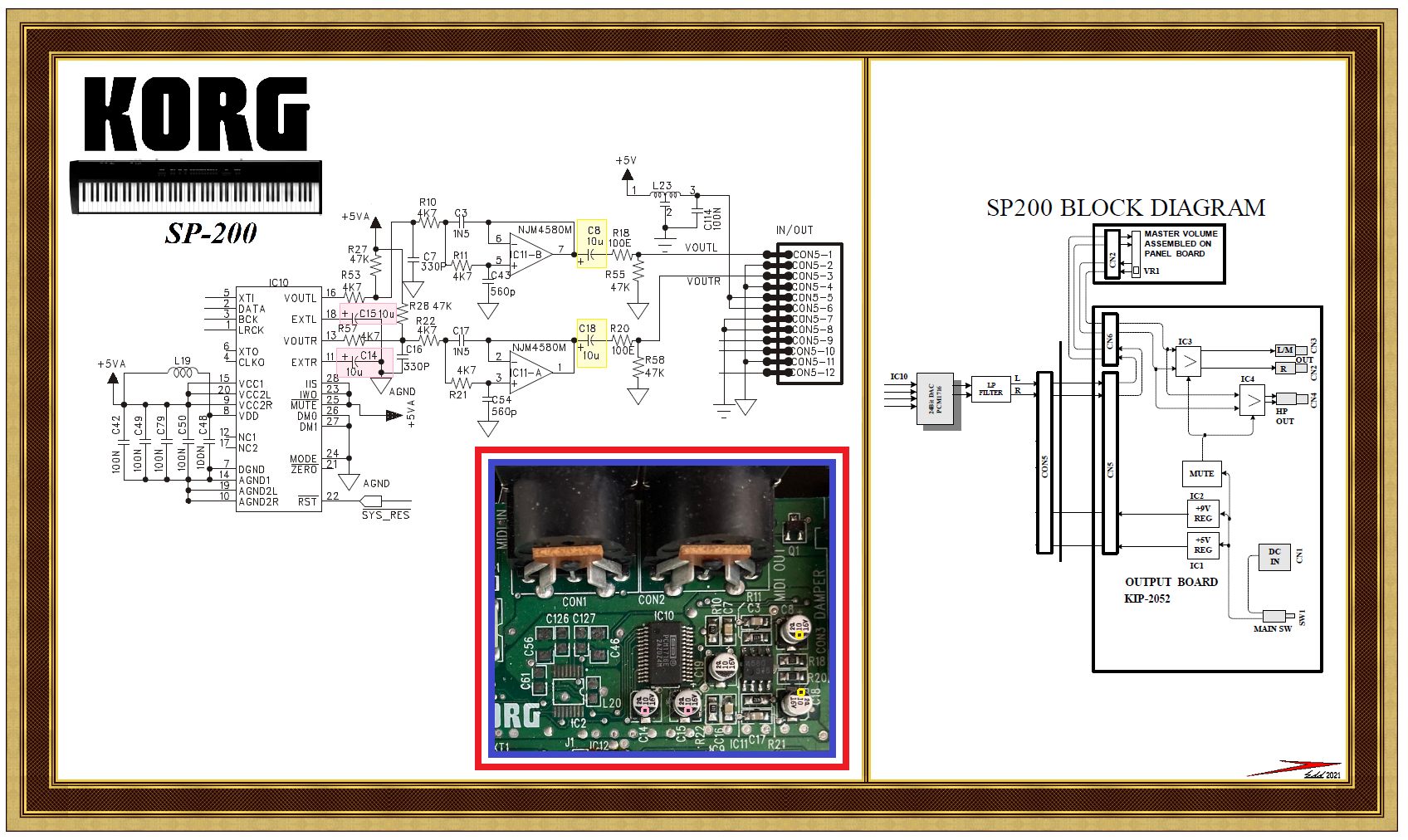

The Korg SP-200 plays very low volume.
My symptom is interesting because, the same issue happens both headphone and MIDI to Mac.
(In Mac, make mac volume max, and the midi interface amplification max, it's somewhere in 'mid-range volume).
First I checked below two posts, and replaced 4556AD and 33078P in orange board, and POM1716E in green mainboard, volume switch in control board (impedance is OK).
https://www.electronicspoint.com/forums/threads/korg-sp-200-piano-low-volume.293013/
https://www.electro-tech-online.com...r-repairing-soft-volume-in-korg-piano.157969/
I guess the issue is in mainboard (Since all capacitors are intact in orange board, and replaced all AD converter in the same board), and trying to replicate electro-tech-online post, but cannot point out which SMD cap should be replaced.
I believe many SP-200, 250, 300 users experienced same issue with different cause.
Any help would be very appreciated. Thanks.

A cold solder joint, a defect in the potentiometer, a defect in the ADC that converts the potentiometer output voltage to a digital signal indicating the volume, a defect in the supply voltage of the potentiometer ...
Inspect the solder joints visually, re-solder suspect ones. Check the function of the potentiometer. Measure the voltage across the potentiometer and from teh wiper of the potentiometer to ground.
Check the correct seat of all connectors.
Check any setting that may influence the volume.

Sir ipsych . . . . .
If the master vol board is cleared of suspicion, you need to move on to the main board next, where the IC10 D-A converter regurgitates the processed digital info into being R & L analog audio again..
Take in hand a 10 uf @ 16-25 dc rating and solder tack two insulated wires ~6in long so that you now have a cap with " two test leads " and their companion " end test probes " are then being the just barely exposed bare wire tips at the wires other ends.
Get the unit making a note / noise and evaluate its max audio output level.
Then OBSERVE your choice of either electrolytic can C8 or C18's polarity and put your test capacitors two leads PROPERLY across the one you chose.
Any volume increase ? . . .if so test the other cap in the same manner . . . . thereby, testing both R & L channels in that manner
Additionally there is being a bypass function associated with circuitrry within the innards of the IC10 chip needed for either channel . . . . use the same procedure across C14 and C15, to see what further volume level improvement might be acquired with their replacement additionally.
BUT I'VE NEVER DONE NEURO-CORTEX SURGERY BEFORE . . . . . .
Not to worry, if needing to replace . . .just use conventional radial lead E-caps with leads cut off to a 1/2 in length and form right angle wire feet at their ends .
Play with the spacing until they conform with the solder pads to be resoldered onto.

Just for the record, in case anyone with the same problem finds this post:
We have successfully repaired such volume issues (on a SP-300 but same main board), by replacing all eleven 10uF/16V SMD capacitors on the main board (logic board, on top, not the power board). Since the piano is old (20 years?), we did not individually test the capacitors, but just replaced them all. After desoldering it turned out, that *all* of the caps were dead (0F, open circuit). Due to its age, inside the piano we discovered that the speakers bead (round rubber at the edge of the membrane) was disintegrating. We replaced the speakers aswell. Piano repaired, volume problem solved.
