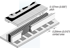

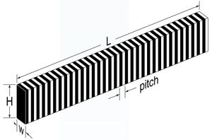

Mistah K . . . . .
You must have the critical portion . . .the PCBs gold fingered contacts . . . . being on the other side of the board.
The Zebra strip with its alternative black conductive and insulative strips, conducts through its black sectors from the contact areas on the PCB, across to the electrodeposited surface contact electrodes*** of the LCD glass plate contact area.(*** VELLY-VELLY delicate).
Avoid oils or paper chaff / cotton linters, deteris, on the Zebras contact ends.

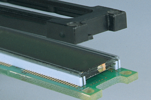

Let me lift that bezel cover up a little, for better visual access.
Then, you cut two spacer strips from a manilla folder to up the clamping action .
Might as well blacken them all up with a BLACK Marks a Lot to totally hide them from any lateral
close up view.
If that does not quite provide enough additional clamping pressure slip in yet a second set of shims.
If THAT still doesnt FULLY work . . .I will give you my world wide famous Timely Techno Tip on Zebra
strips of posting times past.
( Just as soon as I prep up a newer photo insert for it. )
" ONE SPACED OUT ZEBRA "
which is why I asked for both sides photos !!
After consulting my largest Crystal Ball and seeing the delay in the forthcoming photo, I had precursored that situation and just interjected my photo early on.
