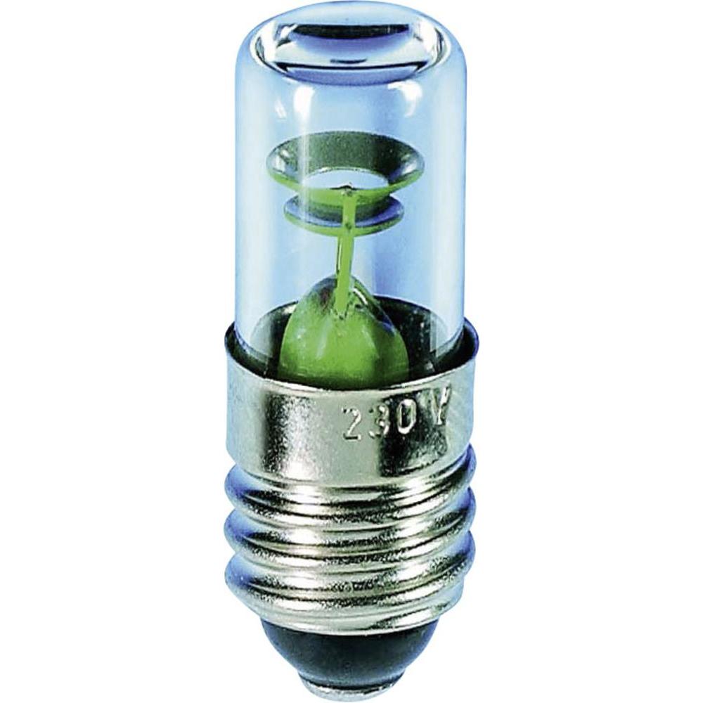

Looks like this might be the definitive replacement for that lamp.
Note that the electrodes are designed for a spot production of illumination, then the lens built into the end
of the envelope , provides for even further spot concentration.
It may be a bit pricey, as being compared to a wire leaded common NE-2 (wide lateral/spatial light dispersion) but considering a neon lamps l o o o o o o o o o long life, that would be my choice in a neon replacement.
Plus you want to confirm that present R901 series limiting resistor value is not being too low for this lamp, if the light initially shows up to be excessively bright..

Thanks everyone for your very interesting and informative help. However, I'm mostly liking the look of 73's de Edds Neon. I think this would be the easiest solution for me plus it looks like it would fit perfectly into it's housing.
Am i right in thinking that i should just be able to snip the wires off the old then just directly solder the new one on?
i.e: it's the correct voltage and ampage rating? ( I said i was novice)
dorke
Jun 20, 2015
2,342
Jun 20, 2015
2,342
You can solder the wires.
There are 2 problems with that solution.
1. There are so many different Neon lamps with different voltages/currents and light brightness,since you don't know what is the part you have it may or may-not be the correct part.
2. The lamp body(and bayonet) will be connected to mains so you have to isolate them properly!
