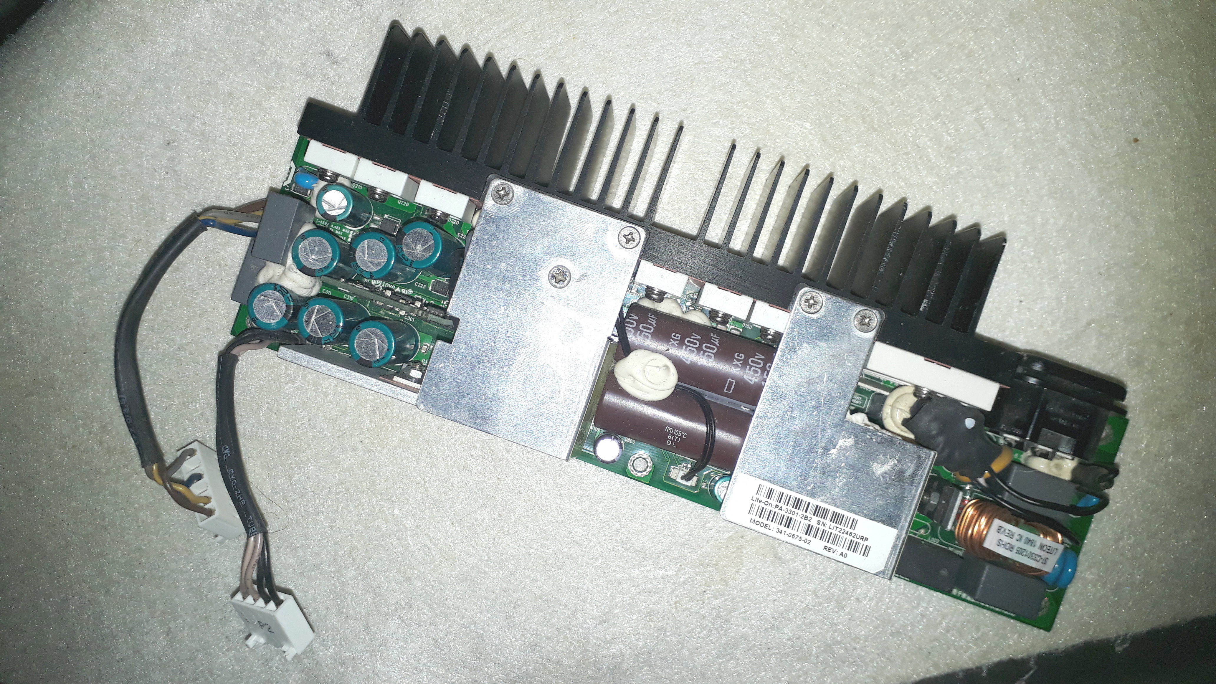

Hello,
A component burned on this Cisco 2960 switch power supply (WS-C2960CG-8TC-L).
I unsoldered the component (round shape and green colour), but it was impossible to find a reference as it was so burnt.
Have any idea of the component used and its part number ?
Thanks in advance ;)
well since we cannot see the component, we have no idea
you obviously took the component out .... photo it, sharp and well lit photo

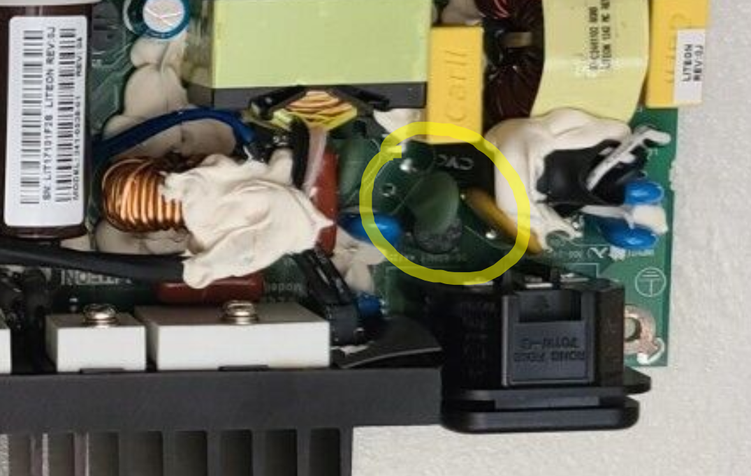

Hello,
Thank you for your reply.
It was a component (capacitor) similar to this one (it's a picture found on the web)

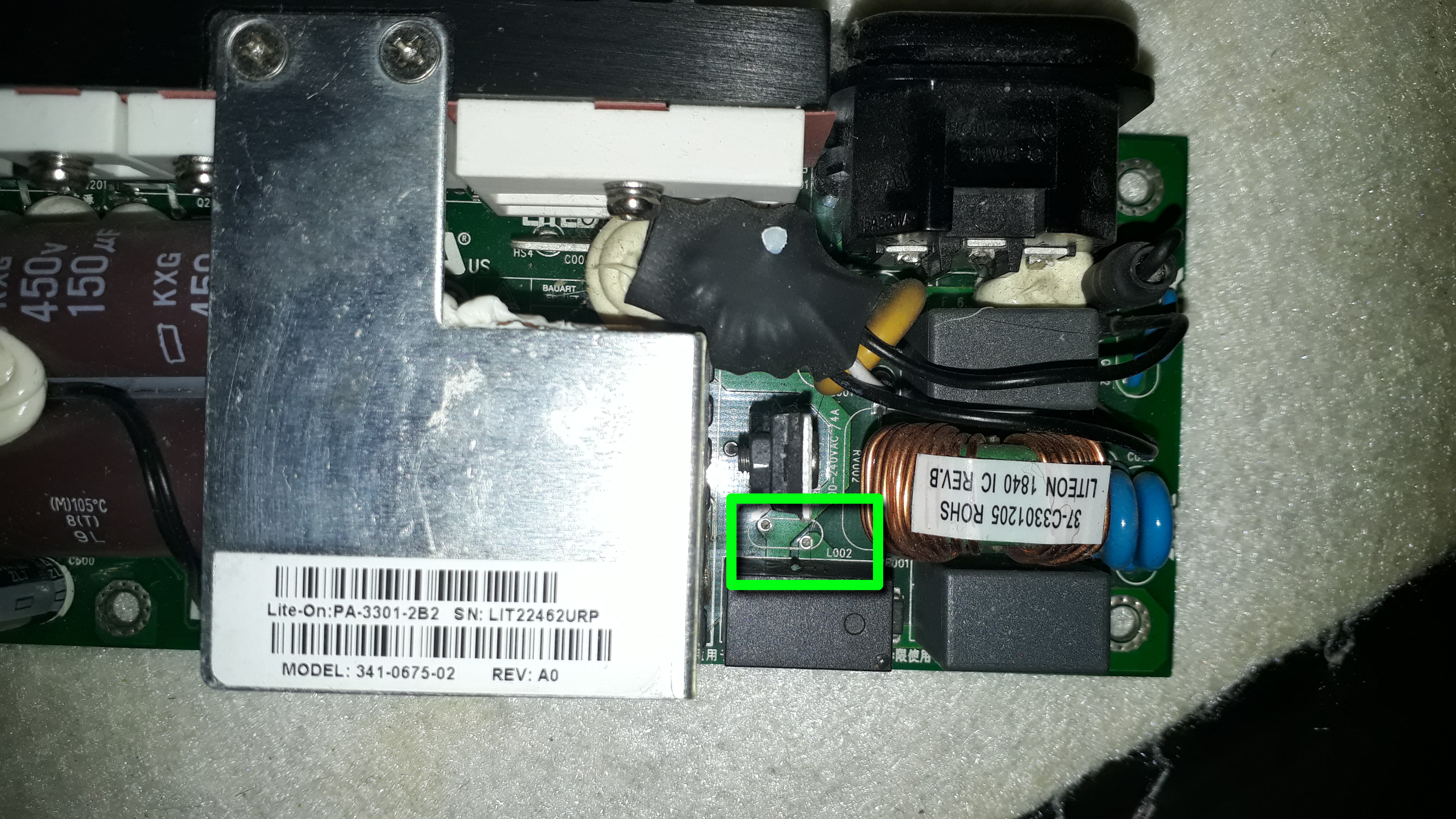

No . . .no . . .no . . .no . . . . it's NOT a (ceramic) cap
Why 'soitanly . . . . . . in putting my LEARNED eyes . . . . and that's being HEAVY ACCENTED on the LEARNED . . . . . . upon the photo . . . . and transferring to the mark-up below . . .
I AM SEEING . . . . .
AC power coming in at that top right X connector where AC power is initially met with item B a heat shrink enshrouded pig tail AC line fuse and then AC power gets shunted with item C varistor.
Then AC power is shunted with X safety capacitor item D and passes down and into contra wound RFI/EMI toroidal choke coils and out of them into another X safety cap . . . item D'.
Now, finally, the hot AC line voltage goes into your H mystery device . . . .which is being an incoming surge current limiting thermistor . . . . with its negative temp coefficient . . . no less.
Lite On power supplies have used SCK-2R55A . . . . . .CL110 and SCK10 units in the past.
Now your pictures neglected to show a sticker with the power rating of this supply upon it . . . . to be able figure its cold / hot transition value. BUT I think that I can see just one of its DC output supplies . . . . . that is developing 200'ish watts.
Fill us in on that spec . . . . for thermistor computation.
For that part to be overloaded and burnt up,expect the hidden fuse to also be blown.
The initial fault was probably being a crowbar like short of the P-Q-R power components mounted to the heat sink or the Item J bridge rectifier or possibly even the brown item L . . . . .E-capacitors.
I will fill in the other items later . . . . . .if needed. You now know the main ones.
I would be installing 2 hook up wires into the thermistor holes and terminating into a 50-100 watt 230-240V INCANDESCANT lamp and initially powering up the supply after having tested all of those prior suspects for shorts, THEN . . . .if the lite comes on BRIGHT after power up . . .still problems.
The other condition is the lamp would only come up to a dim orange glow during the 300 ufd of E-caps initial very charge up surge, then dim.
Since full line power is not available for operation. Matter of fact that dim and short test phase may need a VERY DARK room to see it.
BUT if no BRIGHT light you seem to have eliminated the major defective components.

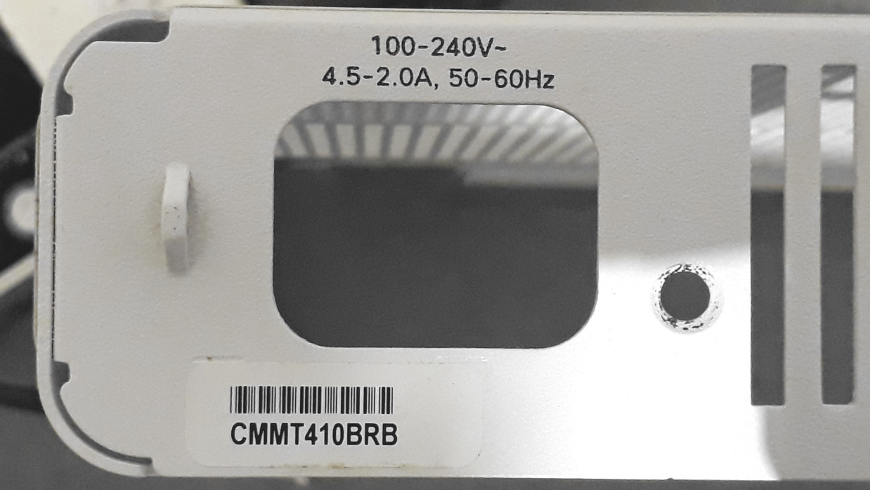

Hello,
Here are the characteristics printed on the box
100-240V~
4.5-2.0A, 50-60Hz
Thanks in advance
