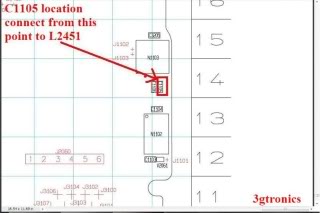

try this..follow this diagram and check the lines
[/IMG]
[/IMG]
[/IMG]
actual pictures front near the lcd connector
[/IMG]
back,
[/IMG]
hope it can help..=)
