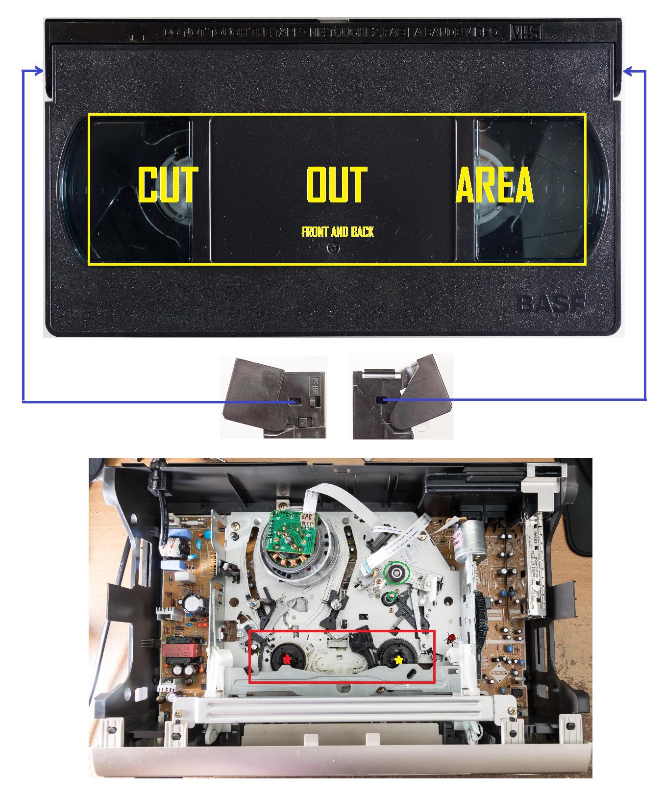

Get a tape you dont want and gut it removing the clear windows. Cover up the tape-end holes with black tape. This is a test blank. See if the machine will load it.

I've already tried placing a tape in after removing the elevator but no luck there. I'll try what you said, though I don't have any tapes I don't want. I'll try and find a charity shop tomorrow that still sells VHS to try this. Thanks!

Sir ask for boots . . . . . . . . . . .(but . . .but . . . but . . . . .I only wear shoes.)
Just a bit of graphics to fully supplement the good and sound advice already given to you by GPG.
They make . . . . MADE ? . . . a clear plastic dummy cassette which would let you look down and see the FEED reel YELLOW and the TAKE UP reel RED.
It would also let you reach down and touch their spindles to check for torque, although the feed reel is merely a slight drag to keep tape tensioned while the slight pull is from the take up reel with the REAL tape transport being done by the capstan shaft and it pinch roller. (GREEN circles).
But most problems are associated with the take up reel. Any tape spillover, and the movement sensor associated with that reel will go BAMMMM, and the transport will shut down. ( You don't want 'lebenteen feets of tape all wadded up in the unit !)
In making your "DUMMY TEST CASSETTE" pop out the clear plastic covers and use a DREMEL tool with cutoff wheel OR Sabre saw OR hack saw blade, to remove the YELLOW cut out profile on both top AND bottom and be sure that the unit is 100 % totally free of ANY ANY ANY loose debris, and being totally clean.
The RED area on another VHS unit shows the visible area that you will now be able to see . . . . mainly the units all important take up and feed reels . . . while the unit is fooled into thinking that it is playing a tape..
The black electrical tape comes into play on covering the two shown holes. The machine will brake and shut down if the light path thru these holes is completed, as in detecting the clear plastic leader at the very beginning or very end of a tape or also, if a tape breaks or has a badly trashed area in it.
Also, VEWY- VEWY IMPORTANT, DON'T use a STRONG overhead light on or near the unit as it can TRIP those photocells and shut down the transport.
Put in the test cassette and touch a finger to the hub and see if that take up reel is producing a firm drive, or is it sluggish or slipping . . . .or not even moving.
Waiting to see if you have any snags . . . . . .
