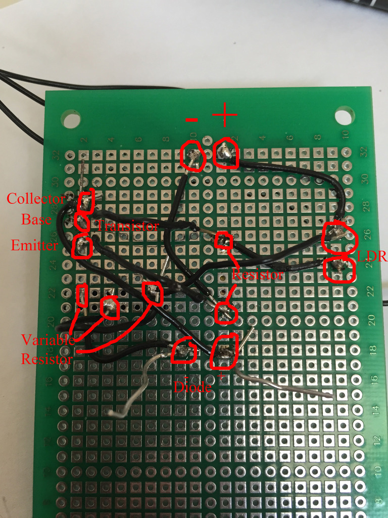

So I have wired this up and can't seem to figure out why it wont work. When I check the resistance across different parts of the circuit things seem fine except for when measured across the transistor where I get and I get a 1 on the multimeter when I measure the circuit as a whole. I get no luck when I hook the relay even when bypassing the LDR. I would appreciate any help where I may have wired something wrong. As bad as the soldering looks there is nothing soldered together that shouldn't be.
