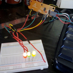

Following on from this thread in the microcontrollers section, I've started my actual build. The keyboard was a cheap £6 one from the supermarket.
I've replaced the LEDs with header pins and done the same for the external connector (the wires were just soldered to the bottom with a pathetic blob of hot glue to hold it together). There were also a couple of unused holes for an extra bypass capacitor - a handy place to put another couple of pins for the voltage rails.
Contrary to the initial concept diagram, these LEDs are connected common anode, so some redesign will be needed.
Quick test with some LEDs:
