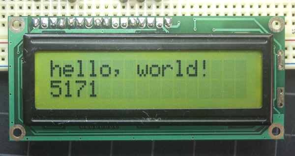

In my research I've found this LCD display for Arduino. Would something like this be simpler to code? Say I have a 4x4 switch matrix, with all different score values and displayed the score (incremented for each switch/target hit) on the LCD as opposed to seven segment displays. Is this a better option for a novice like myself? :)
Also, could the LCD handle this many switches?

This type of LCD is simpler to connect to the Arduino, just 6 wires, and about equally complicated, though very different to program for.
You will be able to find Arduino code to drive either type of display that you can download and modify as needed, so I would say it is a tossup in that respect.
On the other hand, I think a small LCD display is not flashy enough for a pinball machine. I would go with 7 segments, and large ones, myself.
I would also make them count up, don't just add 10, add 1 ten times over a second or so. Maybe for 100, add 10 ten times. And don't forget the bells!
