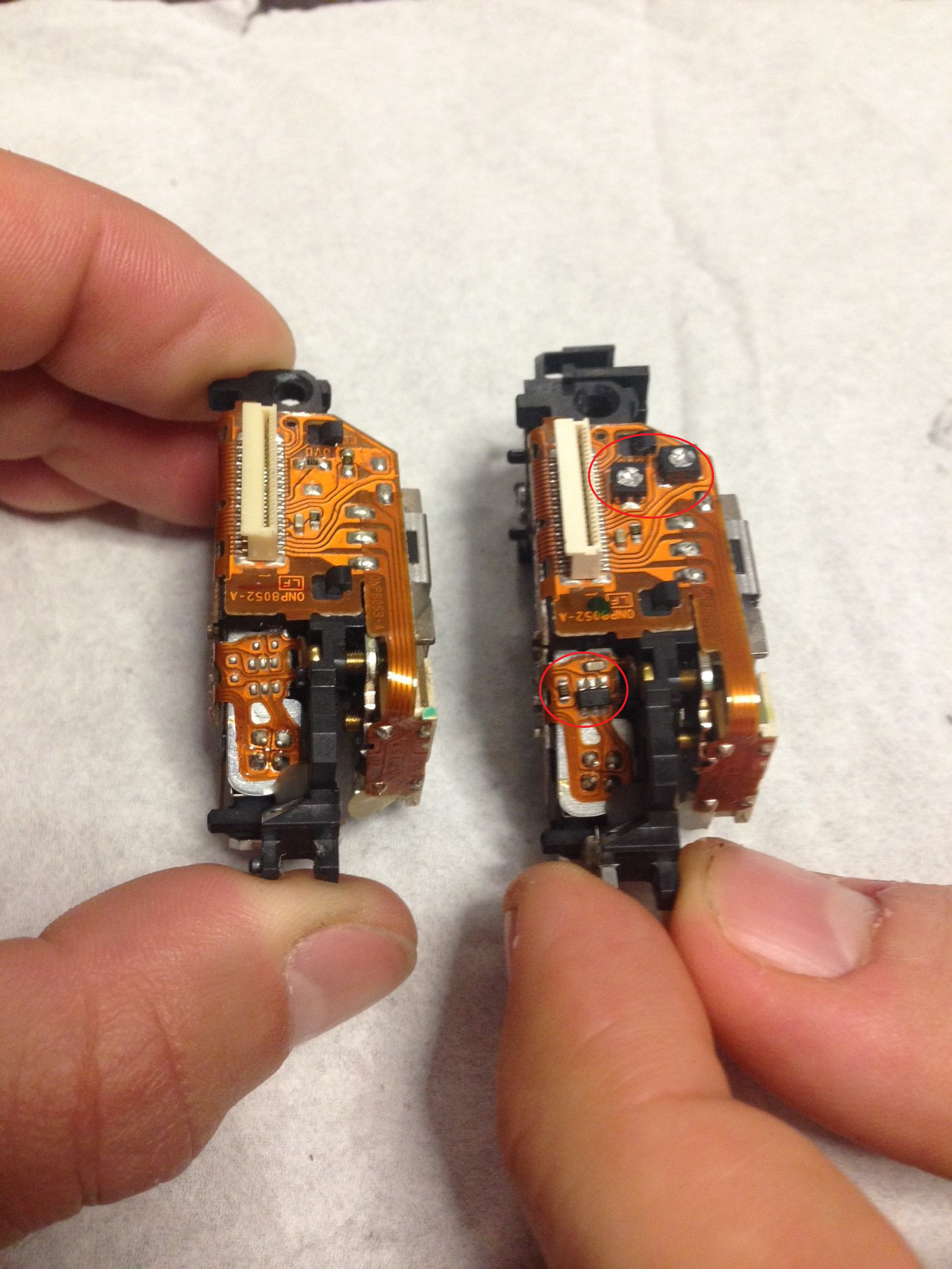

Hi everyone, i'm having a lot of trouble with replacing a lens for a professional cd player (for DJ's - the Pioneer CDJ 1000 MK3) and after scouring the internet for information, i think my last chance is finding some help from a bunch of electronics gurus. Seriously, you guys are kinda my last hope.
This is a somewhat older model (they stopped manufacturing them a few years back) and a few months ago it started having errors after 20-30 minutes of playback (E-8302 - Error during playback). After googling this i found out that it's most likely due to the lens being worn out. I ordered a new lens head, the Amazon store said it was for the CDJ 1000 MK3, but when I received it i noticed minor differences (the pictures on the site were too blurry to tell). By minor differences i mean it has a few extra electronic parts on the circuit board, as you can see in the pictures below (left is original, right is new one).
After installing the new lens head, the CD Player doesn't even start spinning the disc - it just takes it in, waits for a few seconds and then ejects it. My next option is to find out if either the lens itself can be taken out of its housing and moved to the old lens head, or if the circuit board can be in some way modified to match the original (for example by removing some of the components).

My guess is that the old one has some unnecessary parts non populated. The replacement has them populated because it is a generic replacement for various heads which may or may not need these parts.
On that basis I would have given it a go just as you did.
I will note that there are some fixed resistors on the old unit and trimpots on the new one. These are probably set to the right value and I wouldn't remove them.
The resistors on the rear side (marked "0") may be configuration jumpers. The problem *might* be the extra jumper on the new unit. You need someone who has some experience with surface mount components (ideally) to remove this. Remember that you might want to replace it again, so don't lose it and make sure you have it well marked so you know where it came from.

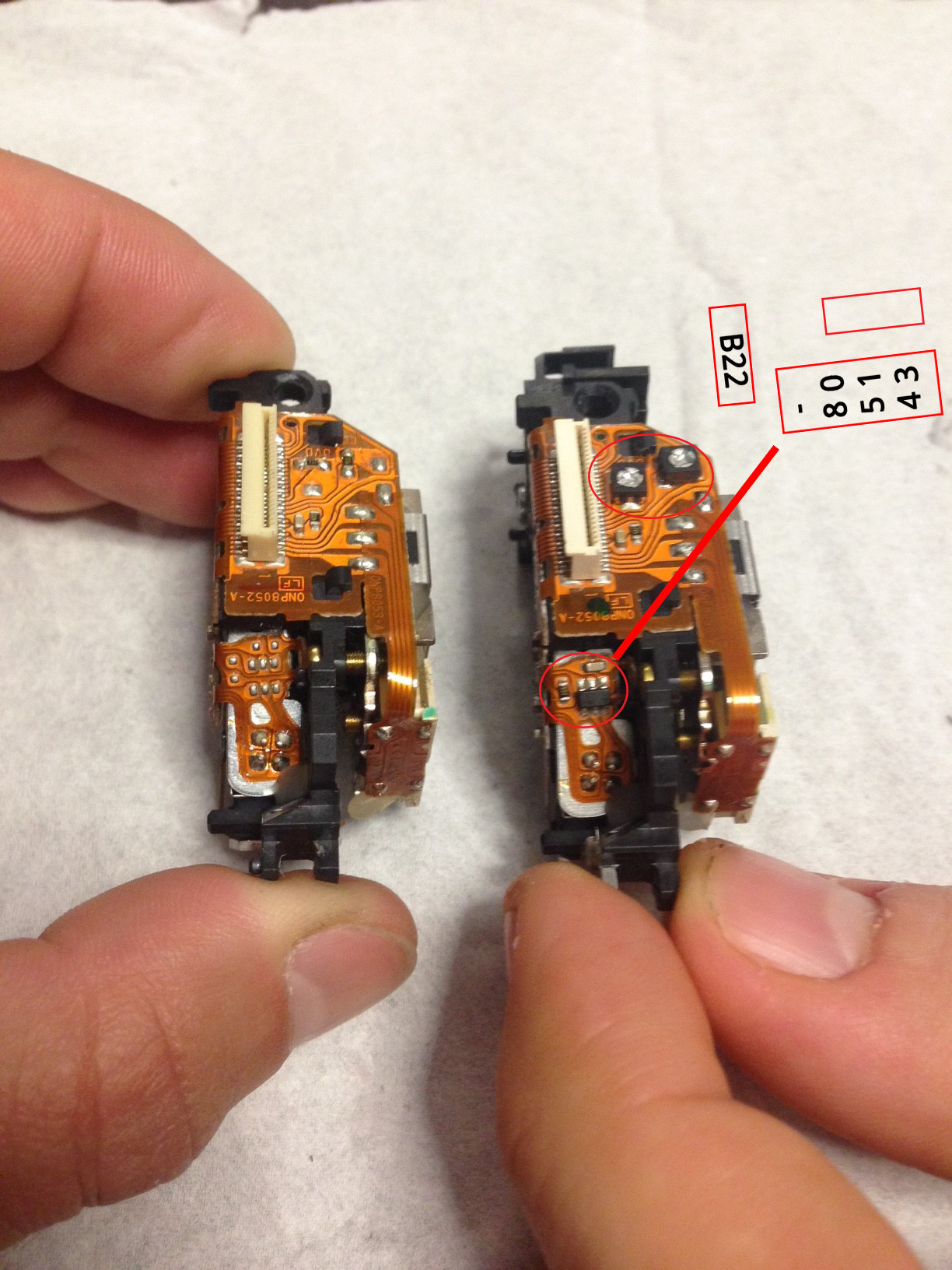

Can you make out the markings on the 6 pin device and the resistor next to it (the capacitor will be unmarked)?

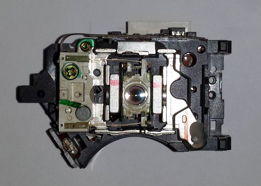

The lens itself doesn't wear out (but it can become dusty). The focus mechanism can fail, but it would normally be a hard failure. If there looks like there's any dust in there I'd gently blow or brush it out -- GENTLY!

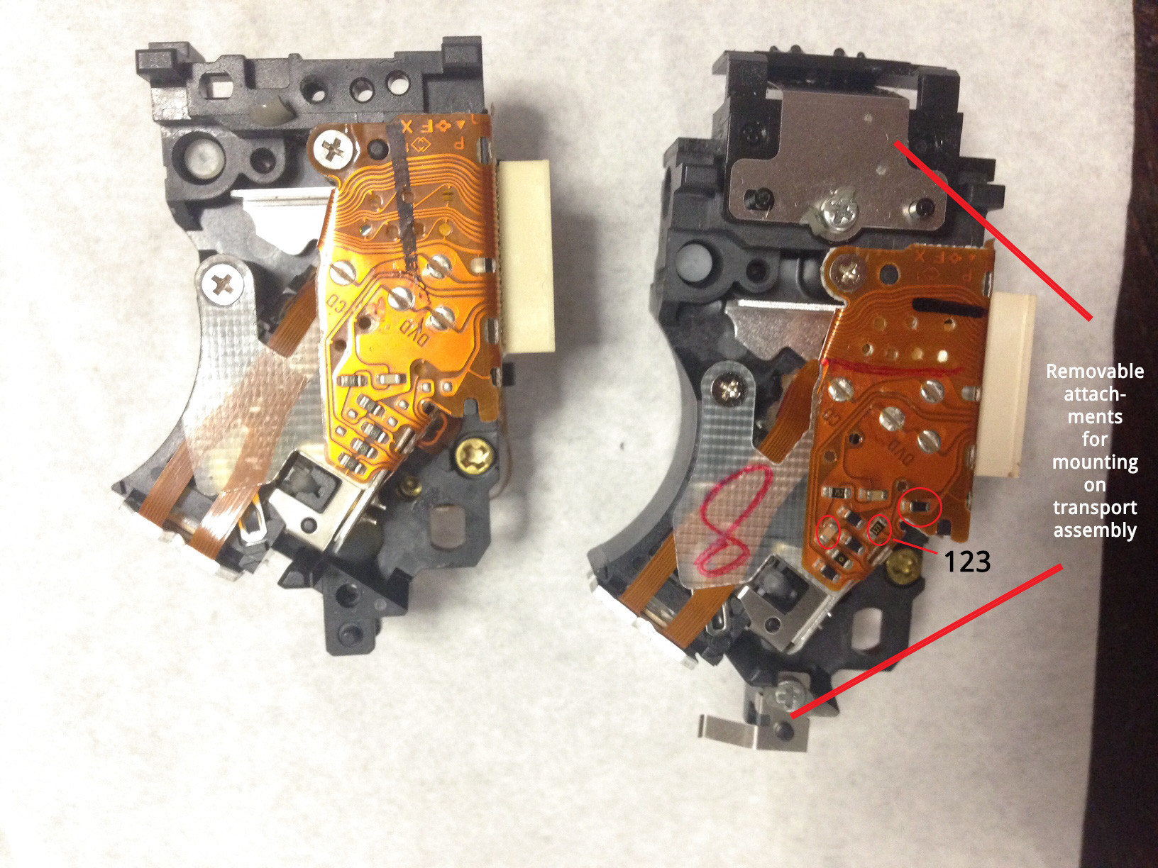

"The resistors on the rear side (marked "0") may be configuration jumpers. The problem *might* be the extra jumper on the new unit. You need someone who has some experience with surface mount components (ideally) to remove this. Remember that you might want to replace it again, so don't lose it and make sure you have it well marked so you know where it came from."
- Actually there are three extra parts on the rear side, not two as i highlighted on the picture (i missed one). Below is another pic with all three highlighted and the marking on one noted. I'll forward this to my friend and ask him about it.
"Can you make out the markings on the 6 pin device and the resistor next to it (the capacitor will be unmarked)?"
- can't tell which one is the resistor and which one is the capacitor, but here's a pic with the markings highlighted.

"The lens itself doesn't wear out (but it can become dusty). The focus mechanism can fail, but it would normally be a hard failure. If there looks like there's any dust in there I'd gently blow or brush it out -- GENTLY!"
- I didn't mean that the lens physically wears out, more that the head wears out in some way - sorry for this, English isn't my first language :). This is what the repair people here in Bucharest told me. I've cleaned the exposed part of the lens with an earbud with isopropyl alcohol, but if the underside is dusty, i've got no idea how to clean it...maybe a compressed air spray?

It's hard to know what is best to suggest at this point.
One option is to remove all the extra components (don't remove the 2 trimpots though) and see if it makes a difference. I can't imagine that it will behave in such a way that it will work with them present, but not with them absent, but you never know. Make sure you keep a good track of them so you can put them back if you need to. The 6 pin device is the only one that needs to go back with the same orientation, but if your noted indication of the numbers on it are correct, that will determine the orientation.
If that doesn't work, I would measure the resistance across the 2 resistors in the original unit and compare the resistance to that between the same pads of the new unit. Note all of these down. Then adjust the new unit to read the same resistance. (by recording the old resistance you can go back to it if you need to)
Be prepared for it not to work though. This is a bit of a Hail Mary.
