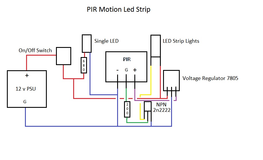

I came across this circuit that looks promising. He posted a link to a video of it turning on LEDs on his stairs. What do you think?
https://i.stack.imgur.com/7tT4P.jpg (The thread asked how to add an LDR so the lights wouldn't come on in daylight but that doesn't matter for my project).
Sidecar Bob
Dec 19, 2021
271
Dec 19, 2021
271
I just realized that the link in post #14 is to the drawing, not where it came from. Here's the correct link
https://electronics.stackexchange.c...-controlled-by-pir-want-to-add-ldr-to-project
I also realized that the transistor's terminals are not labelled. Based on other similar circuits I see online I think it is safe to assume that the emitter is connected to the negative line.
Once I removed the switch, indicator LED and 7805 that I don't need it looks like this. Is this all I need to do?

I have the circuit above in a breadboard with one of the unmarked TO92 transistors on the bench as I type this. I verified that the transistor is NPN with the multimeter and I know that the middle terminal is the base but I'm not even 100% sure which is collector and which emitter but it works perfectly and the transistor isn't getting hot so I'm not going to change it.
I can't believe how simple this turned out to be.
They don't have to be. The symbol is well defined:
Emitter is where the arrow is, collector is opposite the emitter. Base is the single contact to the bar that connects E and C.
I know that the middle terminal is the base but I'm not even 100% sure which is base and which emitter
The second "base" here should imho read "collector", shouldn't it?
Anyway, when you swap emitter and collector of a bipolar transistor (such as this NPN), the transistor will still work, but current gain will be drastically reduced.
The circuit you show in post #16 uses a 200 Ω base resistor. The pir sensor has a 3.3 V output. With a base-emitter voltage of 0.6 V for the NPN, the resistor limits the base current to IB = (3.3 V -0.6 V) / 200 Ω = 13.5 mA.
As the light operates with only 26 mA (post #7), a current gain of 2 would suffice to drive the LED. In this case it won't matter if you swap emitter and collector.
However, you could save on energy by mounting the transistor correctly (the datasheet will tell where E, B and C are) and making use of its gain of 50 or higher. With 26 mA collector current and a gain of 50, the required base current is only ~0.5 mA. Let's use 1 mA (for some headroom), the the base resistor becomes RB = (3.3 V -0.6 V) / 1 mA = 2.7 kΩ.
Admitted: 1 mA vs. 13.5 mA is not a big saving in this application, but looking at the overall current consumption (excluding the pir as it is not affected by this change) current drops from 39.5 mA to 27 mA which is ~ 30 % in energy saved and accordingly your battery will last about 30 % longer.

The transistor's terminals aren't labelled in the drawing in post #14, which represents the transistor as a rectangle with 3 leads.
I used a proper transistor symbol in my version and I assumed that it should be a common emitter configuration.
Yes, I meant to say collector. Unfortunately this forum doesn't allow you to edit posts or I would correct that.
The transistor I used is unmarked so I couldn't look up which lead is which. I'm only sure that it is NPN and which is the base because of testing with the ohmmeter.
45 years ago when I was fresh out of college (Electronics & Acoustics) I might have thought of measuring the current with it connected each way to determine which is base and which collector. Now that you have refreshed my memory I'll try to remember to do that the next time (I have a feeling that re-learning some of this stuff is going to be harder than learning it the first time).
Re the 200Ω base resistor, I'm not even sure if that is necessary because the HC-SR501 has a 1K resistor in series with the output but resistors aren't expensive and in this case it worked out that the resistor's stiff leads support the transistor.
A total of 1.2KΩ in series with the base would mean that the current would only be 2.25 mA so any saving would be truly minimal, especially since I am powering it from an AC adapter.
