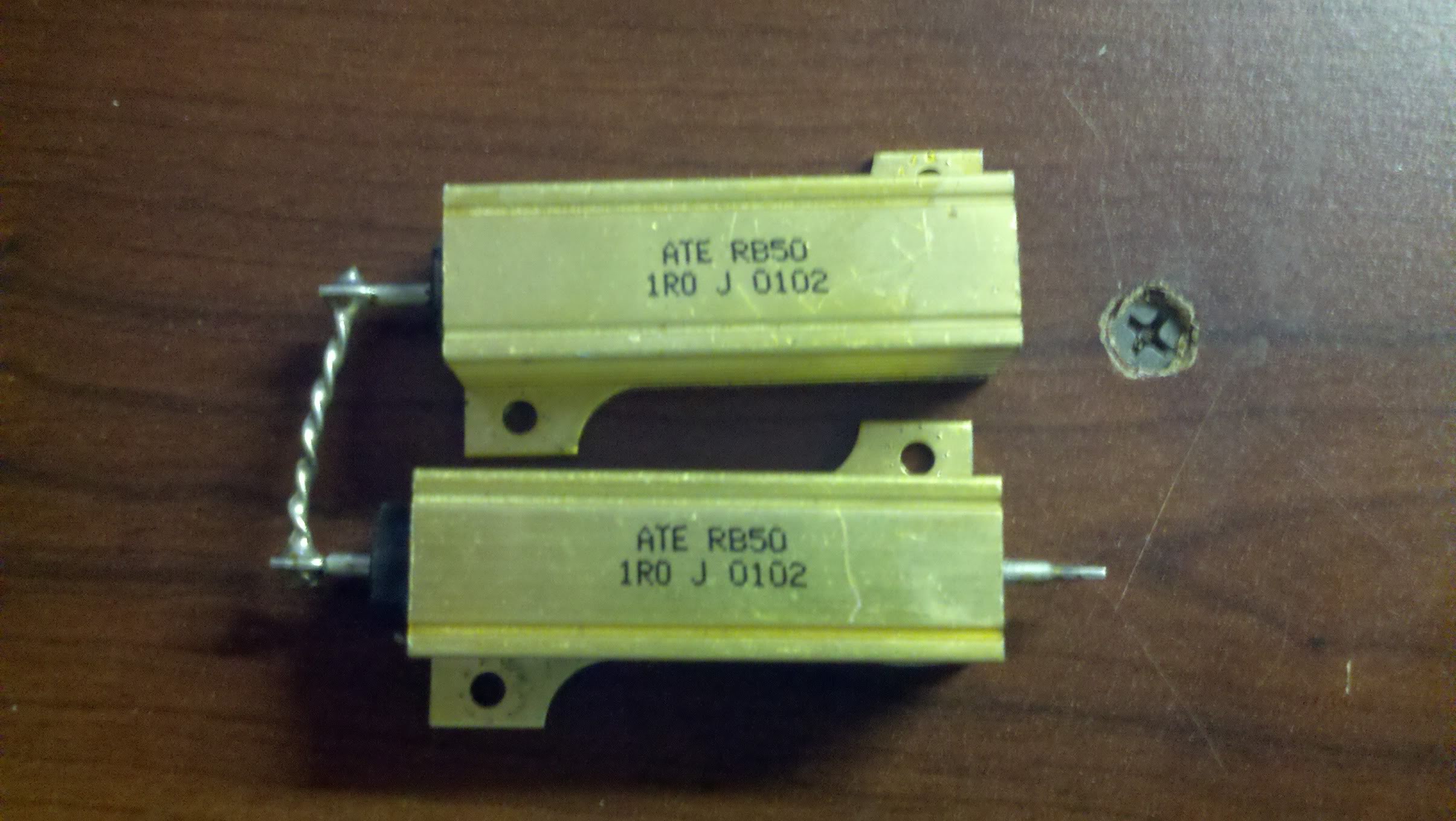

Hello, I have a plasma cutter which is made in Italy. When using it, it produced two loud pops. I opened it up and found these two resistors blown up. I cant seem to find them anywhere. Can someone help me read the values of these things (I don't know anything about electronics) And where I can buy a similar or compatible product.
Thank you very much.

Is the company still in business that makes the plasma cutter? I would assume they could tell you the required part value.
The question is why did they blow? Had to be excessive current due to what? Did you double check them with a meter to make sure they where open?
They are no longer in business from the research that I have done.
Not sure why they blew, I was using using the torch, cutting metal, and then I herd two loud pops. I'm not sure what you mean by checking them with the meter to see if they are open. I have a meter, but very little knowledge in electronics. I'm a fabricator/ mechanic.
do a continuity test. Set your meter to the Ohm setting, is normally green label. Put the probes on the resistor and check the value. An infinite amount of resistance means they are "open circuit" and have failed. current only flows in a closed circuit. If you get a value less then infinite, then what is that value?

So from the looks, the 1R0 is the resistance value, looks like the RB is the series and the 50 is the wattage. Someone with more expertise will back me up on this, but I am pretty confident that is what you need.
edit: Yep, I was right! http://www.ate-electronics.com/index.php/en/products/rb-series Replacements if they are 1 Ohm http://search.digikey.com/scripts/dksearch/dksus.dll
I have seen those resistors on eBay, and I have previously contacted this seller about it. But he doesn't have the exact ones that mine are calling for.
The other link you provided contains lots of information, and I dont know what I'm looking for...any other link where I can order a compatible item? Thanks again.
I did this, I get a value of 0, or closed circuit I assume.

That is a pair of 1 ohm 50 watt aluminum clad power resistors. 1R0 = 1 ohm, the power rating 50 is on the case, ive used these resistors. :)

Thank you so much. So I need two resistors of the following value: 1ohm 50 watt.
I'm in USA, and was looking at mouser.com
Could someone tell me if this resistor will be compatible to the ones I have?
http://www.mouser.com/ProductDetail...GAEpiMZZMtbXrIkmrvidKzXrWGN%2biMBUFsGlNR8xd8=
Be better off going with the TE con. on digikey, they have the same flange as the original. http://search.digikey.com/us/en/products/2-1625984-2/A102158-ND/2055334
digikey is in USA, ND to be exact. I use them exclusively. 2 day shipping most anywhere.

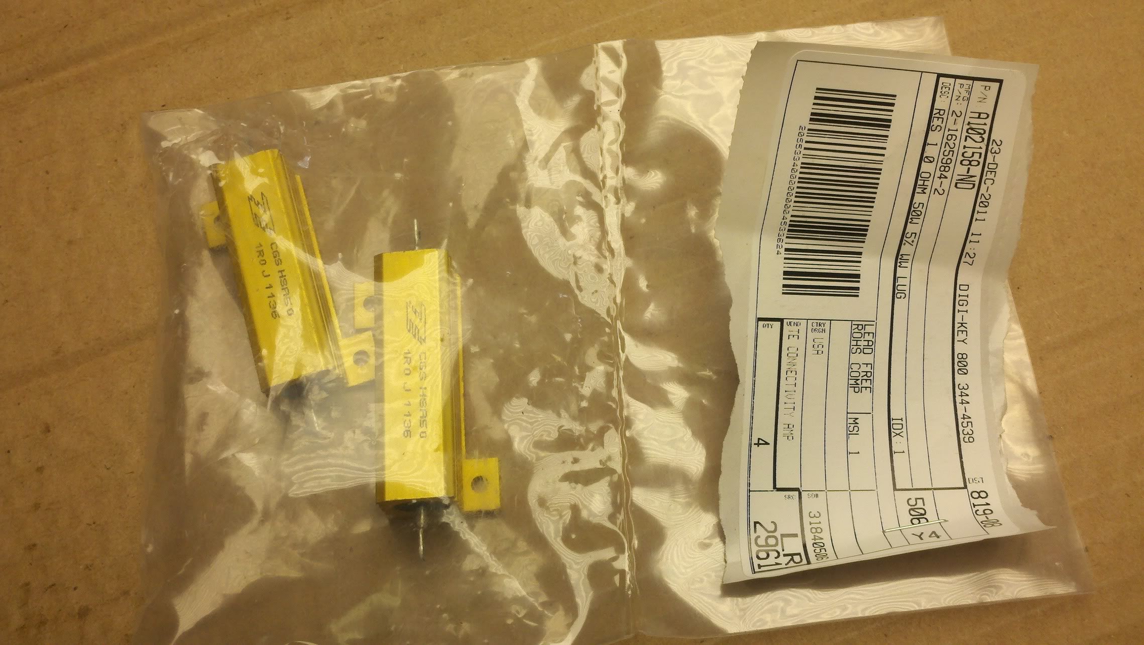

Thank you guys, I am getting closer to having my question answered, and will be placing my order soon with digi key.
Another question: it seems that these two resistors are connected in a series. Why not just get one resistor with double the value -- I assume in this case 2 ohm, 50 watt? What is the benefit of having 2 over 1 resistor, or a greater number of resistors over a fewer number of resistors?

I want to thank everyone for helping me in this matter. My didi key order came here Tuesday. As you can see from the pic, part is nearly identical to my original. Installation went smooth. Plasma cutter fired up and working. Thank you again, Merry Christmas and a Happy New Year !!!!
