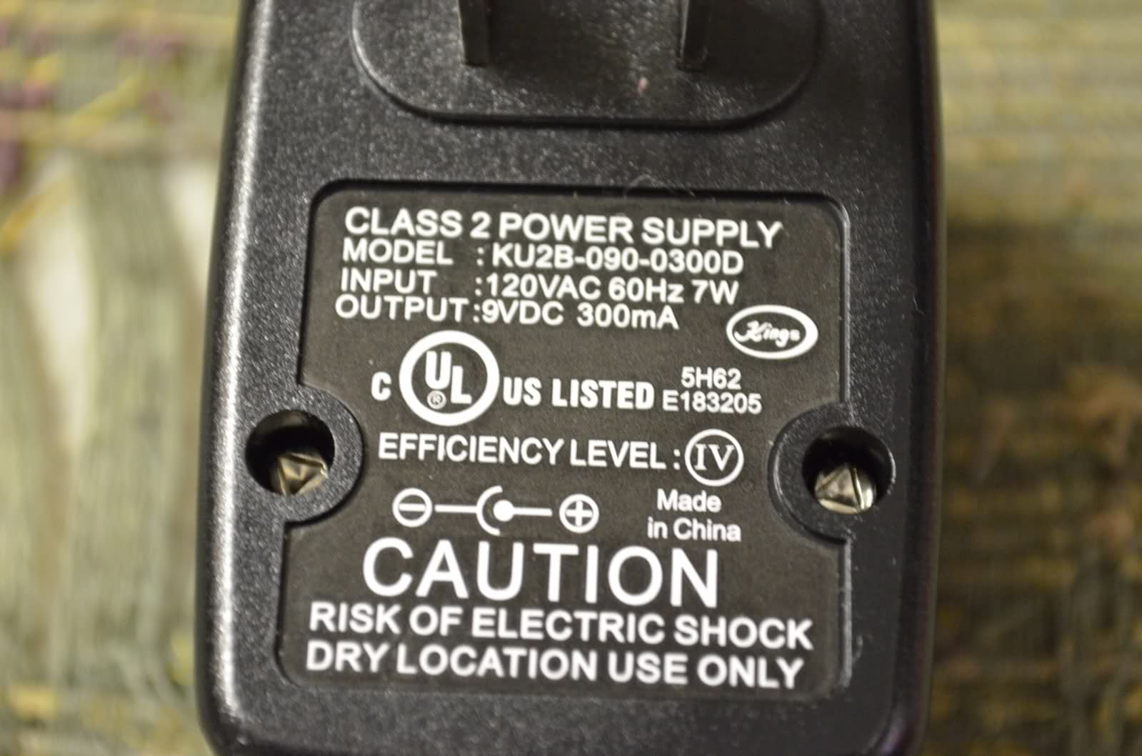

So here are some pictures of the power supply, I'd be very grateful if someone could point me in the right direction as to what I should be buying.

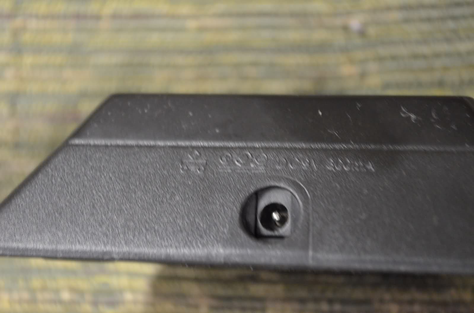

Here is one of the charging base, the text says "DC9V 300mA"

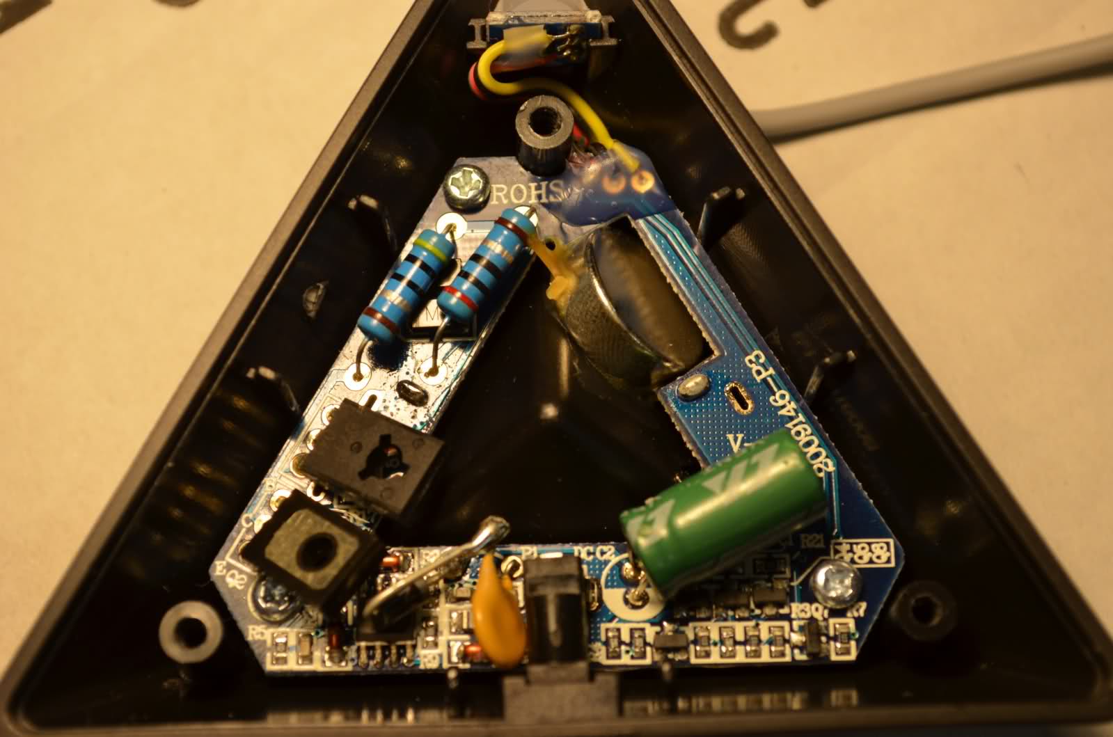

Here is one of the inside of the charging base, if it may help tell if it's damaged:

Likely the wall wart that popped, get a new Australian one with 9v DC out and at least 300mA... Also mind the polarity center is positive, sleeve is negative...

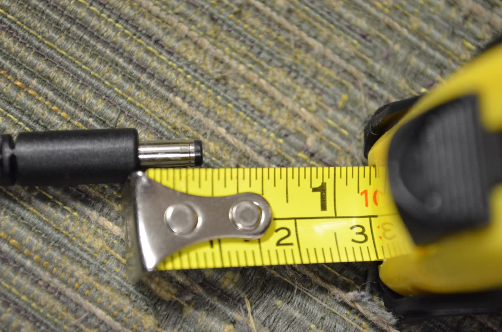

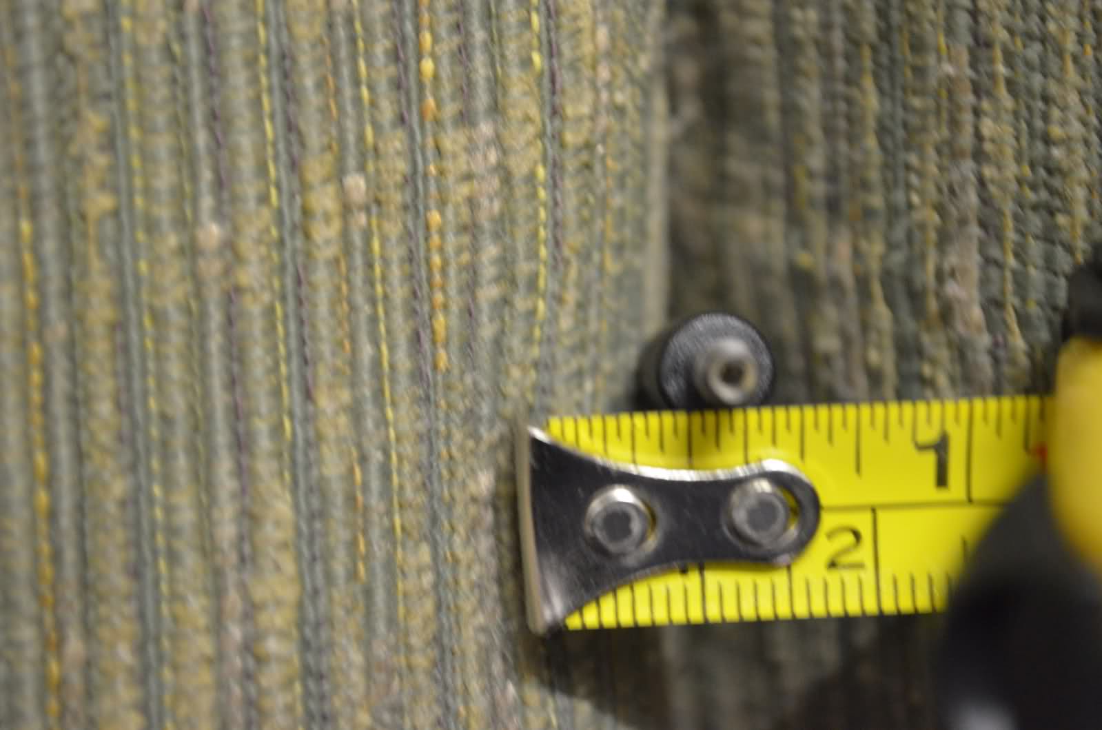

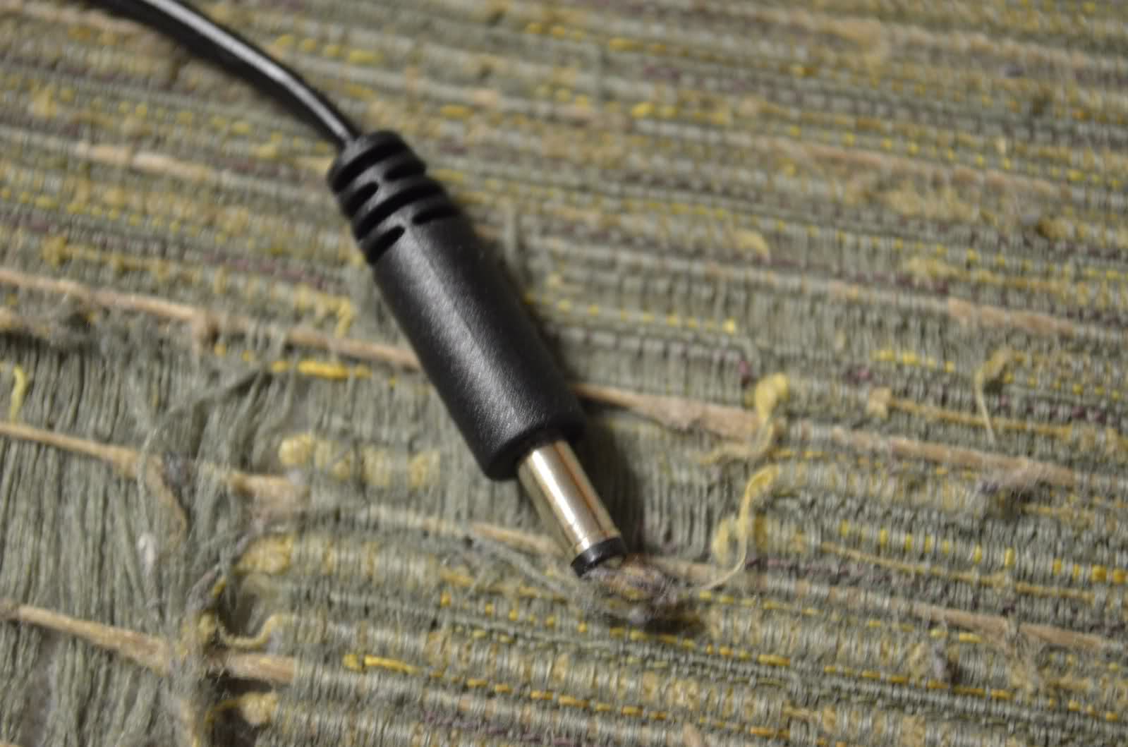

Now the bigger issue is matching the barrel connector, you really need a better tool to measure to get the correct size...
I can hazard a guess as to it being a 5.50mm OD and possibly a 2.10 mm ID? But, that is just an educated guess based on the out of focus picture you posted...
If you have a local electronics store take the wall wart with you and match it up in person...

Thanks for your answer, sorry about the photo, my camera was having trouble doing autofocus at such close small detail, and I don't have much practise with manual focus.

The connector is 1.3mm X 3.5mm X 9.5mm or 1.4mm X 3.8mm X 9.5mm.
