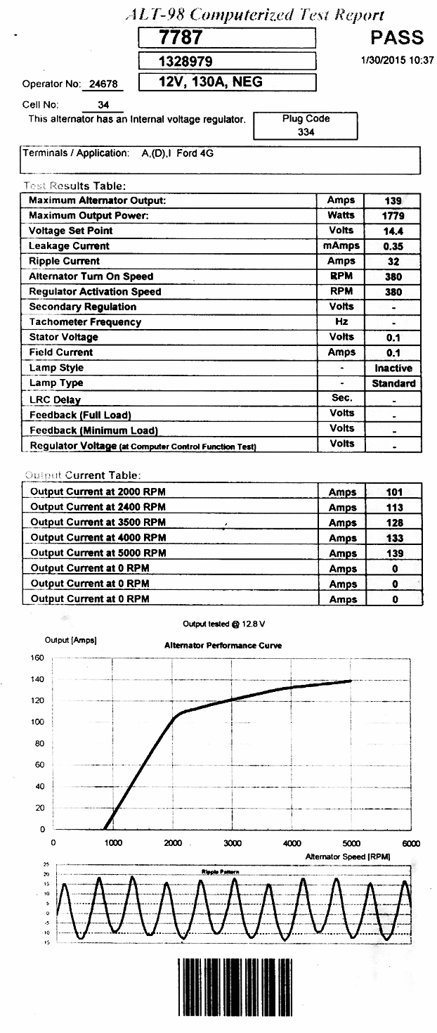

Most lighter outlets are fused at no more than 15A, upstream and depending on the vehicle, that 15A may supply more than just the outlet. You could run lower gauge wires to the outlet direct from the battery but the inverter may have its own 15A fuse, and the outlet itself really isn't good for much current as it's barely friction fit, not latching, and that's a new/unused outlet. If the outlet has been used for the cigarette lighter then heat and tobacco tar may have fouled it.
Don't get me wrong, if the outlet is in good shape it should be capable of charging a laptop and lesser electronics, but anything with a significant size motor or that produces more than small amount of heat, needs a dedicated circuit added direct to the battery with fairly low gauge wire.
Depending on use you'd also want to be sure your alternator can handle it. For example it might be a 130A alternator but that is "probably" peak output at several thousand RPM. When the engine is idling it will be producing less.
Below is the test report from an alternator I bought a few years ago. When the vehicle I put it in is idling, it has an RPM around ~1600 so then can only produce around 75A instead of 130A.
