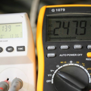

So I needed my power meter. It's a cheap Chinese meter that was thrown in with an order from an electronics component retailer here. It's a "CIXI YIDONG ELECTRONIC CO., LTD." branded device also labelled as "Type: EMA-1 V07442". I guess that might mean something to someone who Googles for it.
I noted that the batteries were flat, so I replaced them (2 x LR44). When I plugged it in my mains voltage measured 134V. Aha, I think. That's why I'm having problems! Well it turns out that the mains voltage is fine and the meter is giving spurious readings.
