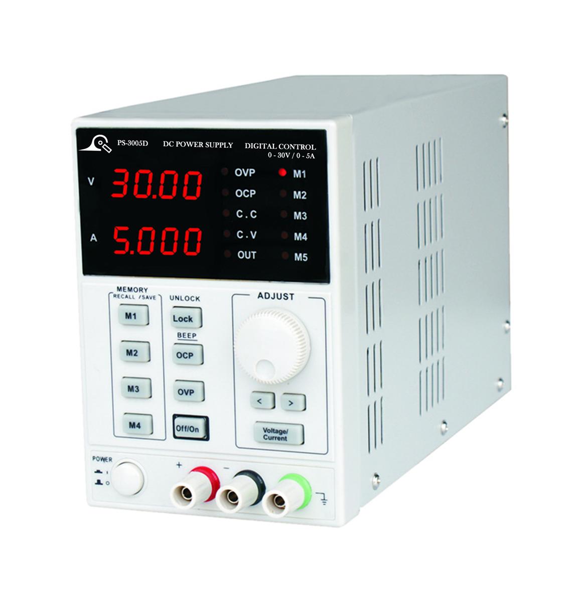

Power supply Current limiting , using what value resistor?
The power supply I have has current limiting knobs but it doesn't show you how much current it is outputting until you hook it up to the circuit
I want to know BEFORE i hook it up to the circuit how much current is outputting out of the external power supply
For some reason the external powers supplies don't tell you how much current is outputting unless its hooked up to a circuit
What value resistor and how many watts do I need?
That is because they don't output current unless connected to a circuit. Set the current limit by short-circuiting the power supply, setting the current, then removing the short circuit. Now connect the power supply to your circuit and the current will be limited to the preset value.
What for do you need it? Current limiting doesn't work by just inserting a resistor in the circuit. A simple resistor will limikt current but it will also reduce the output voltage depending on the current due to the voltage dropp across the resistor. Not a good idea. Read this article on current limiting. The circuits shown there provide constant output voltage as long as the current limit is not reached. They will limit current for higher loads. In the overload case the power is lost in the transistor, not so much in the sense resistor.
Wattage is P=i²*R, alternatively P=V²/R, so knowing either I or V and R you can calculate the power required.
I don't think you will be able to clean the mercury wetted contacts. Relays wit mercury wetted contacts are sealed (the mercury is meant to provide good conductivity at low currents, but is poisonous to man).
You can try a kind of "electrical cleaning" by sending a high current through the contacts.

I think what he means Harald is that some power supplies allow you to set the current limit before hand. The Thurlby Thandar ones I use do allow you to do this before you switch on, but some of the cheaper ones don't.

Yes this is true,
I'm guessing the cheaper ones don't have a current sensor circuit ? or what is it missing?
It's a Tenma 72-6610 power supply
If I short circuit the Positive to the Negative terminals on the power supply together , I can set the current limit , but it gets very HOT , is this bad to do to the Tenma power supply? how else can I adjust the current limit before I hook it up to the circuit board?
yes, that's bad for any PSU
you could use a resistor value that approximates the resistive value of your load
even my moderately expensive twin variable PSU with current limiting doesnt allow me to set a specific current first
If Im unsure of what the circuit will require, I will ALWAYS start the power supply with the current set to minimum and then very slowly turn up the current and observe on the Ammeter what the value is
My extremely cheap one does :)
Note that this is the one that Dave Jones destroyed, and was subsequently supplied with an upgrade which is far more reliable (and mine is an upgraded one).
I often have the current limit set as low as 20mA. The only issue with these is that they have an output capacitor which can deliver a current pulse if you turn on the output before connecting the load.
But yeah, if you can't set it before applying a load, and if the supply doesn't like a short, connect a load that will give you the current you want (vary the voltage if required to get the exact current) then wind back your current limit until it *just* trips.
Remember to reset the voltage to the correct value, and also remember to use a resistor that can handle the power
How can you find out the LOAD of the circuit?
Use an Ohm meter and measure the power supply inputs to the circuit?
The PSU that can set the current limit BEFORE , are called what? and what is inside the PSU that allows you to do this? is it a current sensing circuit?
Yes but how can I find out what the current is set to before I hook it up to the circuit? what kind of circuit would I need , it is a current sensor circuit or a shunt circuit like what's in a current meter?
Can I put my DVM meter in currrent mode across the PSU terminals to set the PSU current limit?
I expect you're asking "How can I find the expected current required for the circuit?"
That's something you need to know (or measure)
For very simple circuits this will work, but probably not for anything more than a circuit comprising more than resistors.
You estimate. If it's 5W and runs from 12V, then the current will be under half an amp.
You can, but the cavets about your power supply heating up apply. Also be VERY careful you select the correct range on your meter.
If you wanted to set the limit for 1A, you could, for example, connect a 5 ohm 10W resistor across the power supply, set the voltage for 5V and then adjust the current limit until it is close to tripping. The load is 1A, thus your limit is set slightly above that.
Of course a lot depends on how your power supply indicates that it's limiting current (mine has a LED which illuminates). It's also possible that you see nothing other than the output voltage decreasing.

@ (*steve*)
How does the current limit work with your unit. In other words, how does it enable you to set it before a load is connected.
(*steve*)
¡sǝpodᴉʇuɐ ǝɥʇ ɹɐǝɥd
Jan 21, 2010
25,510
Jan 21, 2010
25,510
@ (*steve*)
There is a voltage/current button. You press that once to set the voltage, and again to set the current.
When you've pressed the button the display changes from the actual current or voltage to the set current or voltage and one digit flashes. Rotating the knob changes that digit.
There is another pair of buttons marked < and > that allow you to control another digit. If you're really keen, you can change the current limit from 0.001A (1 mA) up to 5A just using the least significant digit, but you don't often want to do that :))
If you stop doing stuff for about 3 seconds the display stops flashing and reverts to the actual output voltage and current (it's not exactly that, because you can turn the output completely off too, and in that state it displays the set voltage and current).
There are some similar units which have a pair of knobs for voltage and current. One does a coarse adjustment, the other a fine adjustment. (here is an example). I'm not sure if they show the set value of current as you're adjusting them.
