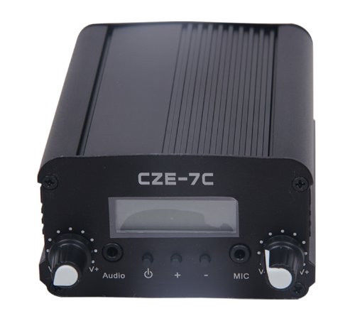

So next week I'm hoping to bring a portable FM transmitter along on a group bicycle ride, in order to bring a single music mix to dozens of FM radios and boom boxes on a group ride. After some research, I've determined that a 7-watt transmitter on the back of a bike trailer ought to do a decent job, hopefully broadcasting to radios in a ~500 meter radius––especially if we can mount our antenna up high. This is the transmitter I have in mind: http://amzn.to/1SMYqLV
My problem is, this thing comes with an AC adapter that spits out DC power at 12 volts, 6 amps. My question––and please excuse my ignorance––is this: Is there an easy way to power this thing using batteries? If so, how should I go about rigging such a thing up? I'm hoping to do this at a minimum of cost. The event should last about 3-4 hours, so I figure I'd need at least 25 amp hours of charge. (Do I have that right?)

Oops, looks like it's actually 12 v 2 amps. If that makes any difference. Like fewer amp hours of battery life needed.

If it runs off 12V, then a battery will provide this directly, however, a battery will provide very high currents if allowed which can cause damage and fires.
The battery connection should be fused close to the battery and all cables should be properly insulated and protected.
Make sure the polarity is correct.

The actual current required by the Tx will be just over 1 amp. Use 2 x 12v batteries in parallel of about 3-4 amp-hr.

Small 12v batteries are much handier to have around, easier to buy, cheaper, and will be lighter than a 7AH battery.

If the AC power adapter is rated for 2 A continuous duty, then the radio must draw less than that. 24 W of DC for a 7 W transmitter means that the unit is less than 30% efficient, a low number. 1.5 A for 4 hours is a 6 A-h, 12 V SLA battery. Digi-Key has a 5 A-h unit for $25, and a 7 A-h unit for $30. A lithium battery will weigh much less and cost more. An alternative is a replacement 12 V portable electric drill battery from Lowes or Home Depot. More money per watt that an industrial one, but you don't need an account with a distributor, you probably can buy a matching replacement charger at the same store, and you can return all of it if the battery if it doesn't work out.
Also, 7 W seems like a lot of RF power for less than 1/2 mile radius. A 3 W radio would cut your battery in half.

Your transmitter can be set to 1W output and that will be more than enough. Use an automotive-style whip antenna instead of the included telescoping one which is not suitable for mobile use.
There is a user review for your transmitter that warns of a pre-emphasis mismatch as the CZE-7C is hard-wired for 50μs as is used in most of the world and this will "muddy" the sound when listened to on US receivers that use a 75μs standard. If this is correct, this model may be a better option since it's designed for the US market, is less expensive and closer to legal for unlicensed use. It also comes with a rubber duck antenna so you won't need to buy a whip.
