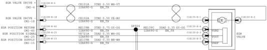

Helo, I am trying to create a circuit that will replace EGR valve on a car and make an ECU think that everything is ok.
I have already read this post https://maker.pro/forums/threads/help-to-design-egr-valve-simulator-cheater.244193/ but after assembling it and connecting to a car, it shows 2.8V constantly on the sensor output so to the ECU it seems stuck.
I have connected it this way. You can see what each pin means below.

This is how it is connected to the ECU:
1 - PWM-
2 - PWM+
3 - Position out
4 - Pos GND
5 - Pos Ref 5V
What I have already found out about my EGR is that the voltage range from the position sensor is from 0.7V (closed) to 4V (open).

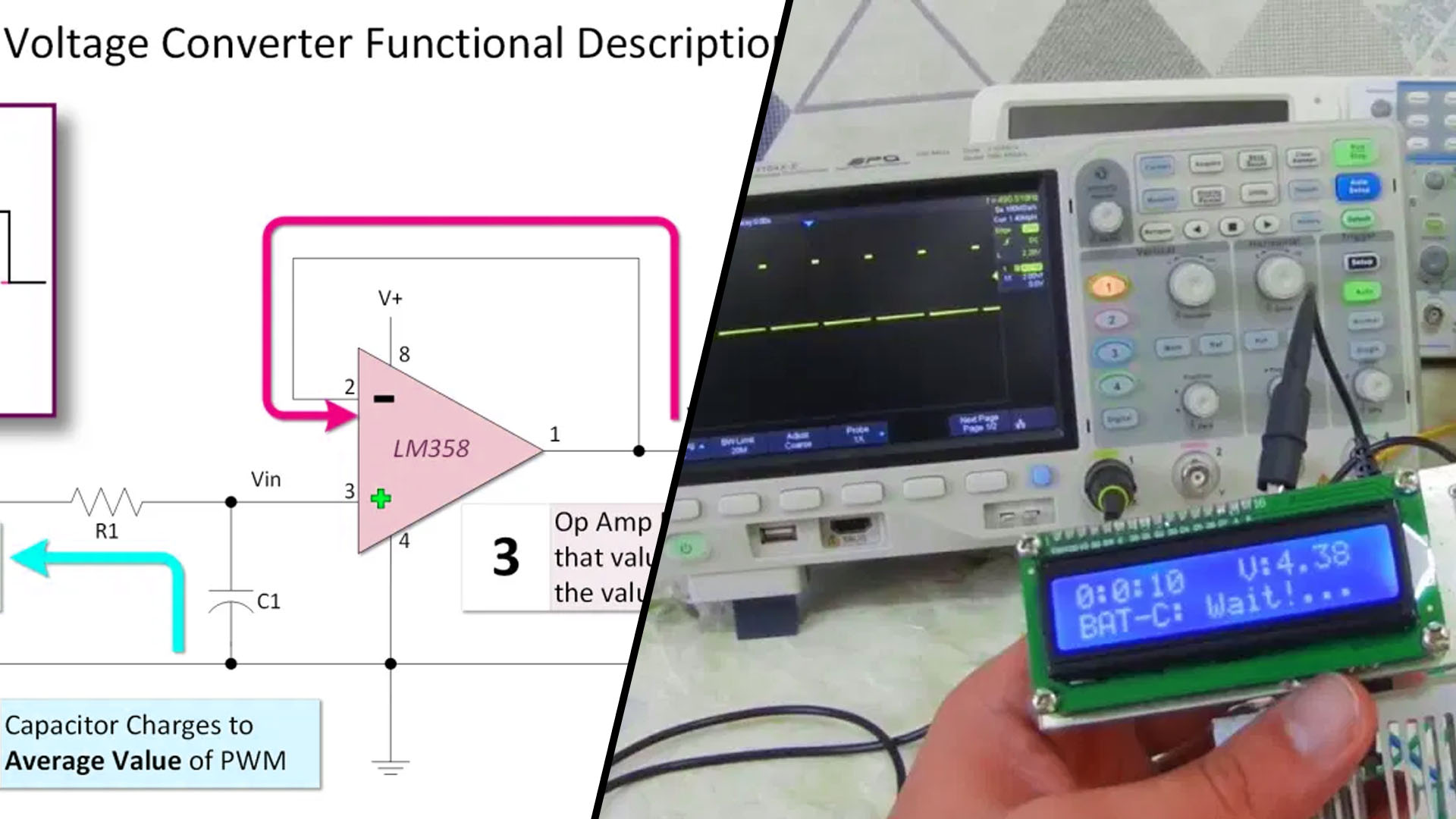

A PWM pulse stream will have an average DC value depending on the width of the pulse irrespective of its frequency so all you need do is rectify (if it was 'ac' - but in your case it isn't so no rectification needed) ) and smooth the pulse stream using a resistor/capacitor filter. This will give you a DC voltage that you can either use directly or 'scale' using a non-inverting op-amp setup.
See this link for some more details on what's happening....
The use of the op-amp gives you 'buffering' and the second op-amp in that package can be used to 'scale' the voltage if this is found to be necessary.
Try to plot the DC volts against the position of the motor (fully closed to fully open) and get back to us with the results. You can rig up a simple RC filter and connect it straight to your test meter.
