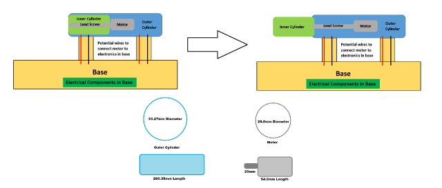

Hey everyone, just coming with an update on this. Appreciate everyone's help so far! I filmed a video to better explain what I am trying to accomplish. Here is the link:
Here is also a diagram to better explain as well (click on to zoom in):
Really hoping to finish this within the next two months as it is a birthday present. They would be amazed and absolutely love it! If anyone can help out it would be GREATLY appreciated.

OK, here is a simple limit switch circuit:
The diodes are arranged so they permit the motor to operate in the OPPOSITE direction once the limit switch opens the connection to the motor. They must be able to withstand the stall current of the motor (at least briefly) as the motor starts.
Applying power in one direction will drive the motor until the limit switch activates. Then nothing happens until the polarity is reversed. The motor will then run to the other limit switch activation.
All you need now is a circuit to swap polarity with each button press. There are lots of ways to do this.
The easiest way to reverse polarity is with a pair of relays. That way there is no chance of shorting out your power supply:
With both relays off or powered, the motor receives no power. Only with a single relay activated will it be powered.
Now all you need to do is have a circuit which alternately powers one relay or the other.
If you are using a toggle switch this is the easiest. All you need to do is have the toggle switch apply power to one relay coil in one position and the other relay coil in the other position, If you want to use a push button, I'd recommend a push-on/push-off switch because you can wire that the same way.
If you really have to have a momentary contact push button switch then you need more electronics.
edit: you originally specified a toggle switch, so that is easy!

I would consider using magnetic reed switches for their compact size as opposed to mechanical limit switches that can be cumbersome and difficult to mount on something like this.
You need to make make sure these limits are reliable because if the trip-dog missed them, the motor will keep running.
