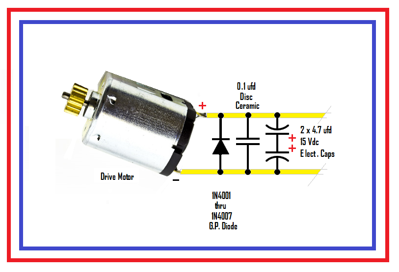

I made a 4 channel remote controlled toy car...when I press the remote spdt switch, the toy car move, but it continuously moving after releasing the pressed spdt switch and other spdt doesnot work meanwhile. After sometime the car stop then other spdt switch work...it happens with every spdt switch.Please give solution

Sir amjad daud . . . . . . .
Is my eyesight grossly failing me . . .or . . . . or . . . .or . . . .am I seeing a remote controlled board / plank there ?
You say the unit responds to your initial RF signal and starts the units propulsion motor running.
Now with us still being very cold on hard facts . . . . .yet, via maximum utilization of ESP . . . . .that motor is VEWY-VEWY likely going to be a
brushed universal type of drive motor.
In JUST considering forward motion of the unit and not yet being informed of bidirectional capabilities of the motor by you.
I am seeing the principal 4 channel board located at the far left and its then outputting into the central interfacing board, with LED activity indicators,
and then your hand constructed motor driver board to the far right, with what looks to be utilizing a single TO-220 cased driver . . .thereby . . .
providing a single polarity voltage supply to the drive motor.
Once you have keyed on the one channel that is feeding to the motor drive, (and its accompanying indicator LED on the middle board ( illuminates),
then assuredly that LED stays lit, while the motor is also remaining running . . .correct ?
Clue us in on the Receiver Decoder board at the left . . . . is it being a Cs EleSol Technologies product ?
How about firing up the unit and take metered DC measurement across the drive motor terminals.
Reasoning . . . . ??? . . . . . . to confirm the voltage polarity being applied to the motor.terminals.
With that then ascertained . . . . .a . . .la ........ . .
Relevant Techno Illustration:
How about your adding on the TRIPLE whammy shown above with a damping diode placed across the motor such that back emf rotating
commutator disruptions will be squashed, along with some DC and RF filtering provided by the two shunting capacitor types.
If a bidirectional voltage supply to the motor is later involved ( for reverse drive of the "board" ? ) we will have to change to back to back
zeners or a varistor type transient suppressor, for that initially shown single diode.

Now I am wondering if motor commutator arc is creating RFI trash and triggering your units receiver on ?
That units receiver is using a suppegenerative transistor circuit and it could be swamped by motor commutator arcs/ RFI . . . . being at that close proximity.
Now, try the add ons above to see if that actually might be what is happening .
