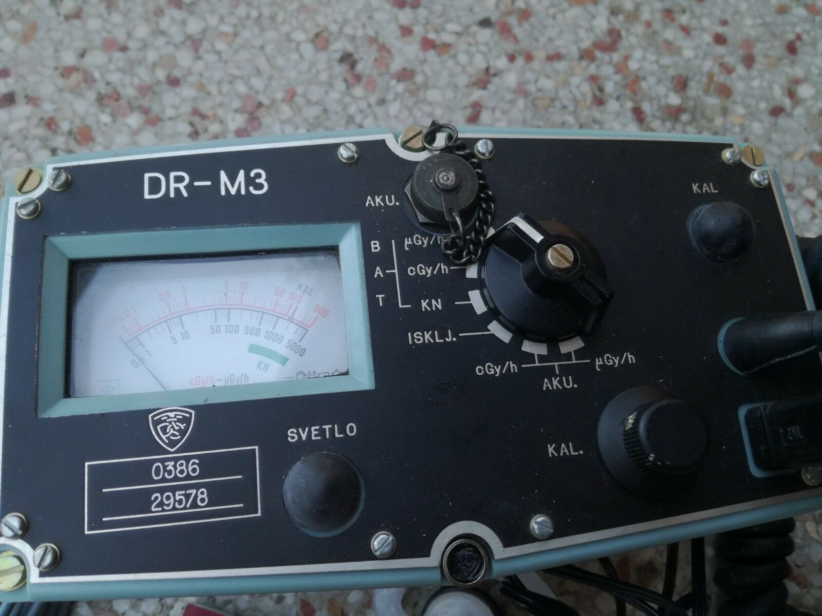

So, i got an old Yugoslav military radiation detector. The unit was produced in 03/1986 and when i put the batteries in it works, but i can see that it is struggling to give out accurate readings.
In the BAT bracket (battery powered 2 x 1,5V D) :
-KN - Battery control
-cGy/h - upper scale for use with the ionization chamber
-μGy/h - lower scale for use with the Geiger Mühler tube
-ISKLJ. - off position
In the AKU. bracket (powered from 12/24V car battery through an adapter)
The problem is while running on 1.5V batteries the battery control works fine (KN) and i tested the Geiger - Mühler tube on a radioactive source in the μGy/h position and it gives out accurate readings, the problem is the ionization chamber. when i try to calibrate with the KAL marking on the scale, the needle doesn't drop to 0 but stays at 0.5 (not 0.05), and i have also seen that when i leave the device turned on for about 10 minutes and i set it back to the cGy/h position, i get slight variations on the needle (sometimes it shows 0.5 sometimes 0.4)
here you can see that the device is working fine on the mikro-gray area (as seen in the video i tested it on a radiation source), but while operating in the high-range area (cGy/h) with the ionization chamber, when the device is calibrated as per instructions, the needle won't drop below 0,4-0,5 cGy/h - and it should drop to zero.

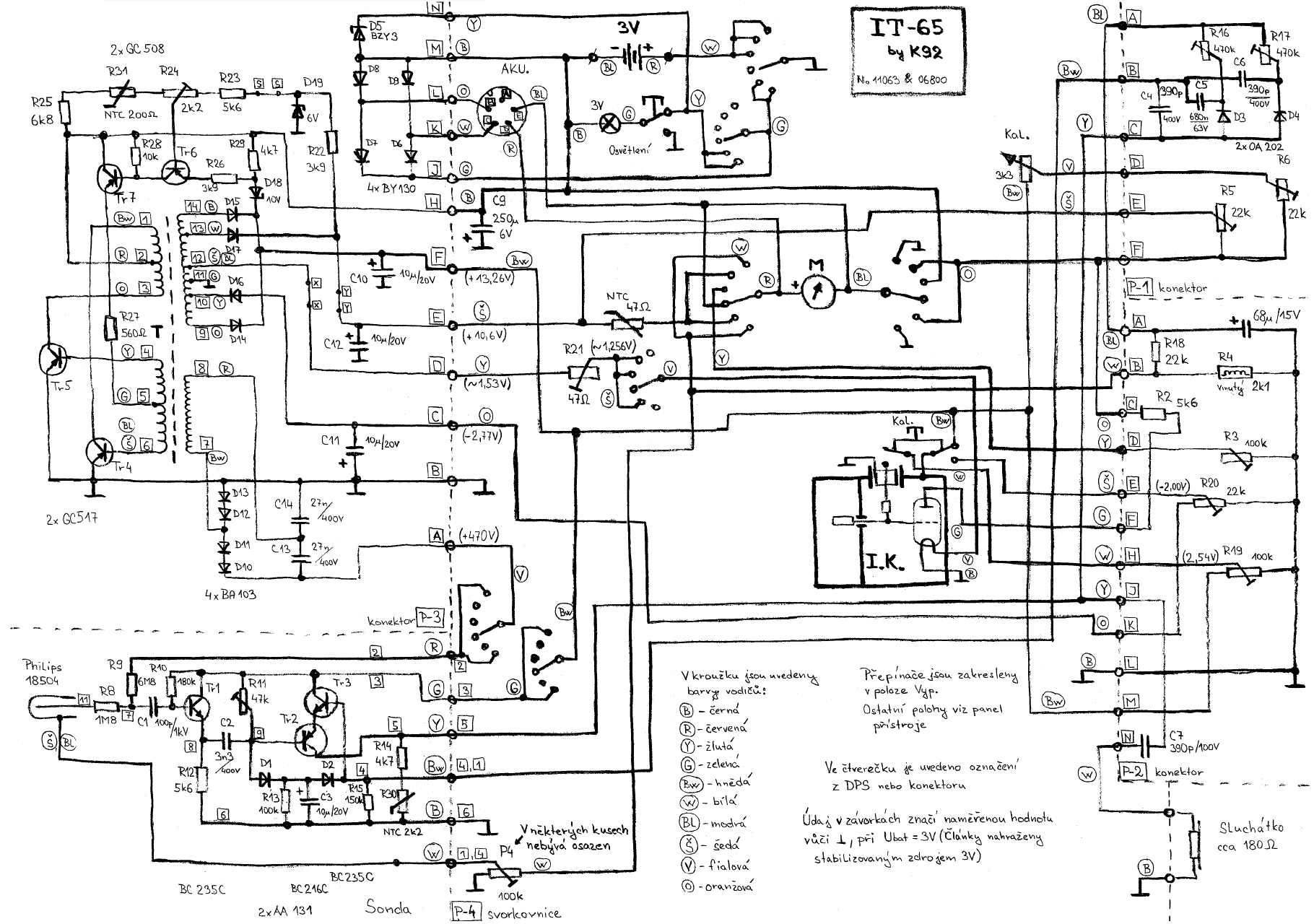

Schematic of the IT-65, the Czechoslovak copy of the DR-M3. The Yugoslav version has different circuits on the calibration panels and the power supply panel , so this schematic can only be used to see the layout of the fixed inner circuits of the chassis:

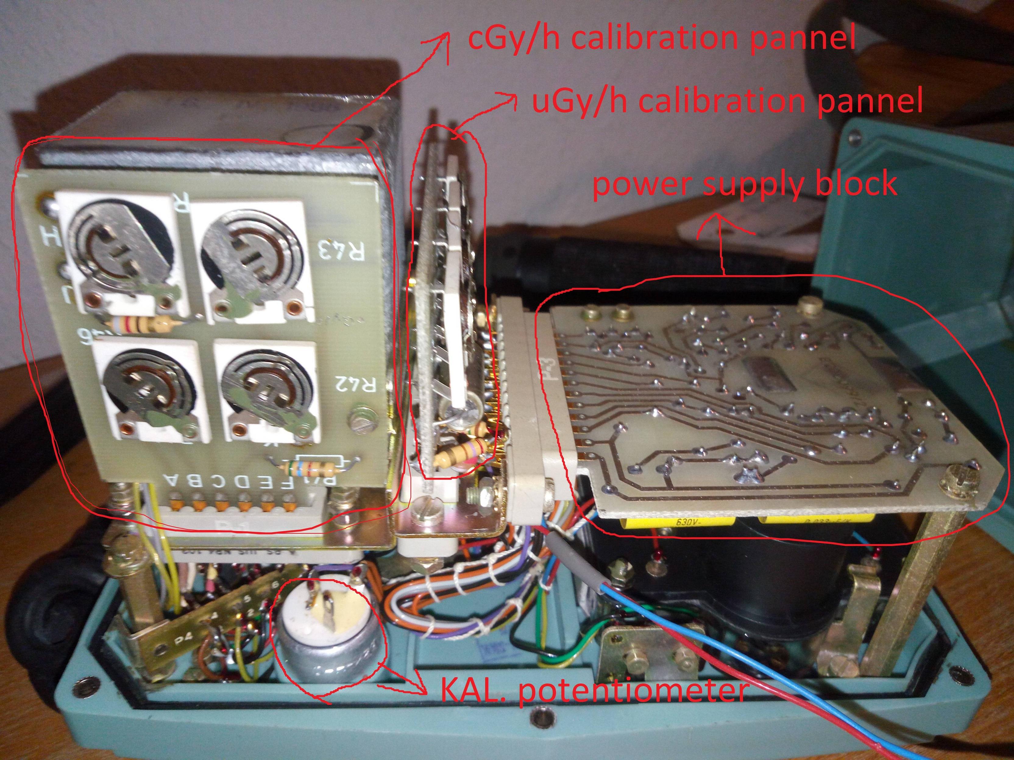

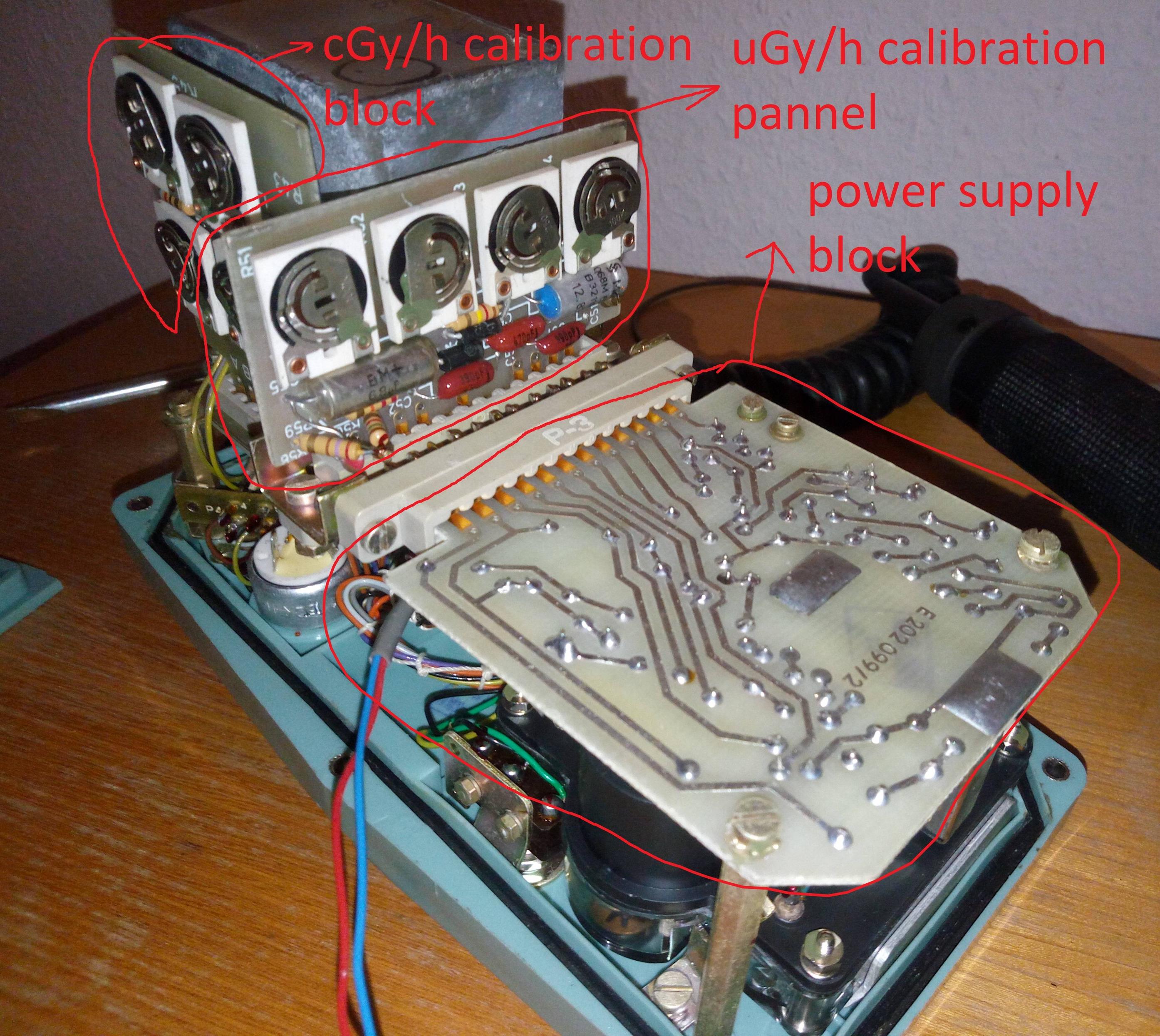

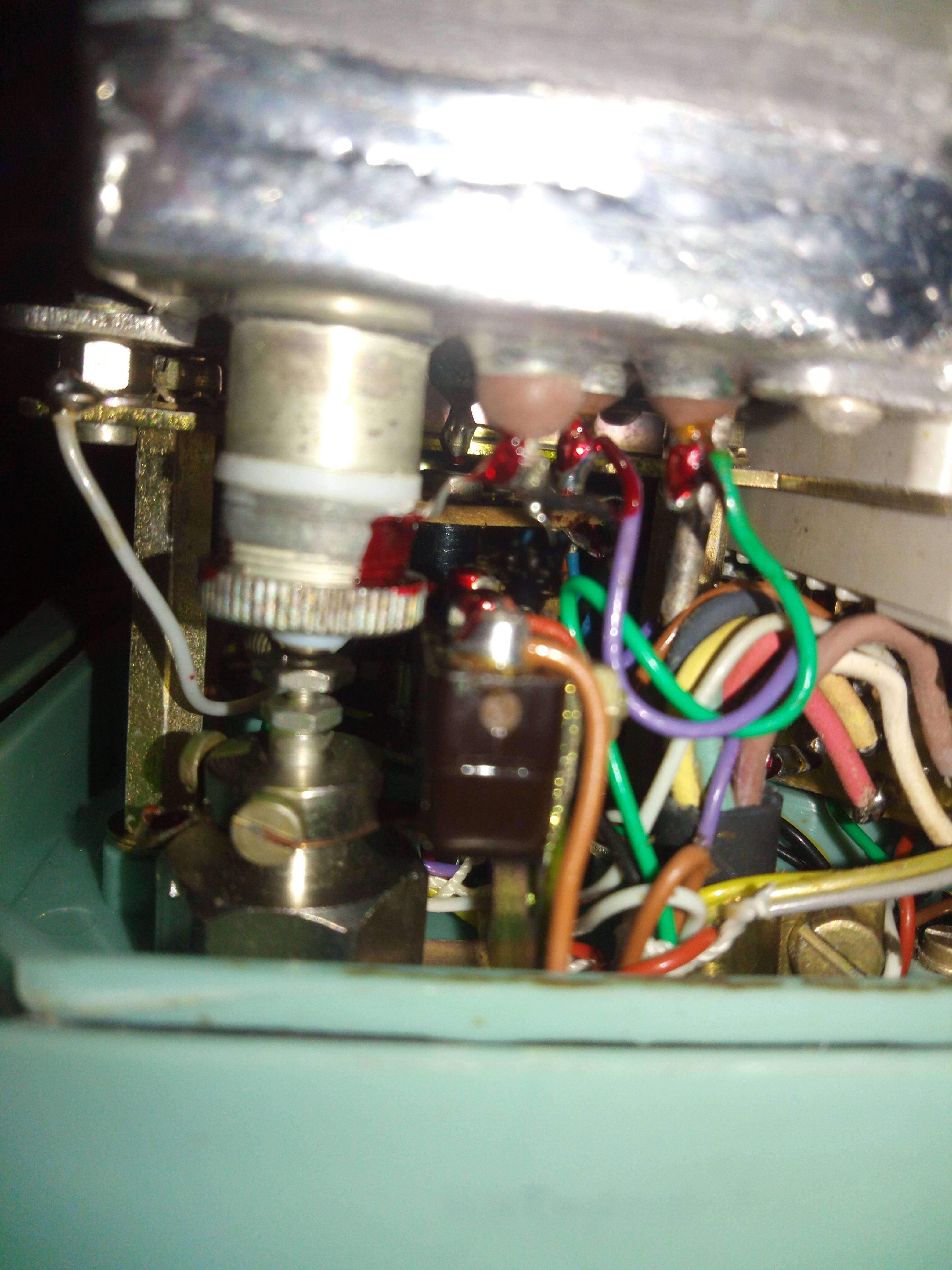

Here i also have some pics of the insides.

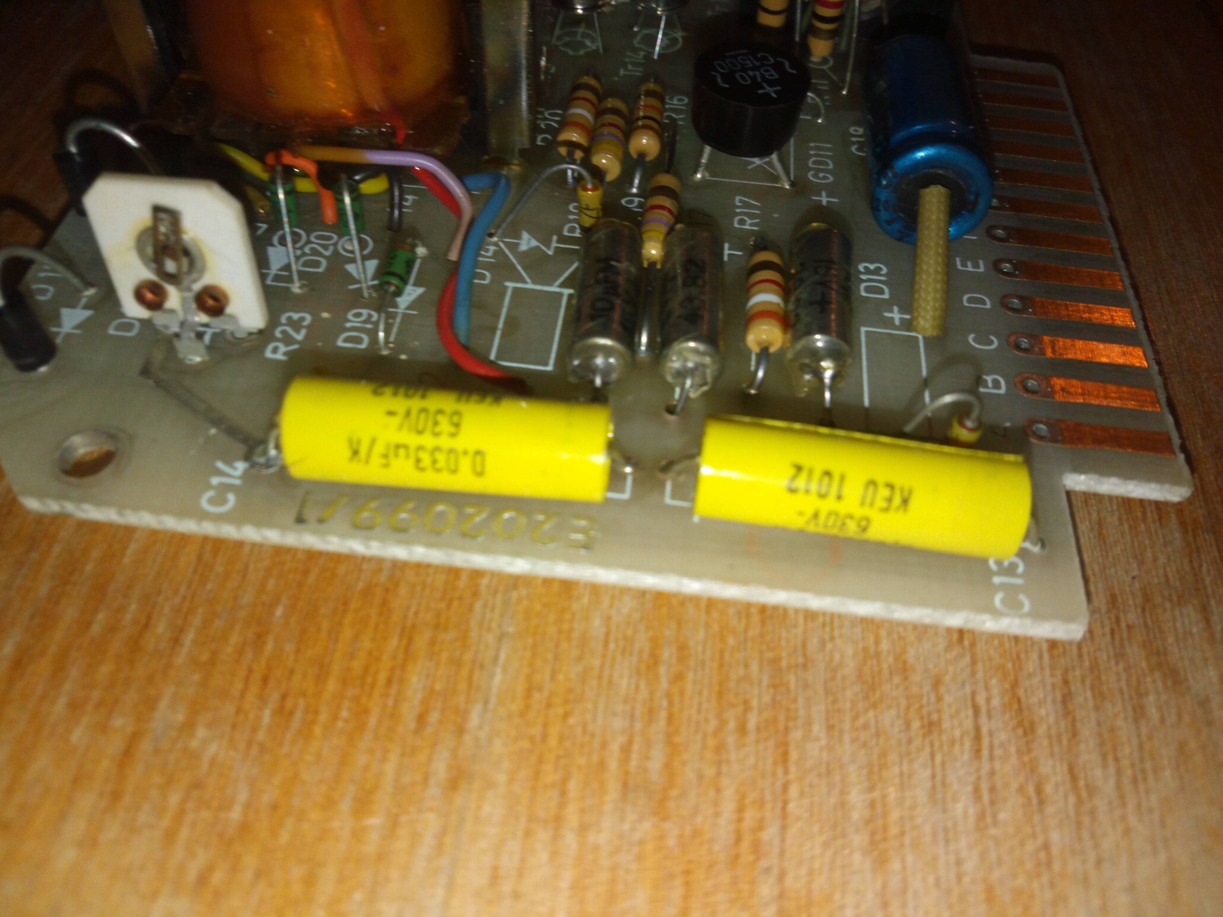

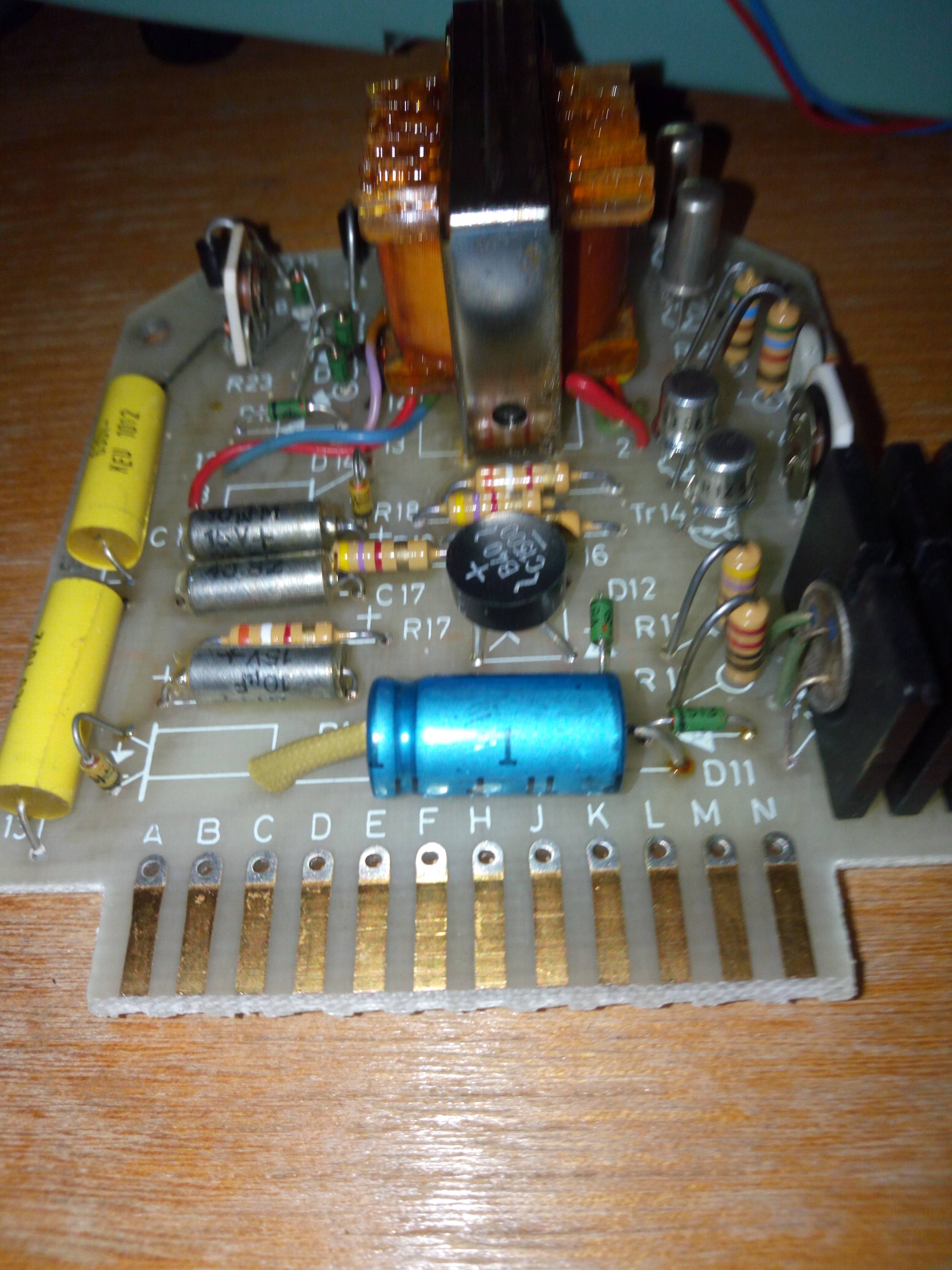

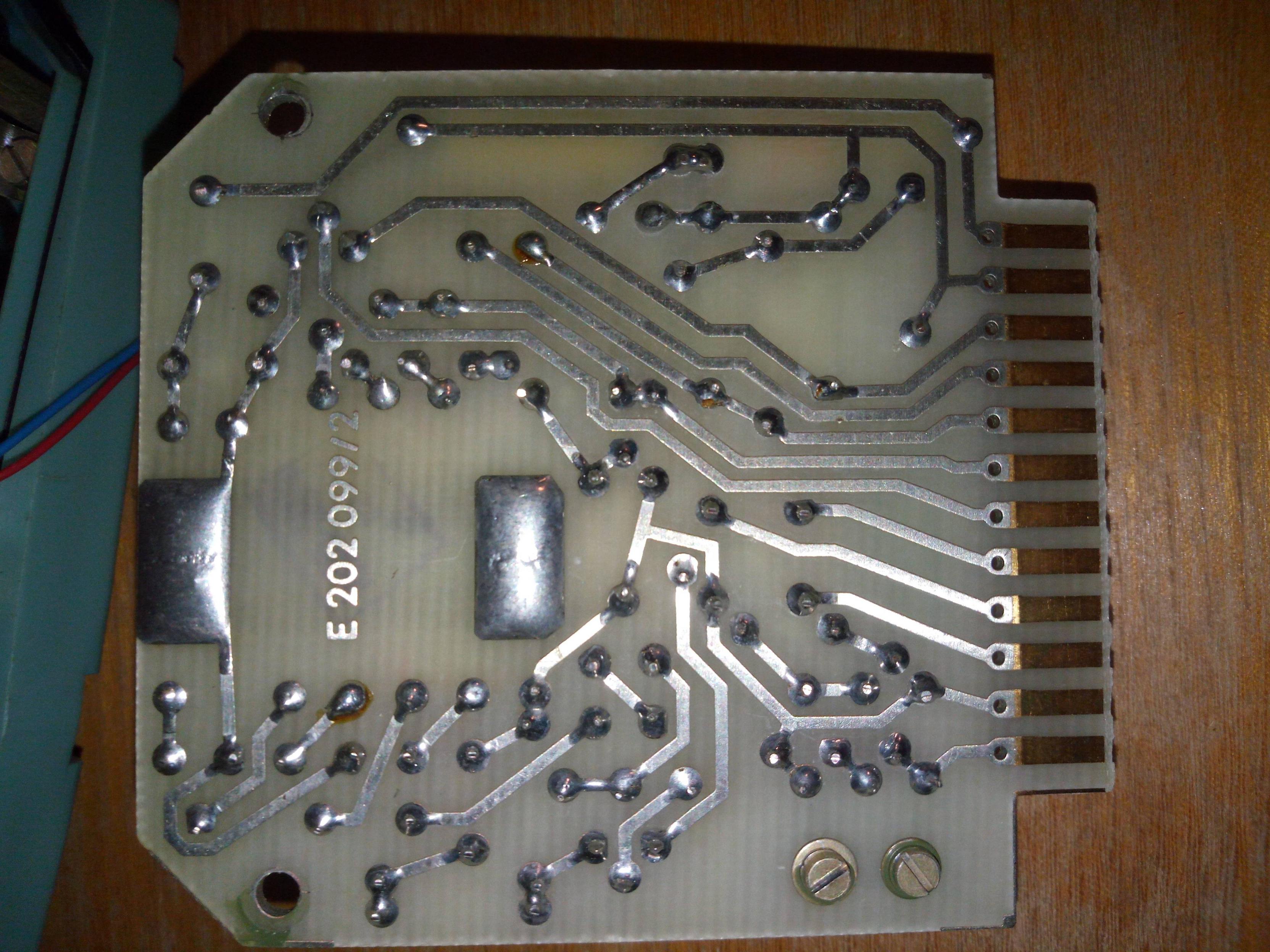

This is the power supply block:

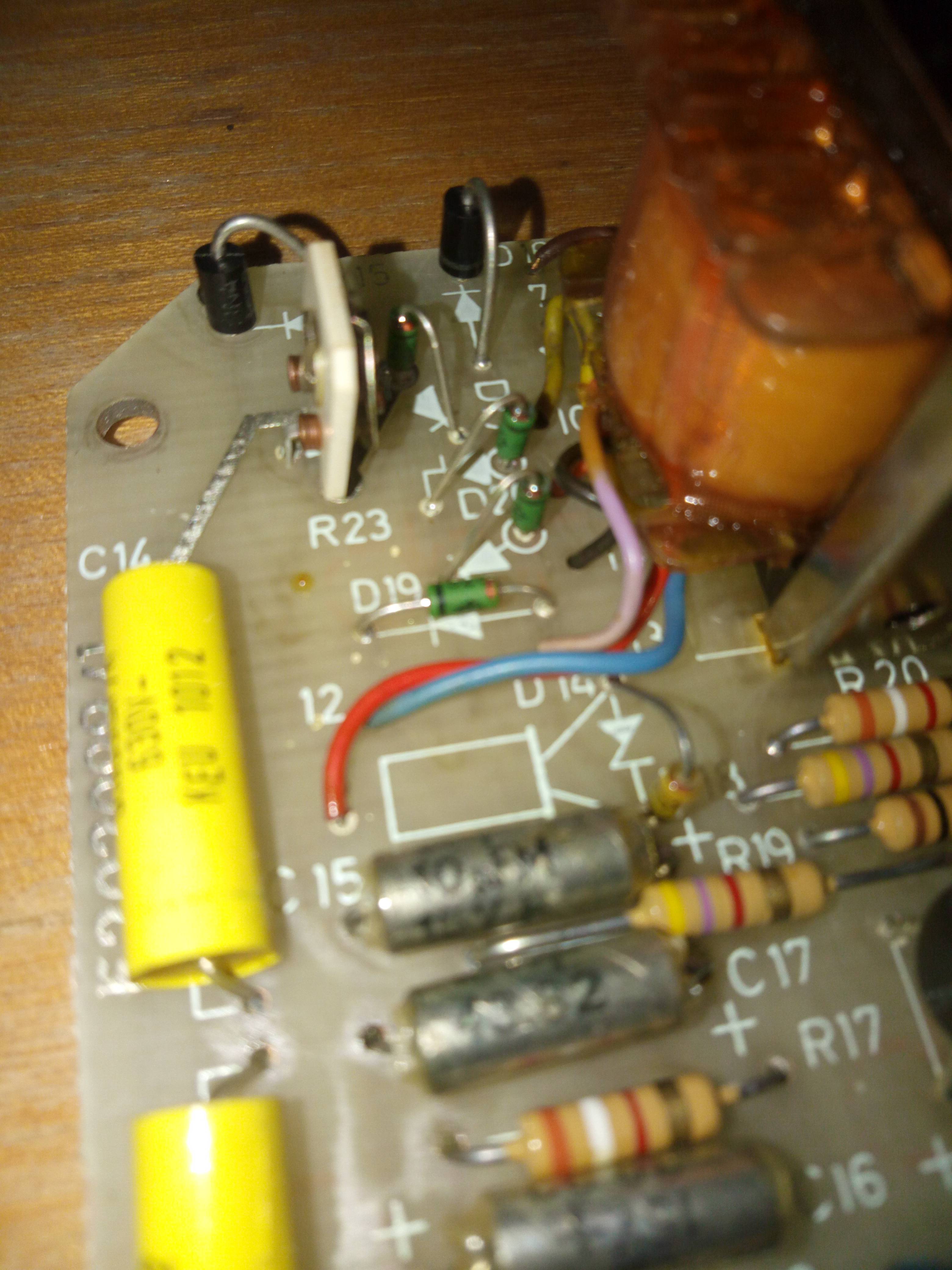

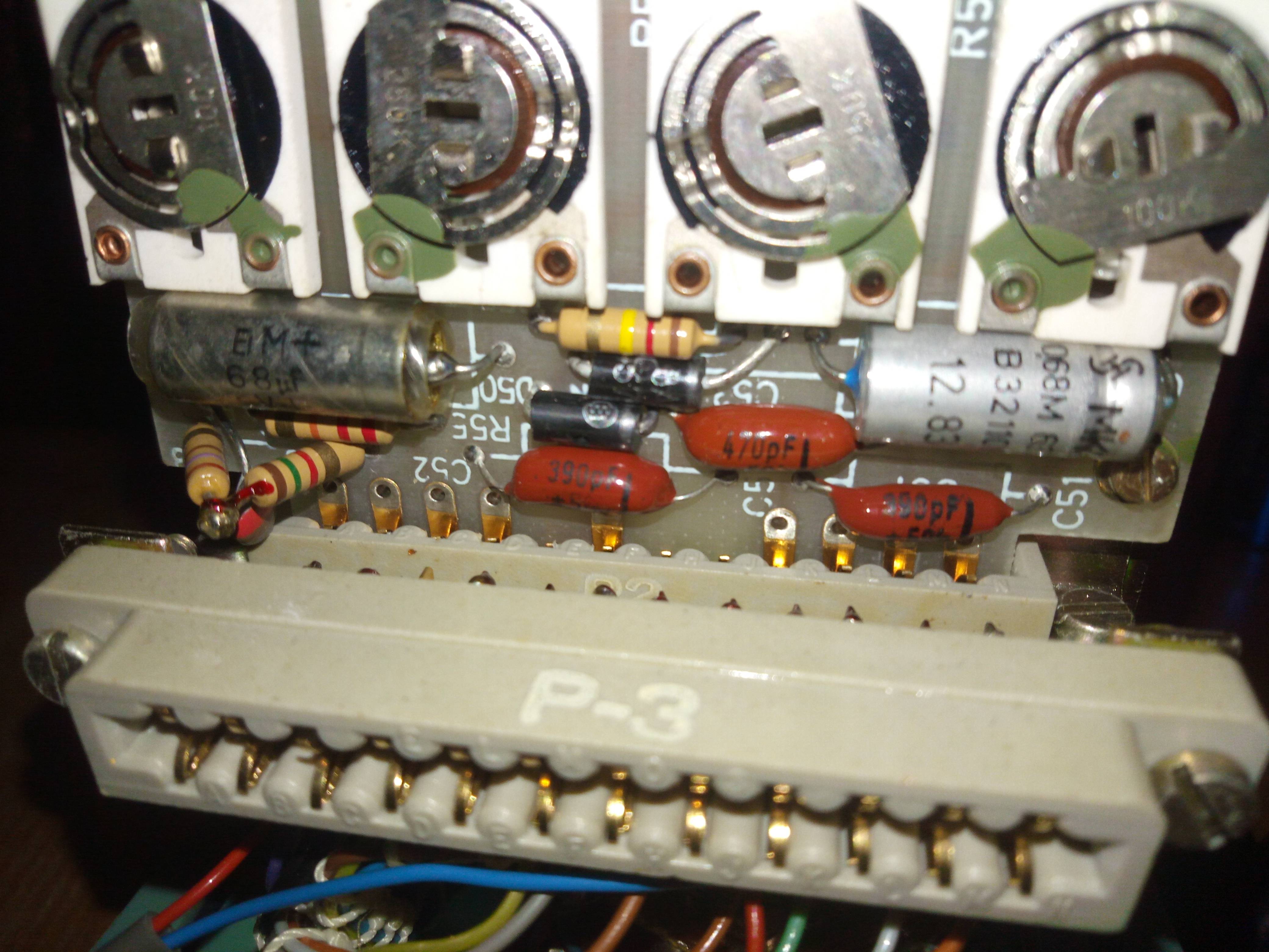

The circuit elements on the uGy/h callibration block:

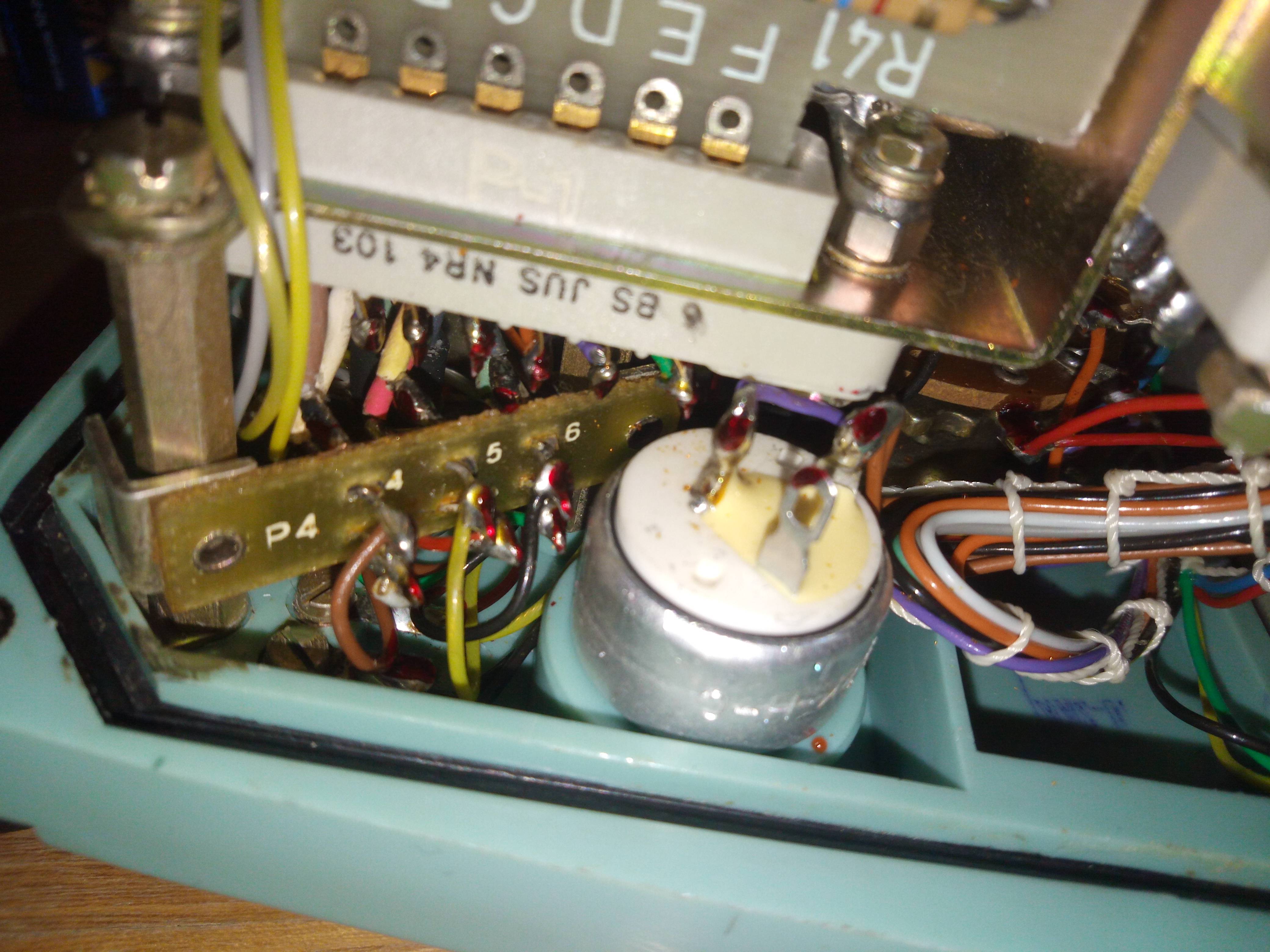

Underside of the ionization chamber:
What is your opinion on what could be causing the problem, that the needle doesn't drop to zero, but stays at 0,4-0,5 when the device is calibrated?

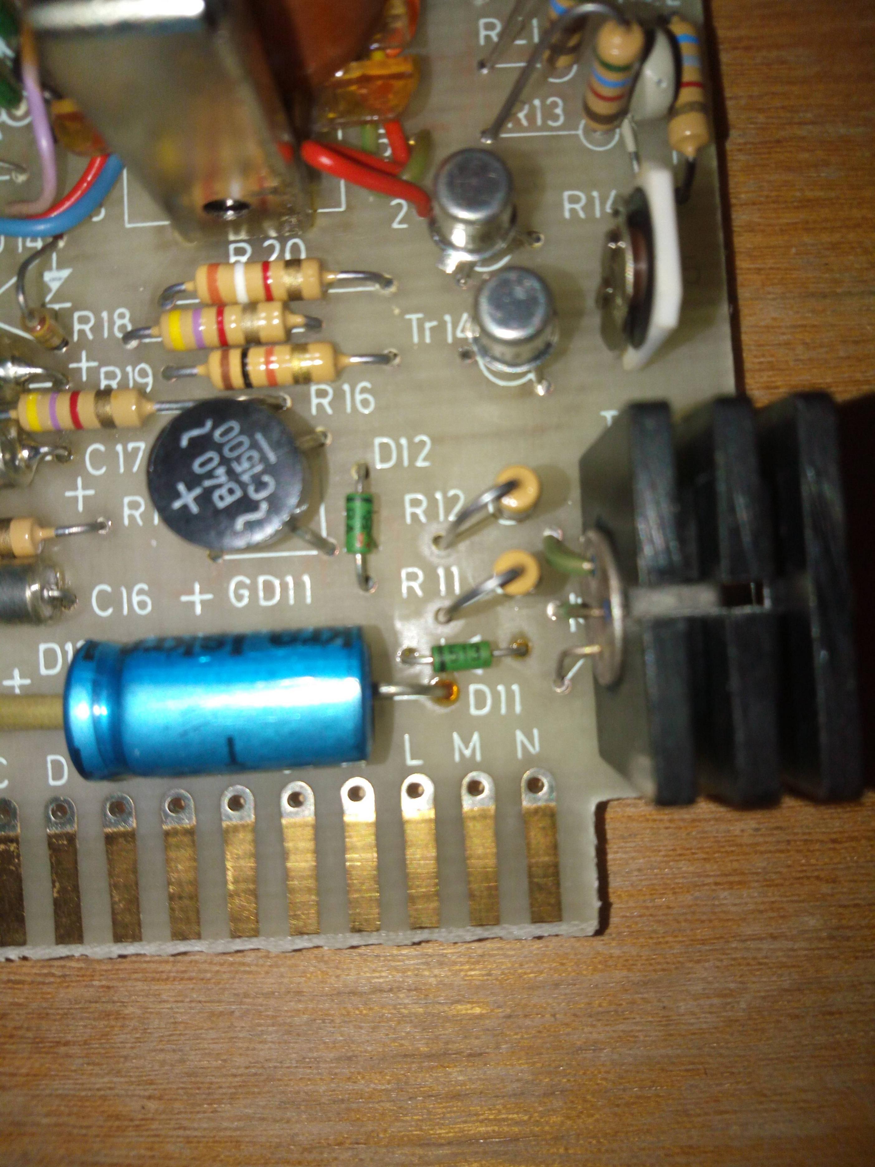

davenn
Sep 5, 2009
14,487
Sep 5, 2009
14,487
Do you think it would be wise to replace all the capacitors and then re-calibrate the device?
Just the electrolytic ones
eg ....
photo 4 ... the 3 silver ones to the right of the 2 yellow ones and the bigger blue one at the bottom edge of the board
Photo 8 .... the 2 silver ones

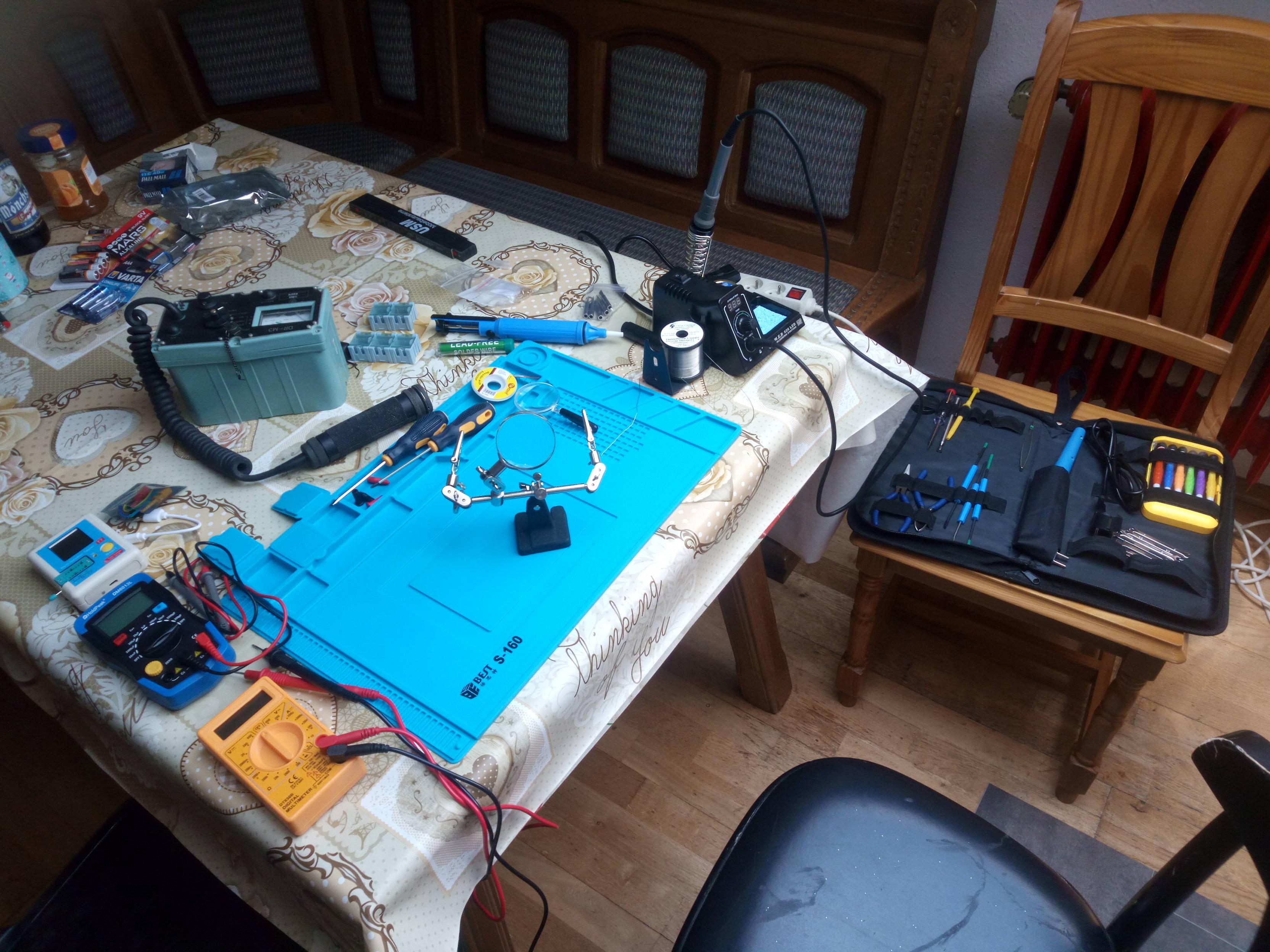

I got my wor karea ready... let's see what we can find...
I will take out all the electrolytic capacitors, also test all the resistors for their values and check for any suspicious elements (components with pinholes, discolorations, corrosion etc.)

Sir Lupus_Vulpes . . . . .
I just took a quick look at components and the units schematic and relevant design, and the most glaring thing I see is the units 1980'ish vintage and the units use of GERMANIUM transistors in the power supply . . . .in the schematics top left corner.
BUT ! at that time, the logic for that was the unit operating on a mere 3 VDC power supply, which must also be true on the step down of the 24/12 VDC supply down to that same level also.
All is well down in the GM det circuitry, just below, where they correctly stepped up to using silicon transistors in its design..
VOLTAGE TESTING . . . .
Why not use A Square test point for your DC metering ground and probe test points A-C-D-E and F Square test points to see how close they are to those voltage values given, with the unit being powered on.
H Square is the units main power, Minus 3 VDC, so check it also.
As far as the units build . . . .
I am looking at that unit with my learned and experieced eyes.
In addition to it being a virgin unit, the units components are top notch.
Good quality fiberglass board with nice serviceable trace sizes.
Trim pots built on ceramic bisques with fired resistance elements .
Liberal use of GOLD flashed connectors.
CAL pot is a QUALITY unit.
No old carbon composition resistors . . . all are being stable carbon or metal film units
Quality film capacitors used in the high voltage doublers C13 and C14.
The most critical capacitors in the GM circuitry would be the C1 and C2 caps . . . BUT . . . you say it works / tests fine
Looking around I see some AA131 diodes being used, ALSO BEING GERMANIUM . . . . BUT, being used for a lower sensitivity threshold..
Now moving over to the possibly problem related area at the schematic top right corner D4 and D3 are silicon types . . .GOOD . . . but the associated C4 and C6 capacitors should have no DC leakage.
Drop down to center right for the Ionization Chamber and its post amplifier, is using a low filament voltage micro peanut tube .
That should be all sealed up, but you can see where a switch connects to an internal resistor going to the tubes grid.
Don't think it will be a problem, but one would not want any collection of linters or dust that could become humidity dampened and resistively leak to ground, at that connection..
Every capacitor that I see, other than the two yellow film caps are being metal or epoxy cased and if metal, they even have glass hermetic seals on the end !
The electrolytic caps look to be PREMIUM tantalum slug radial lead units, also with glass seals.
Two exceptions seem to be the E cap on uGy/h cal board that has an end blue marking on it and is a Siemens brand, that just seems to be a plain vanilla electrolytic.
The other was over on the first mentioned, top left corners power supply schematic and is an all BLUE E- capacitor .
That's what I am seeing . . . . .

Situation report,
I removed all the electrolytic capacitors and tested them, the big blue one (C18) is definately defective, not sure about the other ones. I also tested the resistors, none of them drifted out of their tolerance values. I also found one more electrolytic on a CB inside the hand-held GM tube. i also de-soldered it.
Here are the results:
POWER SUPPLY BLOCK:
C18
C15
C16
C17
uGy/h Callibration block:
C55
C56
CB inside the GM tube:
I also got worried by this NTC because it looks like it has a small pinhole, i tested it and it showed 211 ohms, the resistance decreased while applying heat to it.
Now, the question is... what replacements would you recommend for those elements and where can i get them... :D

Ok, after thorough research, i managed to identify all the capacitors and their producer... All the capacitors except the Iskra electrolitic (big blue one) and the Siemens one are military tantalum axial solid capacitors made by "Elektro industrija Niš" (Ei), which sadly went bankrupt and they don't produce anything anymore...
What replacement capacitors would you recommend that are mil-spec to replace the old ones?

DANGER ALERT . . . . .DANGER ALERT !
I saw that you had the units GREY thermistor pulled and I NEED to warn you that it must be handled like a . . .? . . .? . . . . like a . . . .soap bubble.
It is being formed as a slug / disc with its polymorphous metallic amalgam, with it additionally , not being readily acceptabe to connections. So, they use either a high voltage vaporized and sputtered metal deposition in a vacuum chamber or they use a surfactally abraded compressing of a suitable conductive metal to each of its opposing faces to make solder connection capability..
Then soft soldering is used to connect 45 degree splayed wire leads to each of the prepared sides of the unit. ( HEY ! . . . . I see that they just put your leads on center and didn't go for the splaying. )
Then, it is either left naked or gets a conformal protective / insulative coating.
I see that yours got the coating . . . . complete with an errant air bubble. . . . no extra charge.
BUT the unit it is still QUITE delicate in handling or being subjected to the pressure of a distinct touch / bump.
SO when handling it, hold its opposite wire connector sides in a death grip, between finger and thumb.
I was so afraid that you would see that cracked paint on one leg and just have to straighten that lead and have the whole end connection come off in your hand IF not FIRMLY gripping it as I just mentioned.
THAT is being one item, that you would NOT, just pick up another one of easily.
BUT if you were worrying about it, in its design application and its degree of power involvement . . . . . . it is about 1000% power overrated.
Hoping that nothing has befallen the leads/end cap connection(s) already.
Moving on to the units E- capacitors. . . . . .
If you were to put one of my suspicioned two questionable E-caps in one hand and the one of the higher microfarad rated ,metal cased, tantalum caps in the other hand for a comparative weight evaluation, the common E-cap will weigh only a fraction of the premium tantalum unit
