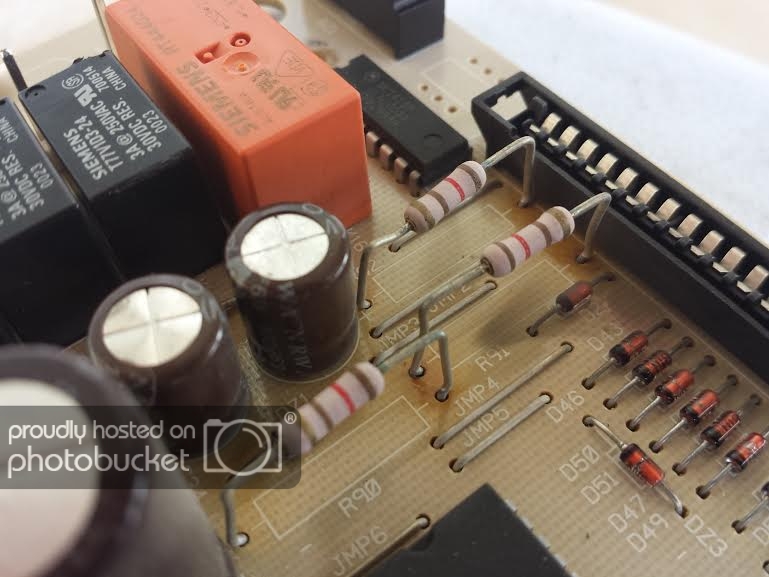

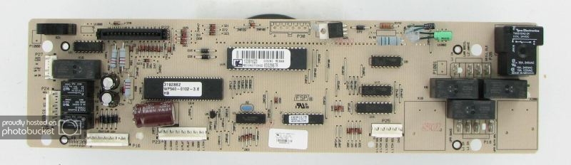

Hello everyone our oven is throwing an error code. The fix is to send the circuit board in for repairs. I would like to try and fix this myself to save money.
Another guy posted a thread and picture of a repaired circuit board and noted the 2 new capacitors in the upper right corner with the insulated leads and silicone. They are 2.2 and 33uF 50V capacitors. I bought some 100v caps from digiKey and installed them right now but it didnt fix the problem.
Can i manually test the circuit board with a multimeter and determine which components i need to replace? My electronic knowledge is primitive but im eager to learn. Thanks for any help!!

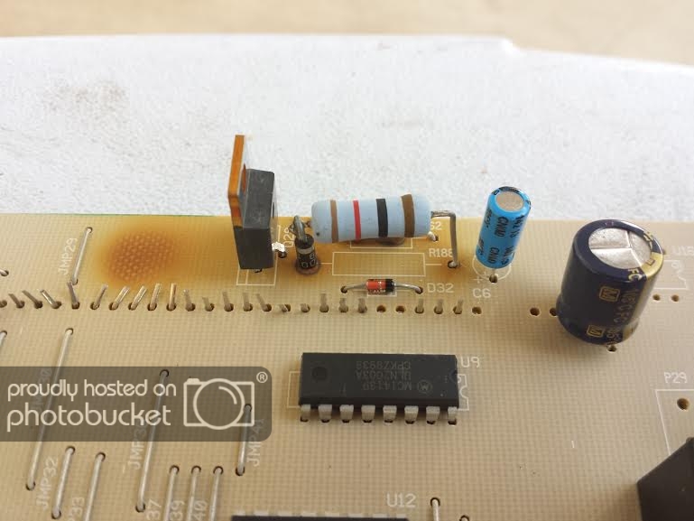

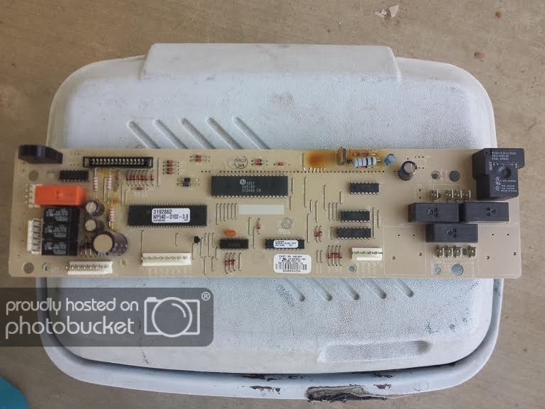

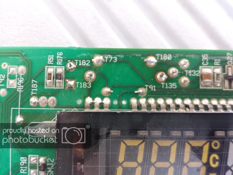

Thanks i was not aware the capacitor can shock me after disconnecting. I feel dumb for not noticing this earlier. The big blue resistor is loose at the solder pads #183 and 135.
Some of the pics are posting upside down sorry. I rotated and saved them on photobucket but its still wrong.

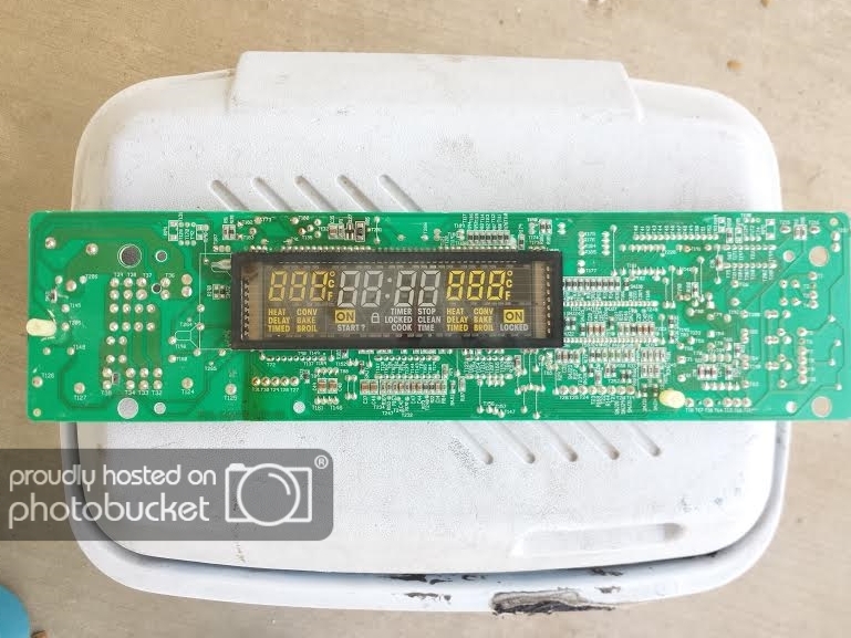

I couldn't help but chuckle seeing this XD
If you gave us your very first example picture to troubleshoot I'd be stumped... but these pics show not just one, but 4 at least that I can see right now, parts that have potentially cooked themselves.
Have you gotten a quote yet for a new board or for repairs?
My opinion on this so far, is that you will need to put more work into this to be able to properly follow the traces on the green side of the board. The screen on there is covering a good portion of it. It appears to be soldered on from the top only, but I would advise against lifting it as the leads could break off, and that part does not look cheap. I also noticed that the leads from the display panel are bent, but only near the large TO-220 looking item. (Q2x?) It also appears that this same part was at one point laying on it's back and is now lifted. Was this done by you, and did you notice it making any contact with those bent leads from the display panel?
I would really like to suggest you sending this one in, as it looks as though multiple components are / could be at fault which could make troubleshooting a little more extensive. Many may suggest just swapping in new parts for the ones that are burned / discolored and repairing the solder joint for the large blue resistor you pointed out. This is not always recommended though, as there could be an underlying condition that caused those parts to fails, and putting new ones in may just kill them right away ;) It's that and the fact that this is not a battery operated device that is typically recommended for learning with...

Ive tried to be gentle with the board i think the leads were already bent. Is the TO-220 looking item just to the left of the big blue resistor? That one was standing up it has 3 leads. The one closest to the blue resistor also has a loose solder joint.
Tried to fix it but i think the solder pad might have separated from the circuit board. I soldered it but it popped back off. Its $150 to send in the circuit board for repair. Can they fix the solder pads or is the entire board toast now? Their website says they send it back if they cannot repair it. The part is no longer available from the factory but you can buy refurbished ones for around $250.
edit: forgot to say i tested the resistor and it was 12.3 touching the wire next to the blue body. But when i flipped the circuit board over and tested the other side i got nothing. The resistor has that little black piece coming off of it. Is that broken maybe?

The TO-220 is the device to the left of the big blue resistor, and seems to me like it was laying down due to the discolouration on the board that appears to line up with where that part would sit if it was laying down.

I think it's possibly more likely that whatever is on the board on the opposite side to the discolouration got hot. Maybe too hot.
I thought about that. Would be Q27 far right hand of the close-up of the board side above the display, but it had in interesting shape that made me think the TO-220 package was at one point laying down.
Regardless I still think that considering the apparent damages to the board this may not be a project that a beginner should learn with.
You may end up spending the time on the board and needing to buy a new one anyway, and you will be working with dangerous voltages to learn on.

What are the markings on the TO-220 device? (The three-lead device standing up.)
What are the markings on the diode (black cylindrical thing with silver or white stripe on it) that's standing up just in front of it?
What is the component that's hidden behind the big resistor?
Can you clean the crustiness off the underside in that area so we can clearly follow the copper traces, and take a zoomed-in picture including the whole discoloured area?
What kind of oven is this from? Brand and model?
Does the error code come up immediately when you power it up? If not, what do you have to do to make it come up?
Does it do anything at all? Or does it just throw the error code and play dead?
Have a good close look all over the board for dry joints and anything suspicious. I wouldn't assume that the problem is necessarily in the area you are focussing on. Discoloration is never a good thing, but it doesn't always indicate a problem.
