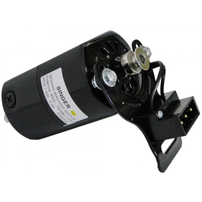

I have a Singer Sewing machine - model 190 - and a problem I have with it is that its motor has too much RPM and quiet low torque - as a result, its stitching too fast for me, and it could hardly rotate on lower speeds...
So, I am hoping to replace its motor with something of higher torque, and lower RPM..
I'm thinking somewhere between Servo Motors and Stepper Motors
-what can you suggest?

The problem with increasing power, you may stress other parts of the machine if you end up over taxing it.
Traditionally the motor has been a Universal motor on sewing M/C's, Do you know the technology of this one?

i'm not looking to overpower it, i'm happy with what it can sew.. what i'm not happy about when i press down the pedal is that the initial rotation feels like its stalling, then when i press harder, it suddenly bursts stitches to a speed thats a little hard for me to control. - whats ideal would be if it can still rotate even in slower speeds - not necessarily stronger. I observed i could actually stall the motor by hand if i hold the wheel holding the bigger pulley - a weak motor.

Well that explains it a little further!
The motor technology is needed in order to take it further.
AC ?,DC?, Universal? etc.
Acording to Google it is Universal.

Universal motors are hard to control accurately without feedback, but if the present M/C method is a variable resistance pedal, you may get an improvement with one of the simple Triac controllers and follow it with a bridge rectifier before the motor.

yes, the one it currently has isn't too different from the picture you posted - the standard motor for Singer Sewing machines. Mine is a 220v version.

Before changing the motor I would try the Triac method, if you are able to, there are many designs out there via Google etc. And simple to build with just a few parts needed.

When I've seen sewing machine operators use similar systems they always, and I mean always, start the sewing by manual rotation of the wheel as they press the pedal. This gives the motor the starting torque necessary to prevent it over-speeding when you 'get your foot down'.
Could simply be a 'method' is needed rather than a solution.

Google Triac 220v motor controller.
In place of the motor place a bridge rectifier with the AC in and then wire the motor across the bridge +ve & -ve.
The 220K with be your foot pedal pot.
M.

With the Singer universal motor you don't need a bridge rectifier with the Triac speed controller.They work on AC or DC.

Being a Universal motor I realize that.
The motor runs that more smoothly on DC.
