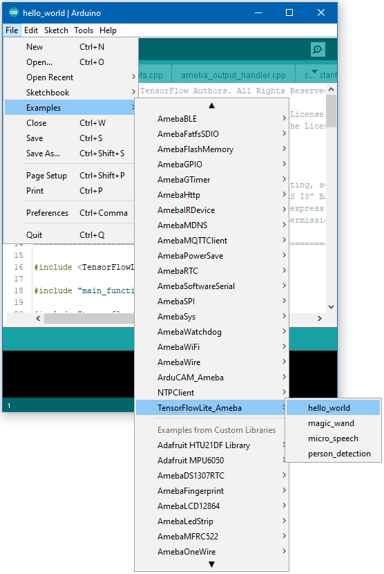

Example Guide
Download the Ameba customized version of TensorFlow Lite for Microcontrollers library at ambiot/ambd_arduino.
Follow the instructions at Arduino - Libraries to install it.
Ensure that the patch files found at ambiot/ambd_arduino are also installed.
Open the example, “Files” -> “Examples” -> “TensorFlowLite_Ameba” -> “hello_world”.
Upload the code and press the reset button on Ameba once the upload is finished.
Connect the LED to digital pin 10 and ground, ensuring that the polarity is correct. You should see the LED fade in and out rapidly.

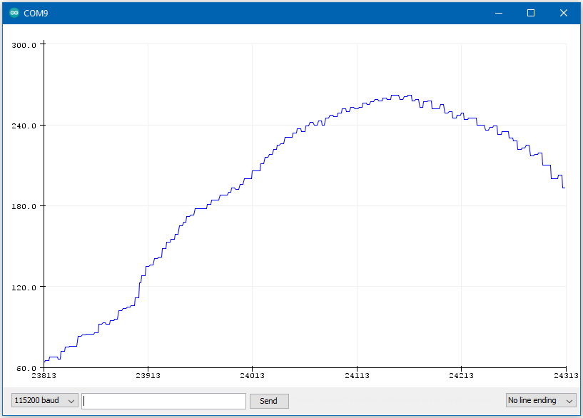

In the Arduino serial plotter, you can see the output value of the Tensorflow model plotted as a graph, it should resemble a sine wave.
