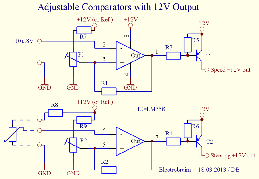

Hi all, require help with a project I am working on. I have a input voltage of 0 to 8v DC (on a speed sensor output) I need to select a voltage within this range (0 to 8v) and when the voltage is reached will past a 12v signal (voltage) on to a relay.

I have build a active aero wing for a car. I required the tilt function on the wing to work once the car is travelling a 60 Km/Hour (no sure what that is in miles). So getting a reading of the voltage from the speedo wire which can be between 0-8 votes, I would like this to be adjustable so it can be set at different speed if necessary. Once the voltage that is set is reach it can then pass a 12 volt signal to activate a relay.

Also I have to work a way to get a steering angle signal that works on a 5 volt 10 turn penetrometer (already have penetrometer ) That when the voltage is greater the x volts (with centre being 0 volts) it can then pass a 12 volt signal to activate a relay
The relay control part of this is already done, I really required a way to get the low voltage devices to give a volt signal to the relays I have installed to control the wing.

1. You just need a simple comparator circuit. I suppose you need some hysteresis as well?
2. Do you really mean "penetrometer"? I suppose you mean potentiometer.
It's not really clear what you want, but it sounds as if you want the same type of circuit as in 1.

Here is a "bare bone", very simple and cheap circuit that should work well for your application (though I did not test it).
R1 and R2 add hysteresis to the circuit, so that you don't get "chattering relays" from the outputs. The hysteresis varies a bit with the position of P1 and P2.
Down very near 0V set points, the circuit might not switch very well. If you really need that region as input, the circuit could be adapted a bit (by creating a virtual ground).
Also if very high accuracy is needed, you could use a reference voltage instead of the 12V supply.
The IC is given, the other components can quite easily be calculated (good task). R1, R2 are "big" (Mega-Ohm).

Hi thanks for the diagrams this looks like what I need exactly Will try to work out the resistor values form my limited knowledge of electronics. I thinking that R7,R7 drop the voltage for the P1,P2 Pots and R8 does the same for the Steering Pot.
Add a picture of virtual ground that could be incorporated to supply 5v to the diagrams

If your steering pot is a simple potentiometer, you don't need any 5V power source. You just adapt R8 so that the voltage drop over the potentiometer is whatever you like it to be (for instance 5V). But first you need to know the value of it. Read what is written on the potentiometer or directly measure on it.
The circuit diagram you show is a good way of making a split power supply with a virtual ground.
In your case, you would just need a few added resistors to push up the 0V input signal a little. But I doubt that the circuit even needs such "surgery".
