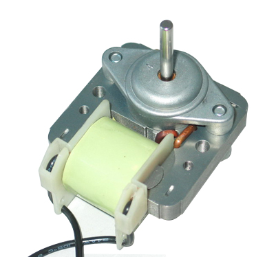

Hi, I'm new here.
We have an oven with a shaded pole AC fan motor - 120VAC, 40W, 3K rpm (the inserted photo is very similar). Since the oven manufacturer cheaped out big time, the plastic fan wobbles badly, generating a very loud vibration noise. I'd like to slow the fan down. I figure that 50-75% speed will eliminate the noise while still providing the cooling the oven requires. I tried a ceiling fan speed control, presumably triac based, but it works too well, slowing down to about 25% speed. While messing with that, I discovered that the fan slows way down when my bench vise jaws clasp the magnetized stator. Further experimentation revealed that any sizable ferrous metal also slows it down. I'm sure I can find just the right size to bring the rpm down to the range I want.
My question is: Will the shaded pole motor be happy with this chunk of metal attached, or will it overheat or otherwise fail?
Thanks in advance,
Tenaya

Shaded pole motor speed is frequency dependant.
To answer your queries, any mods you suggest will probably damage the motor in some way, either heat destroying the coil , dry out the bearings and sieze.

Thank you for all the responses.
My original plan was to use a fan "dimmer" with a variable resistor, but I live in an electronics desert (smallish town) and the only one I could buy off the shelf was 3-speed: Off-Hi-Med-Lo-Off. I don't know for sure, it's riveted closed, but it probably uses a triac circuit. Hi is clearly full speed, Lo appears to be about 25% speed and Med seems to be the same as Hi for some reason (the low power draw of the fan?). My estimate is that 50-75% speed will provide sufficient cooling, AND decrease the vibration enough to reduce the noise to a tolerable level.
I'd still like to pursue the idea of placing two pieces of steel along the stator, one on each side. My uneducated guess is that adding steel in this way changes the magnetic characteristics of the stator, limiting the speed at which it can spin the rotor. Using cut-and-try, I can determine the sizes to achieve the desired speed reduction, but I don't know enough about how these motors work to understand the long term effects of doing this. Since I have a complete spare fan/motor assembly, I'm tempted to hack it all together to see what happens after running for several hours.
Does anyone have a better understanding of this variety of shaded pole motors and what my proposed modification might do?
The vice jaws acted as a magnetic shunt, so that less magnetic flux passed through the rotor. I don't think two separated steel additions would have the same effect.
Tenaya
That is not going to work.
Also the stator is designed to work with the shading ring for phase control so you also could upset this arrangement.
I would open the 'dimmer' and replace the switch with a pot.
Hmm. In my ignorance, I stumbled onto the whole magnetic flux thing by clamping the stator between my bench vice jaws to hold the fan while I ran it with the "dimmer". When 120VAC was applied without the "dimmer", it ran really slow. At this point, I thought that the vice was somehow distorting the stator, which also forms the mounting frame for the bearings. When I re-clamped on the mounting sheet metal, the fan ran at full speed. While clamped this way, I laid a pair of pliers against one side of the stator, the pliers was magnetically attracted to the stator, and the fan slowed down noticeably. I'm extrapolating from that experience to using two pieces of steel, adjusted for size and crafted in such a way as to stay in place. My thinking is that if the steel can "bleed off" enough of the magnetic flux, I may be able to achieve the speed reduction I need.
Hacking the "dimmer" is certainly an option, but I'm trying to avoid it. The oven takes 220VAC from the wall and the 120VAC needed by the fan motor comes from, and is switched by, the control panel. It's not at all clear how the control does that (one hot to neutral, step down transformer or . . .) and how the controller will react to the "dimmer". The controller may well not care. In any case I'd really prefer not to release the magic smoke from the oven's most expensive single component. Even though the oven is loud, it does still cook.

The fan is driven by AC and so there will be an altermating flux in the stator. It is unclear whether the solid steel will increase the inductance and so reduce the current or give a shorted turn needing higher primary current and heat in the shunt. To get over this, use laminated steel from an old transformer.

At this point, I thought that the vice was somehow distorting the stator, which also forms the mounting frame for the bearings. When I re-clamped on the mounting sheet metal, the fan ran at full speed. While clamped this way, I laid a pair of pliers against one side of the stator, the pliers was magnetically attracted to the stator, and the fan slowed down noticeably. .
You could we be affecting the optimum phase shift caused by the shading ring, if so you could cause extra heating.

The 3 speed control is likely to be a switched capacitor arrangement, very common these day. Designed for 60w split phase fans, not shaded pole motors.
