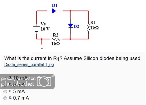

Im having trouble figuring how to find the current in the diagram below.:confused:
A atrix370 Dec 8, 2014 2 Joined Dec 8, 2014 Messages 2 Dec 8, 2014 #1 Im having trouble figuring how to find the current in the diagram below.
duke37 Jan 9, 2011 5,364 Joined Jan 9, 2011 Messages 5,364 Dec 8, 2014 #2 What is the voltage across R1?
Harald Kapp Moderator Moderator Nov 17, 2011 14,317 Joined Nov 17, 2011 Messages 14,317 Dec 8, 2014 #4 atrix370 said: Im not sure is it 10-0.7=9.3v? Click to expand... Definitely not. The voltage across components that are in parallel is always the same, therefore V(R1)=V(D2)= ? The voltage across components that are in series add up, therefore V(D1)+V(R1)+V(R2)= ? Hint: Kirchhoffs laws apply.
duke37 Jan 9, 2011 5,364 Joined Jan 9, 2011 Messages 5,364 Dec 8, 2014 #5 You obviously know that D1 drops 0.7V when conducting. Quite correct. So what voltage will D2 have across it when conducting?
