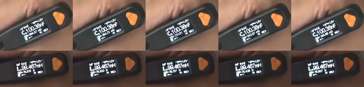

Recently in different forums a lot has been said about different smart tweezers RLC/ESR, measuring the parameters of electronic components at different frequencies.
Naturally, they all have their own characteristics and price.
I will compare these two tweezers, because they have a frequency of 100 kHz and high resolution.
If you look at two tweezers, you can clearly see that the Canadian tweezers are almost two times smaller, have a bright display and very accurate, high-quality gold plated tips.
These very precise tips make it possible to work with the smallest electronic components of the SMD, which cannot be said about the Russian tweezers HB-14 (the tips are made by hand from brass). They eventually bend, slide off, poor contact, which makes it practically impossible to work with small SMD sizes.
As for the technical specifications.
Canadian tweezers are clearly superior to Russian tweezers in all characteristics. It has higher accuracy and resolution, a greater number of display digits, which undoubtedly makes it possible to better evaluate the various parameters of components.
In fact, Canadian engineers have created a miniature microhmmeter, which is, without a doubt, a great achievement of modern measurement technology. Congratulations.
As for the real measurements.
At one time, I had implemented a particularly accurate version of the ESR meter, which allows, at a frequency of 100 kHz, to measure with maximum accuracy any low-impedance capacitors, up to 0.5 mΩ.
For several years, there was nothing to confirm or deny my results.
For maximum clarity and purity of the experiment chose the capacitor LOW ESR Rubycon MBZ 3300uF / 6,3v.
According to the datasheet, max.ESR-0,012Ohm.
Measurement results.
My tweezers (high precision) -6 mΩ.
Canadian tweezers-6.0461 mΩ.
Russian tweezers-10mΩ.

As it was supposed, in the Russian tweezers HB-14, the frequency of 100 kHz is purely sham. This is clearly seen when measuring the ESR of film capacitors of different capacitance.
100nF.
ESR-0.000 Ohm
150nF.
ESR-0.001Ohm
250nF.
ESR-0.001Ohm
330nF.
ESR-0.000 Ohm

Check the work of tweezers on small inductances.
Copper wire. Great result.
LCR Pro1.
4cm
25.501nH
2cm
12.793nH
HB-14.
Very bad result. Not suitable for measuring such inductances.
