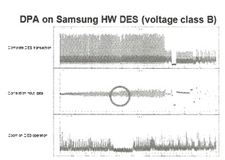

The below picture shows an analysis of the Samsung S3CCxxx DES-coprocessor by taking 50k traces of a medium sampling frequency to get an overview of the power profile of its DES calculation. Firstly one can look for correlations with the –known- input and output bytes. This helps to localize the signal of the DES-coprocessor (in circle) in the signal. The second measurement then concentrates on that DES-signal area and takes 400k traces of a higher sampling frequency (which in the end turned out to be completely unnecessary, and ordinary simple portable digital oscilloscope with 200MS/s that can be attached to a PC would have been quite enough). In the second measurement one should increase the voltage scale, as the most relevant information about the DES operation is in the gap with relatively low amplitude. It should be noted that this gap can be seen in a single trace, so software randomization efforts will not be effective as they can be undone with signal processing.

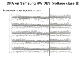

The most important step is to align the traces to the back of the gap, as then the DES-signal is neatly aligned at the end of the gap. The structure in below picture shows that the DES reveals itself already in just a single trace !!!
Even if countermeasures in software had been applied to strengthen the DES-operation they would not really have helped, as signal processing would have undone most of any randomization that could be added here.

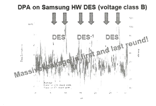

Show below is the 32-bit correlation with internal data generated during the DES calculation, when the secret key is known. So this is not an attack as such, but a study of the leakage characteristics The green curve shows the analysis of the last round of the DES, and the brown one is the same for the first round. In each we see 3 peaks, which at first is strange, but when taken together it become clear that you actually see a triple DES calculation, with the scheme encryption-decryption-encryption, all with the same key. The red arrows mark where the leakage is strongest.
The various select functions of the oscilloscope will all reveal a different picture. These will make clear that Samsung did try to introduce countermeasures mainly via a strong timing jitter but that these are very little efficient, as is very clearly visible in the “Hamming Weight Distance” select function, directly after the XOR.

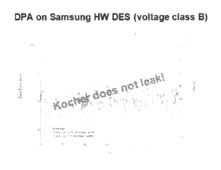

Interestingly, the standard “Kocher” select function does not reveal any signal, so obviously some countermeasures have been built for it.
The picture below is crated using the select function “direct” and the picture after that is showing the select function “Kocher” … simple conclusion is that one needs to look at all select functions, not just one of them !

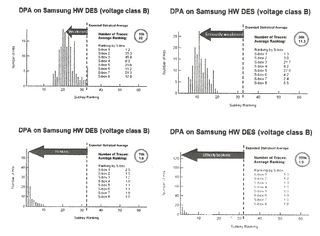

Shown in below-left picture is the distribution of the subkey ranking for the DES encryption. For a good DES, this distribution has to be centered around the statistical average of 32,5 but this is clearly not the case. It is centered around 22 – and this for as little as 10,000 traces taken ! The more the distribution moves to the left, the weaker the DES is.
For 6 S-boxes out of the 8 the correct subkey is already found within the 10 first subkeys, as shown in the below-right picture. Only S-boxes 3 and 5 are not quite there yet.
In the above-left picture the DES is broken – many tools have found the correct subkeys on the first place in the ranking (i.e. all the way at the left of this diagram). This is for 70k traces, which is close to nothing. Please note that most S-boxes even have their average ranking value already close to 1 now. The picture above-right is just for fun … now almost all tools point at the correct key.
