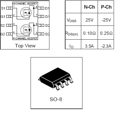

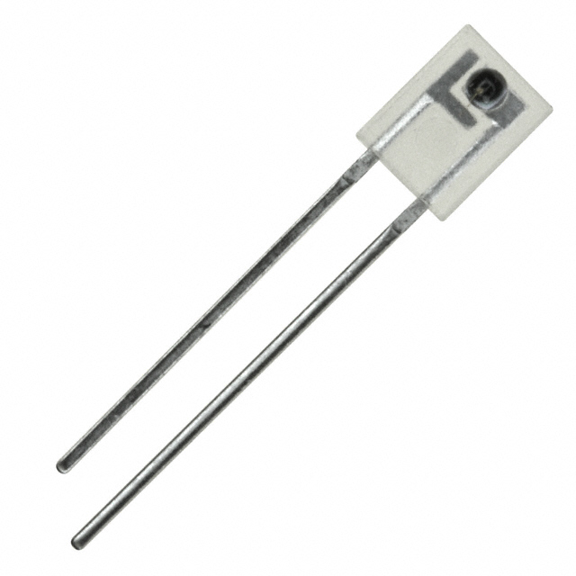

This might suit your complementary MOSFET IC if its FETs are logic-level types with low turn-on threshold voltages :
R1 value depends on the photodiode sensitivity. R3 provides hysteresis feedback. Either could be replaced by a trimmer for set-up.

NIce simple comparator wit power output.
The current from the photodiode may be a bit low to provide the necessary drive on a 200 kΩ load resistance. R1 may need to be increased.
