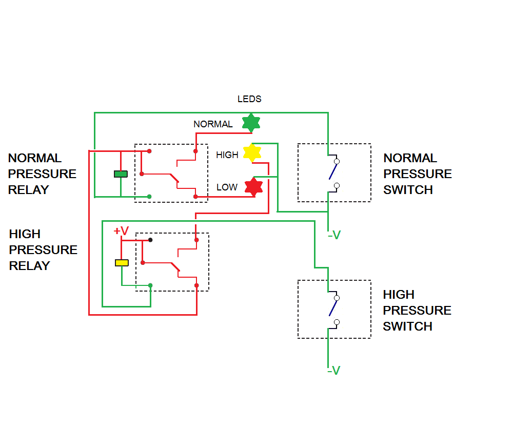

ive considered using three leds instead... red green and yellow.. when i first considered the idea.. and then i was going to use two pressure switches rather than a gauge..

i guess i could modify the above circuit and use comparators to switch in or out three resistance values to the existing gauge? ie.. volts out from a pressure transducer (0.5 to 4.5) set the switching points and take the gauge input wire to ground through the resistor values chosen... so as the values change the gauge changes position?

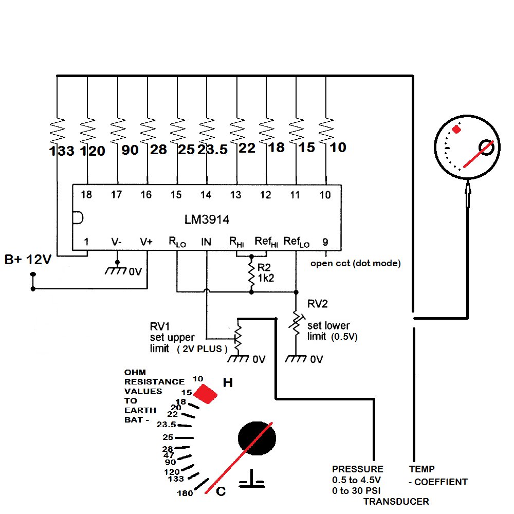

i think i might need a transistor interface... its cumbersome.. but i turn transistors on.. instead..? my problem is the meter needs reverse scaling, and so i use the resistor values to do that..
it saves me inverting the voltage output of the pressure sensor. i only need one IC. but if i cant
just use the output of the 3914... i can use transistors to do the switching..? i can set the current output of the 3914... to the base requirement of the 2N3906`s they turn on then one at a time and take the meter input on a reverse scale output.. dependent on the resistance value to ground.
My problem Alec_t is that the meter reads high when its input is low,,, and i cant change that.. its also reading the temp, and so i want to be able to simply switch its input between pressure and temp.. using a mechanical change over switch... therefore its input must be the same for both ... electrically.. and the temp sensor is resistance to ground,,, so thats what the pressure input must be... just different scaling to make it traverse full scale and read pressure instead.
linearity isnt a problem.. provided i can make the resistance values make the meter show me what i want to see.. in some sense. like low normal and high. i think ten different values for a max two volt input or thereabouts.. (i dont know exactly yet) is more than enough to do that.

this is where i am right now. i have the resistance values that deflect the gauge from low to high... i need help in deciding what RV1 and RV3 should be in value... equations are no good to me , i just need values etc..give me those as a sole means..:) my maths is crap and i fall over using calculators... i just want values in ohms.

and before i have to tell folks.. the max i want to see.. is about 15 or 16 psi... and why a need the upper limit to be around 2 to 2.5v thats the reason.. i need a "! window" to set the scale too..

To get the voltage range you want (~0.5V - ~2.5V say) :-
Remove RV1,
Drive pin 5 directly with the pressure gauge output,
Replace RV2 with ~800Ω (1k trimmer) and ~330Ω (500Ω trimmer) in series to ground,
Connect pin 4 (Rlo) to the junction of those two resistors (trimmers).
However, the circuit in dot mode doesn't do what you want, since whichever output of the LM3914 is active draws about 12mA current regardless of the value of its connected resistor (133Ω ...... 10Ω) :( .

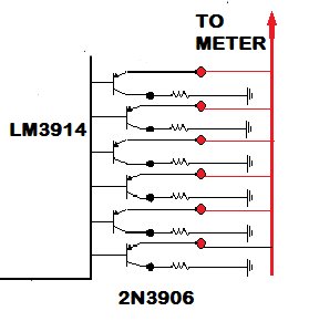

so.. it wont take the resistors to ground alec_t? can i use transistors to do it like 2N3906`s ? ie each output turning on a tranistor? its so close to being a good solution with minimal components...
