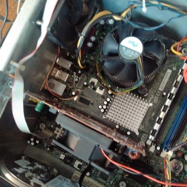

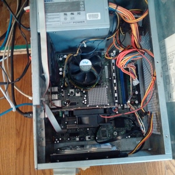

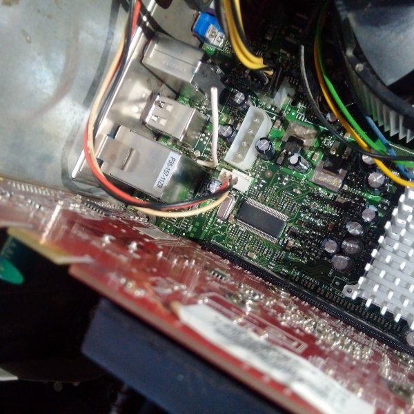

what does "motherboard fallen off it" mean? Does that mean the traces from the physical port failed somewhere? Here are some bad pics - the last one is the closest up one - the port is that device that has the p35 stamped on it.
I know there are adapters that plug into usb and adds ethernet through it - I suppose such an adapter would need a driver manually installed to work? or would they now auto install drivers when plugged in? I'm thinking of giving that a try if I can't fix the mobo, but for the adapter to work it would need to autoload the driver (kind of how a usb thumb drive autoloads its drivers now a days). Cause I can't get into the OS to manually load a driver
p35

My comment about the motherboard fallen off was based on the fact that you were asked for close up views of the actual motherboard and you showed us what I believe is a stock photo of the connector.
And as you rightfully point out the next images are pretty useless too.
