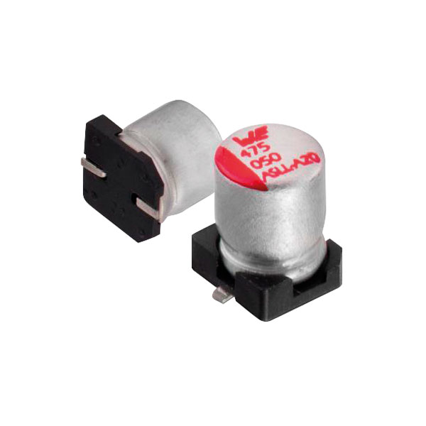

Hello everyone,
I recently came across the above, and tested it, and found out there is no playback, analog or digital. This unit looks mint! Inside as well. Can someone possibly steer me in the right direction. In record mode, everything "appears" fine, but no playback. Tested using headphones, no power amp. Thanks very much in advance.

Hi Stevo 1,
Lovely piece of 90s audio.
On the cassette mechanism there is a play back and record board. These commonly fail due to bad caps. If you are lucky, the board itself will be re-usable to simply replace the bad caps. If you are unlucky, the tracks will damaged due to leaking caps. But you can still fix it by using TH caps.

Hi Martin,
Haven't checked yet, are those caps SMD?? If yes, I don't have a hot air tool to deal with those.

Yes, they are SMD alum.
You might be lucky enough to be able to just get your iron on the tabs.

Hi Martin,
I changed all the caps in question. Cleaned the pcb's. Examined the pcb's. They "looked" ok. Can't read the schematic, it's so dense, very difficult to read. Didn't have 68uf caps that are on the Read/Write PCB, so I installed 100uf caps on the read/write PCB instead. Any thoughts??

Hi Martin,
I forgot to mention, same problem as before, no playback, analog AND digital. I didn't make that clear before, my apologies.
