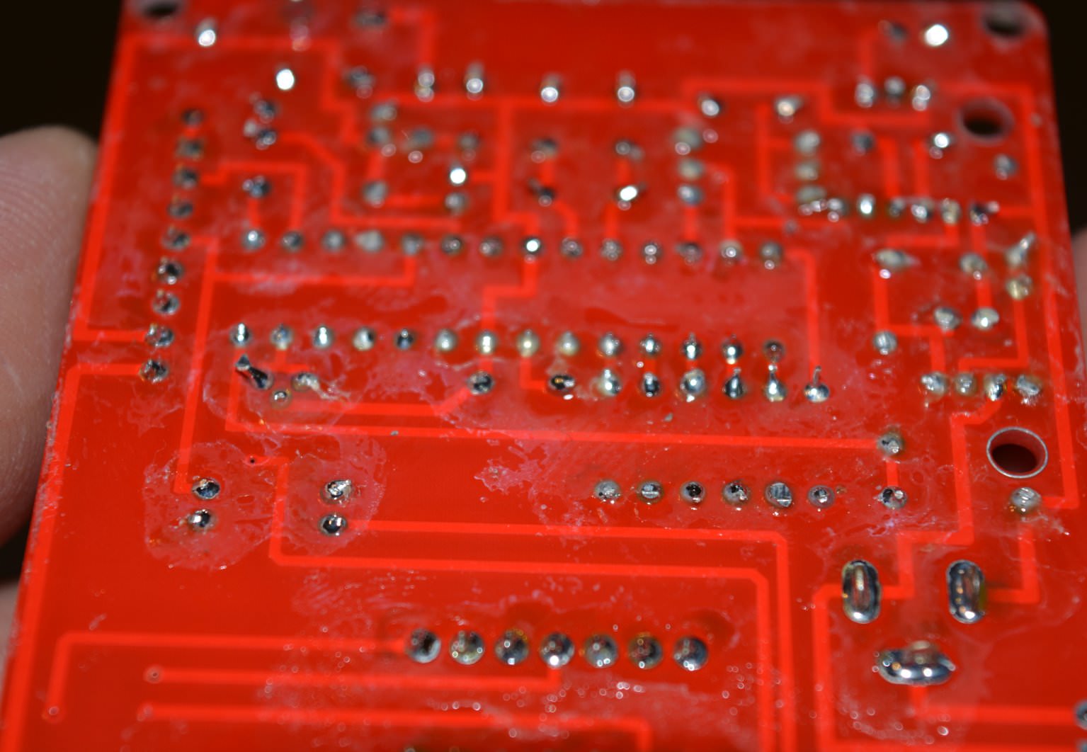

I started using liquid rosin flux by Aim and MG Chemical's a few years ago and I tried using alcohol like everyone was telling me to use when I read about what to use as a cleaner but I never found it did anything at all so I decided to look at places like Accessotronik but the prices they charge for a proper board cleaner is outrageous so I decided to give up on that approach.
I thought about the problem for a good while trying to think of stuff I could use and it came to me try and find a bug and tar remover and something designed to remove tree sap from car's,so I headed off to Canadian Tire and got looking around and find something in the automotive section I forget what it was called and I found this stuff called Krud Kutter in the section where the paint was and read that back label and I seen that it said it removes tree sap so I thought I would grab a bottle of it as well.
I found the Krud Kutter worked best and I'm still using it,I find the Krud Kutter is amazing stuff and is a great house hold cleaner and everything I have tried it on that it claims it works on it seems to always work every time.

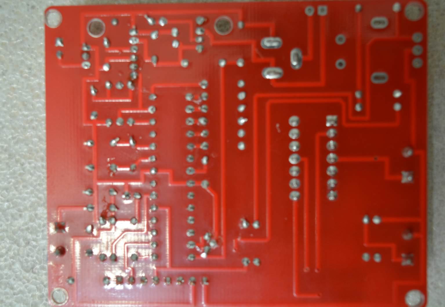

I mix the Krudd Kutter at 30 to 40% with water and most times I use it around 30 to 35% with water and you just it at room temperature and after I'm done doing a project I just dump it in my mixture and let it sit for an hour while I watch some boob tube and when I pick the board the board up out of the mixture most times it's broken the flux down so well that you can not see the flux at all on the board,I do not get up at all to swish the board I just set in the mixture and for get about it.
This is a transistor tester that I got from banggood a while ago and decided to build the other night,I just use a Q-tip to apply the flux and this board had a thick layer of flux on it in a few spot's.I put this board in the mixture before taking pictures but is was only in the mixture for about 2 or 3 minutes and I took it out to take the picture.
I sometimes let the board site for longer then an hour depending if the flux is not all dissolved,you can use the mixture many times.You can get Krud Kutter at Walmart Home Depot and most other big name stores.

The obvious question is whether this stuff can damage LEDs, or other sensitive components. If it evaporates, what does it leave behind? Is it either conductive, or will it leave an insulating film (neither is great).
If it is at all corrosive (and anything water-based can easily become corrosive) then you can get into trouble quickly, especially if anything has this plating.

I have been using this Krud Kutter for cleaning flux off of boards for years and I have not had any problems with it at all.
I have project's that I made at least 4 years ago and still work I have soaked many boards with LED's diodes capacitors of all sorts,the only thing I leave off are rotary switch's and LCD screens.
I checked with Rustoleum who bought out Krud Kutter and talked with someone in their lab and they said that the only thing it will attack is polystyrene.

Good to know.
I'm already concerned about things like those surface mount LEDs with the soft lenses.
Funny you mention polystyrene... Polystyrene caps are affected by alcohol and heat. Obviously not something you surface mount, but occasionally used where you need to clean the flux to eliminate conduction paths.
