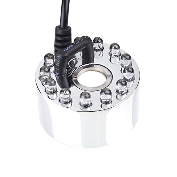

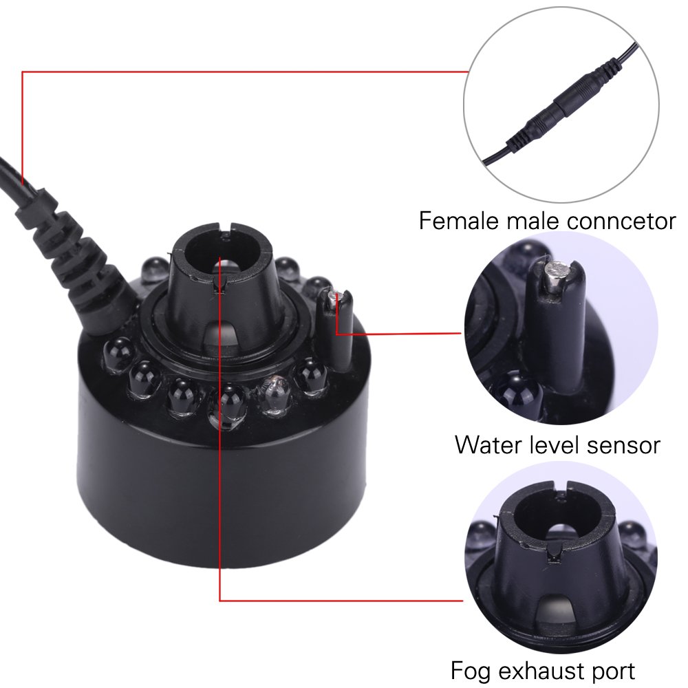

There is a weirdish water level sensor used in foggers. I never understood its workings after reading the patent, but may be of use for ..."detect when a water level has dropped below a certain level"...
That 'arch' in shrink tubing contains it, stops the fogger when water level drops to it. :
Newer ones use a different looking sensor :
