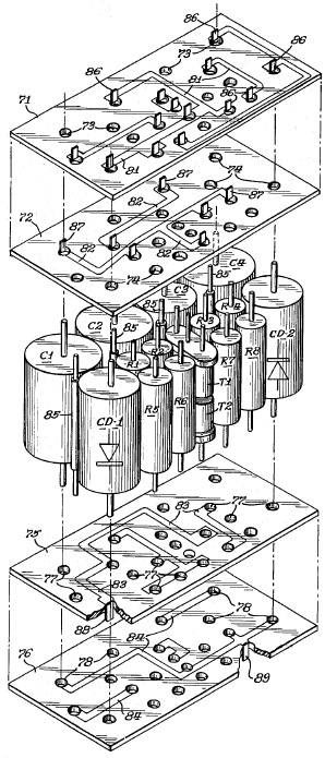

Sir Nobby999 . . . .
Considering that units thin PCB tops and bottoms and the construction manner, along with the encapsulating medium.
It resembles an ULTRA high reliability (from a mechanical shock and environmental aspects ) ”cord wood “ module of aerospace and military electronics of the 60’s ‘til the 70’s. Our units had flat nickel wire woven around between needed connections on the tops and bottoms of the PCB and being spot welded to the component leads.
It was a reliability situation / solution, instead of using soldered connections, as your unit certainly appears to be doing.
The encapsulate was the two part Resin-Hardener like marine builders use. With time onset, it took on a slight amber appearance. If at sea, yours may have whitened . . .or "greened" if abraded and algae infested.
Cordwood Construction :
73’s de Edd
