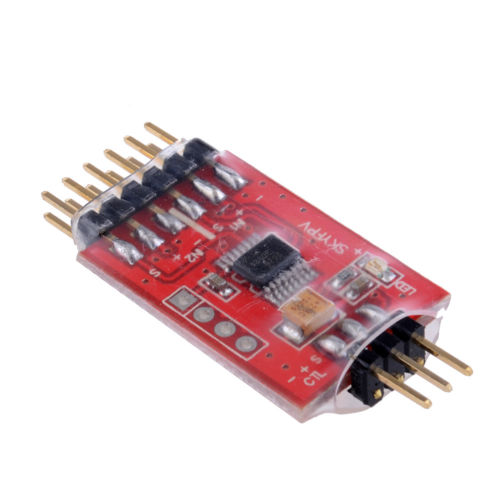

Hey all I am wondering how to go about switch from camera 1, 2 or 3 using this 3 Channel Video Switcher Module on ebay here.
Since there's only V+, V- and signal for the "switch" it looks to take a PWM but I am not quite sure if that's correct or not. If correct then how would I (in code) send that out for each camera to change?

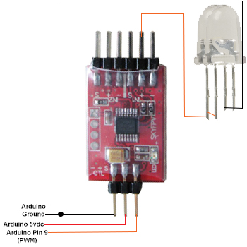

So I went ahead and powered up the FPV by hooking it up like so:
I'm not getting any voltage off that pin on the FPV. I even hooked up a volt meter and tested it without the LEDs attached to that pin and still had no reading.
Someone suggested looking at this post http://www.rcgroups.com/forums/showthread.php?t=1955631 but there so much code that I'm not sure what i need and what i don't need.
What could I be doing incorrectly?

What's the IC on there? And why have you connected an LED to it? It's a three-to-one video signal selector, right?

I hooked the leds up so i know what video IN is currently being triggered via the PWM. I can not find the IC's manual it uses nor have any help from the few that sell it on eBay.

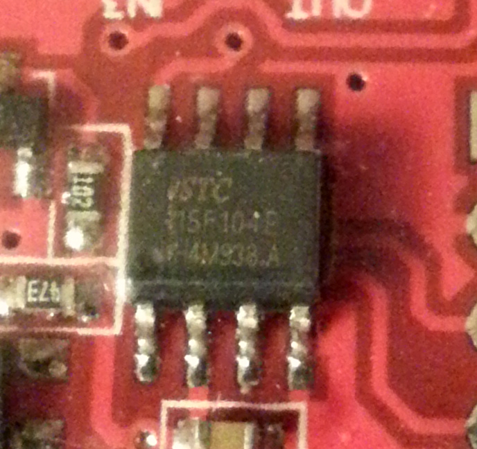

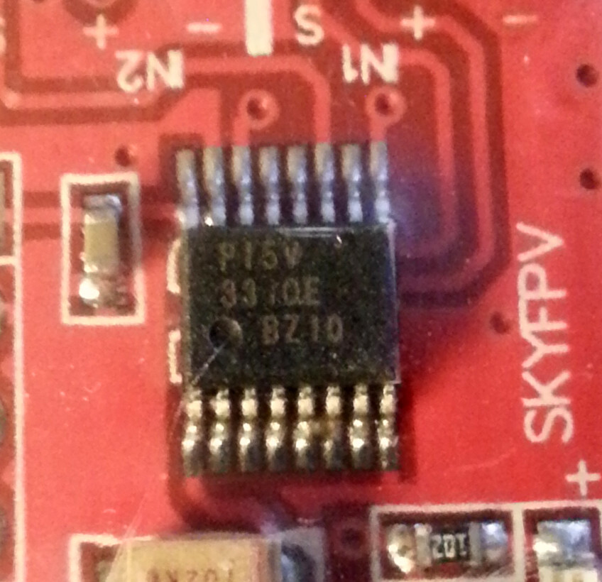

But you have a module there, do you? What are the markings on the IC?
StealthRT
Sep 4, 2010
147
Sep 4, 2010
147
One looks like it says P15V 331QE BZ10
While the other side has one that maybe says STC 15F104E F-4V938.A
