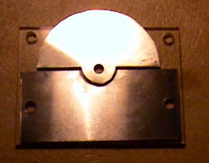

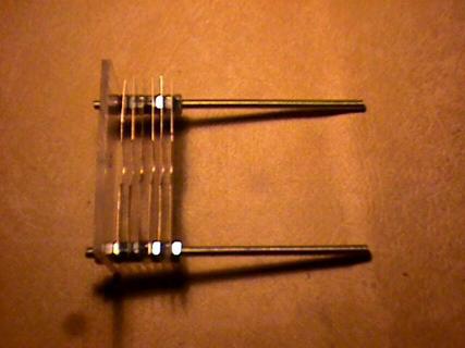

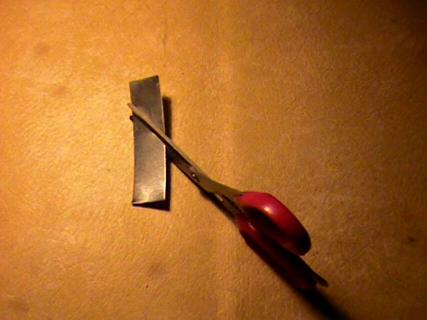

I was too excited to wait until the weekend, so I started building it this morning before school.
So far I have all of the plates cut out from the plastic cards and I have completed nailing holes through the first rotor plate and through the first stator plate.
I am using the semi circular plates as the stator plates and using the rectangular plates as the rotor plates. The rectangular plates pivot and are the adjustable ones. One of the nails on the bottom only secures the stators and the rotors can rotate freely out of that nail hole. Also, pulling the tuning nail in and out selects more or less rotors to be pivoted. I did not super glue on the aluminum foil yet; that is the last step.
Its probably better for you to see pictures off it to see the geometry than for me to explain it. Images attached.
Now I have to go to school now so that is all for today.

Keep in mind that the aluminum foil on each plate must make physical contact with the nails.
Chris

I will use tiny machine washers on the nails in between each plate to make the contact from nails to aluminum foil.
