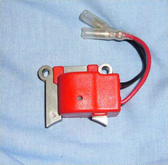

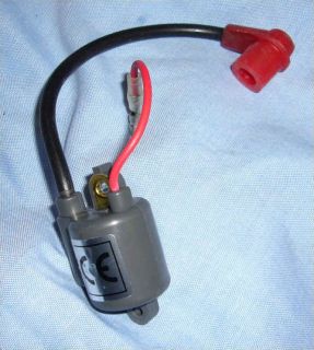

Thanks guys , starting to become clearer to me on how these things work.
Here's a picture of the engine and ignition system. Its a magneto driven CDI
Both coils are completely sealed
Ignition coil
Source coil
Set up
attachment.php
John,
I'll see if I can track down schematics for both of those coils.
Electronics is an unknown territory for me .
You mentioned the use of a voltage doubler at the lower voltage transformer .
Would it be worth increasing the voltage between both coils or am I looking at this the wrong way ?
The model engines you mentioned, would they be the Nitro engines ? as they use glow plugs over spark plugs to ignite a combusted charge.
Methanol needs a bigger spark to ignite inside a spark plug combustion engine. That's due to nothing more than the volume of methanol used ( 2-3 time more) per combustion cycle when compared to petrol.
These particular engines rev to 22000 rpm and the risk of methanol extinguishing the 'standard' spark is greatly increased .
Jay.

Nice boat. Have you come across the "Big Boat" site (aka Gompy)? I believe he is in the Netherlands. He specializes in racing boat ignitions. I used to have his site marked, but switched computers and OS recently and couldn't find it. Here is a link to a site that is more directed to model airplanes. Gompy has posted in it and given links to his own site there.
http://www.rcgroups.com/forums/showthread.php?t=1781959&highlight=diy+ignit&page=40
What you call ignition coil, I was calling spark coil. We are on the same page there. What you have is a fairly standard version in my area. The other device is a magneto, as you note. I do not see the typical capacitor used in CDI and am not familiar with magneto-driven CDI. The fellows in my area either seem to have straight magneto (as shown in your "set up" diagram) or CDI running off a 4.8 to 6 V battery. The rest of my comments about voltage doubler are related only to pure CDI. I have attached a schematic for a Chinese ignition that I reverse engineered a few years back. It had reliability problems. The voltage doubler is C4 plus the two diodes (For a description, see: http://en.wikipedia.org/wiki/Voltage_doubler ). The CDI capacitor is C5 (0.47 uF), which is a fairly typical size. It uses a typical Hall sensor for "points."
Sorry, I cannot be much help on the magneto ignition.
John

This is all of the info I can find on both standard coils - pictured in my previous post
Source coil / magneto
Core to red wire - infinite
Core to black wire 185Ω
Ignition coil
High Tension lead to red wire 2.1kΩ
Red wire to earth/core 0.1Ω
High Tension lead to black wire 2.1kΩ
Unfortunately , this is another language for me so, I have no clue as to what the difference is :D
