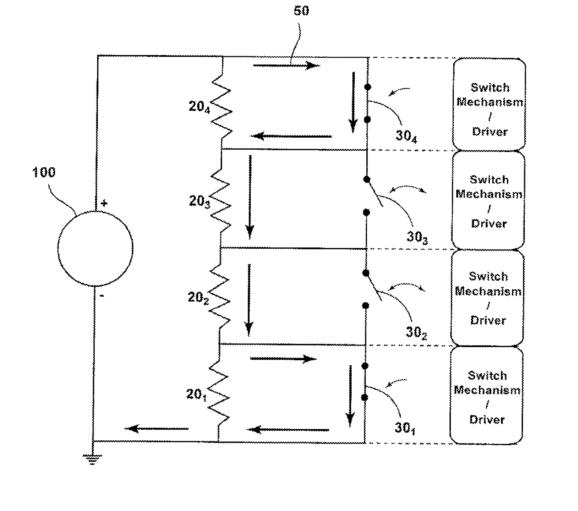

I really like the idea of using binary-weighted, series-connected resistors with a switch across each resistor. After some more research I discovered this method was actually awarded a patent in 2014 as a BCD or binary (both were mentioned in the claims) variable-resistance load! See diagram below copied from the referenced web site:
The patent also shows another image where the above circuit is stacked in series with similar circuits to create multiple decades of variable resistance. This is a novel example of current art? I don't think so.
We need to fire all the current patent examiners and hire a new crew with common sense. This is patent-able? Really?.:rolleyes:
