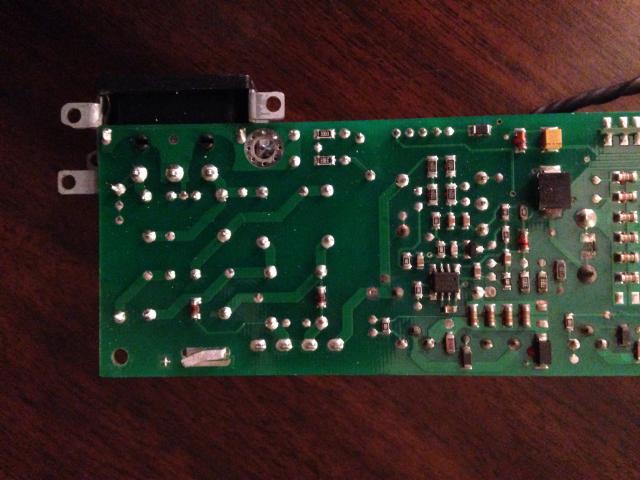

edit: Post photos of both sides of the board. Don't use a flash, and ensure the images are clear enough that we can read all the writing on the board.

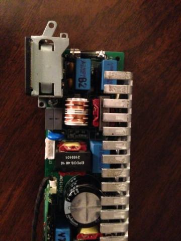

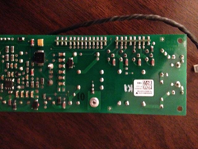

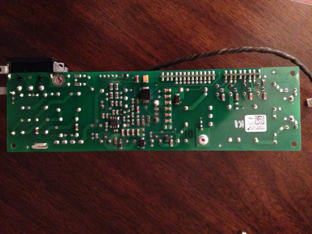

No problem, here you go. I cleaned the board with CRC Electronics cleaner and a soft toothbrush, which seemed to work pretty well.
Let me know if you want to see something in more detail. I assume it is a soft I/O since the projector will run the cooling fans for a time after power down to cool the bulb off.

For instant fuse failure, there are two common faults:
1) rectifier is short circuit
2) main switching transistor/mosfet is short circuit.
First read the resistance across the mains plug, second the resistance across the high voltage capacitor (make sure it's discharged first).
Naturally both of these measurements should be taken long after the power has been disconnected and with a good fuse installed.

That is suggestive of the switching mosfet having failed.
Can you show us what is on the heatsink closest to the mains power socket.
It's a long heatsink. I'd normally be expecting a single device here, but it looks like there's more here...

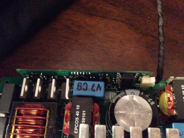

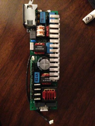

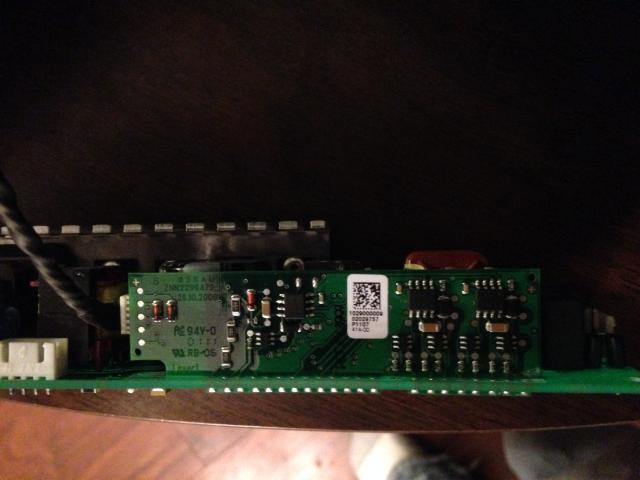

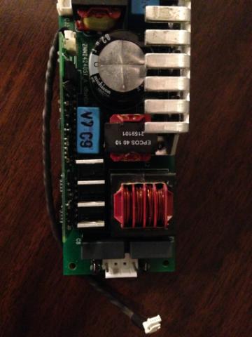

Sorry for the delay, got side tracked with another project. I have attached some pics below of the other heat sink and its surroundings, As usual just let me know if you need a better more clear view.
Thanks for all the help!

OK, it looks like that power supply has a power factor correction (PFC) stage, so it's really in three parts. Mains comes in through the bridge rectifier (marked GBU605) and is smoothed by a capacitor of a few µF, probably the rectangular blue component beneath the centre of the heatsink. Then there is the first stage, the PFC circuit, which uses the inductor next to that capacitor to boost the voltage, and feeds the large electrolytic that you identified earlier. The voltage across the large electrolytic then feeds the main switching circuit, which drives another transformer that provides the input-output isolation. There's a filter inductor with multiple windings, and it looks like four diodes - possibly connected as a bridge - and final smoothing, then the DC output comes out on a connector.
Can you please upload high-resolution, properly illuminated photos of both sides of the board, viewed from directly above the centre of the board, showing the whole board. See https://www.electronicspoint.com/threads/how-to-take-photos-of-circuit-boards.267883/
You said you measure a short circuit between the two pins of the mains plug. Most likely this means the bridge rectifier and/or the MOSFET in the PFC stage has lost the magic smoke. I suggest you remove the bridge rectifier (GBU605) by drilling out the rivet and desoldering the pins using a solder sucker. Once it's out of the board, measure resistance between the two middle pins, either way round. If it measures short, you'll need to replace it, but you may also need to replace other parts too. My guess is that the PFC MOSFET will be dead too.
We need to know more about the board. Steve asked you for the markings on all the components on the heatsink. You said the first one is GBU605; that's the bridge rectifier, and the others are BYV29X500. But I don't think that's right. There are four more devices on the big heatsink, along from the bridge rectifier. They can't all be BYV29X500s. We need to know what they are.
That information, plus some good photos, should give us more to work from.
