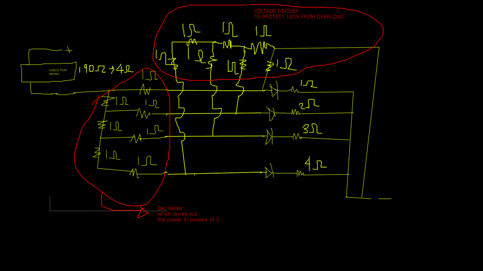

So you just want to light 1 led at 200 ohms, to 4 leds at 4 ohms right? And everything is working great other than just that?
Just grade the resistance off the output of the sensor- then the leds with the higher resistance will turn on later than the ones with less resistance.
If your getting complex and have an oscillator, you can actually put them through a capacitor instead of a resistor, and its probably safer for the led's, as well as wasting less energy.
Also just got another idea, if you make the output of the sensor control the frequency of the oscillator, that could work in ways too.
Dont blow up your water tank... but ive got a rough draft out for how id tackle the situation. If there isnt enough raw power out of the sensor you could add 1 transistor to the start of it. Note this circuit probably doesnt work its not tested at all, it would be a fluke in hell if this was right first time, its just a rough idea.
