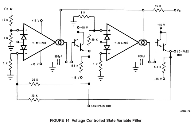

I wanted to build a quick and not to hi-fi voltage controlled notch filter so I went for the LM13700 state variable filter. By summing up lopass and hipass you usually should get a notch filter. So here's the schematic:
Actually the hipass should be found at the non-inverting input of the second half of the LM13700, right? Thing is, there's nothing really useful comming out, am I overseeing something? Where's my hipass? :(
Thanks for any advice!!
