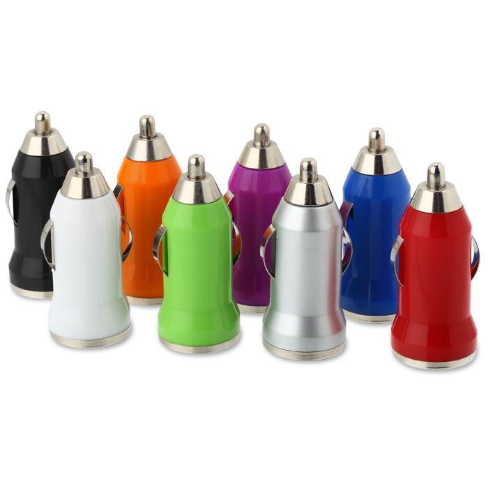

Is there any reason why you can't just use one of these car USB chargers or the circuit board within? Get one with two 1A outputs or better if you like.

The circuit board on those can be wired to the 12v PSU? Sounds like a good solution for dualling.
If it has a 1a output (supplying more) is it like wiring and gauges? IE People often overwire as a common practice instead of using mininal 26 gauge they may use a 24 gauge in that application.
I have a couple laying around to test with.

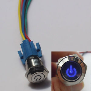

Not sure what you mean by ripple, I want it hooked up to a 16mm switch that then when pressed latches and turns on the device that is wired into the 12v psu via lm2596.
